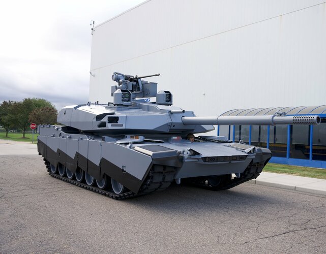

Regarding the XM360E1, I do recall it having a longer barrel than the current M256A1 and higher chamber pressure as well. As it is a lighter weapon than the Rheinmetall 120 mm L/55, it may be able to use existing Abrams stabilization system. That said, the model does appear to use the base XM360, so I guess we'll see.
Anybody else thinking the empty seat at the front next to the driver is for an optional 4th crew member?
Where are you getting the idea that there is an empty seat? It's three seats with two roof hatches on the front deck, apparently.
E1 did allow increased chamber pressure but I think the barrel length was unchanged.
But, there is no reason they could not go back to a somewhat longer barrel, given that the whole turret was reworked from scratch. That might also jibe with the return of the muzzle brake -- this might be an XM360E2 combining elements of both.
The latest video in this thread does show the new turret with gun firing. Someone with more spare time could probably measure the barrel length off the video.

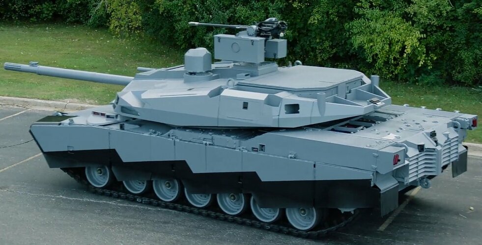

The driver was moved to the left from his centerline position and there is now a 2nd hatch on his right. This seams to me to be the 4th crew position. I assume the crew inside the hull was reduced from 3 to 2 due to the autoloader.
The turret is unmanned. All three crewmembers sit in the hull, side by side.
Man, this demonstrator gave no consideration for all the SL-3. :rolleyes:
Where would tankers throw all their shit, like main packs, jerry cans, tow bar stowage, spare track segments and roadwheels, etc.? Where's muh bustle rack...
I know, I'm being tongue-in-cheek here.
Just a thought here, as an ex tank crew person. How much overhang of the crew compartment is there and when the hatches are obstructed, how are the crew going to, you know, bail?
The engine compartment appears to be higher than before, with the bustle correspondingly higher. (This is the main disadvantage of the ACE, it's taller and boxier than a turbine.) The front of the turret appears to be further back than on the M1. I would suspect you should be able to bail out of all hatches regardless of turret position.
Also, I think there are clearly 3 hatches, with the side ones opening by sliding to the sides, and the center one opening by sliding forwards. In the video above, the side ones are open and the center one is closed.
you might be right there.
2 men crew and the tank would need same treatment as a Fighter jet.
It's just TTB's layout. It probably has identical stations.
Two man crew isn't practical without greater advances in automation that have yet to materialize. Carmel is supposed to do something similar but it's basically a bolt-on sensor kit for tanks.
Tanks require three levels of situational awareness (sector, close, far) while a fighter jet only requires two (close, far).
This is leaving aside the operator-maintainer tasks that are handled by a tank crew, as well the necessity of local security of a laager. A radical solution would be integrated tank-infantry mechanized platoons, where the infantry are trained as tankers, but that's still too futuristic.

There's storage bins on the sides of the turret, similar to GDLS's MPF, and it looks like there's an open basket on the back.

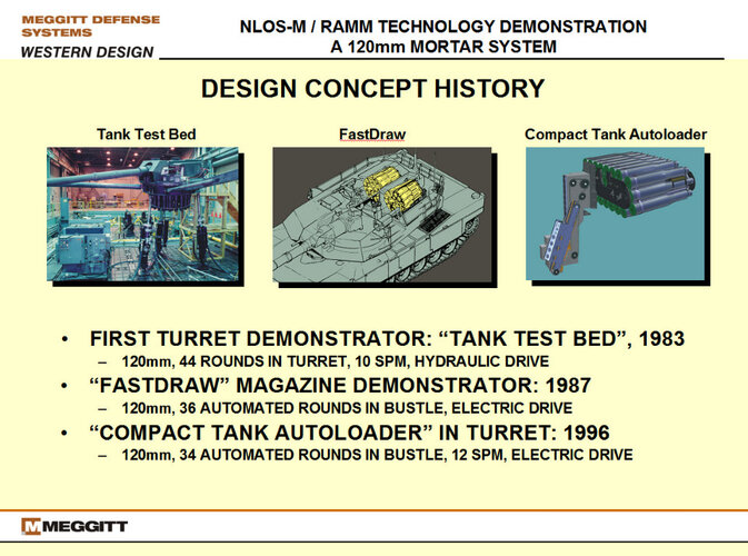

Does ammunition for the main gun only come from the bustle? Or is there also a TTB type carousel too?
The former most likely. She has a pretty sizable bustle and they can just use Meggit Defense’s autoloader designs
You're probably right. I was hoping it would be TTB type so the turret could be smaller/lighter for additional weight reduction.
I wonder if they went with the in-arm suspension that the MPF has, that would free up internal space and shave quite a few tons off at the same time.
TTB Carousel is probably a non-starter, additionally the current state of tank development has demonstrated that there's a limit to how small you can make a turret and still handle the sensors, comms, and APS a modern tank requires.
It interesting how high the commander 50 cal is. It should have a true 360 arc of fire, unlike with the KF-51 where some angles are obscured by the hull, remote sensors or the loitering munition launcher.
Note that it's now a 30mm (30x113). They could swap back to a .50-cal or even a .50/40mm GL combo but the 30mm is gaining a lot of ground thanks to the new HE proximity fuzed ammo for C-UAS and counter-defilade.
Good luck knocking down a swarm with a chain gun. Need something more like this but with a lot more power:
Well, that's not going on a tank anytime soon. But then, swarming UAS don't seem to be happening all that soon either.
Either way, this is still more useful than the commander's .50-caliber MG.
I can see they filled in the empty holes in the turret with weapons and equipment
The RWS with the 30mm looks like it it is higher than it has to be. I'm also perplexed as to why the coax MG is higher above the main gun than on today's Abrams.
