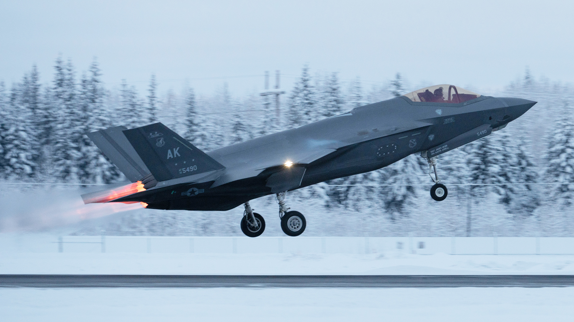

The pilot experienced an “inflight malfunction” but was able to eject from the aircraft, Col. Paul Townsend, commander of the 354th Fighter Wing, told a news conference. The plane crashed during the landing phase of the flight at Eielson Air Force Base, he said.

And ejected pilot is seen apparently lower than the crashing plane with the chute canopy already deployed...
I wonder if the plane did not escape its pilot after a hard touchdown.
