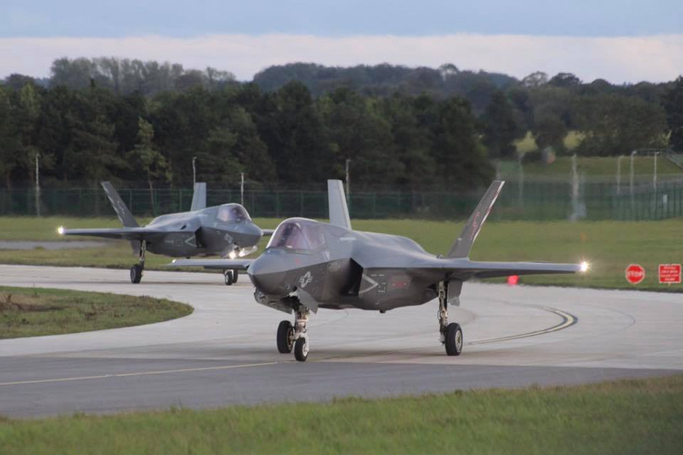

some F-35Cs in the US Navy, and recently one of the British F-35s has colored insignias on the tail.
I wonder if it affects RCS any?
When VMFA-211 Wake Island Avengers turned up at RAF Marham 3 years ago, part of work up as they be joining 617 (B) Squadron as a first joint embarking on HMS Qe, the boss's a/c had wee bit of colour so here are my photos below from September 2020 as they taxiied past us.
cheers

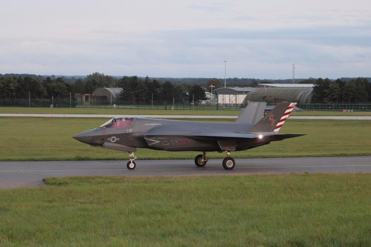

finally more pics.
looks like its largely the same as the other F-35s except for the high viz flag and roundel.
think these are temporary like the UK one, or more permanent like the Danish ones?

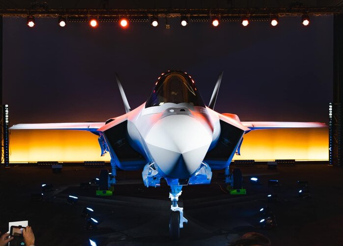

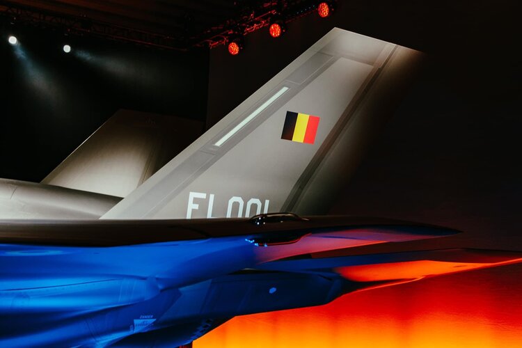

More from Belgian Air Component FB page
Nice PR pictures but did they say anything about when it will fly?
If I’m not mistaken this is a TR-3 bird so will be added to the growing list of aircraft parked at Fort Worth waiting for software release… must be 50+ aircraft by now and heading towards >100 right? I would love to see a satellite or drone pic of the apron packed with grounded F-35s...
