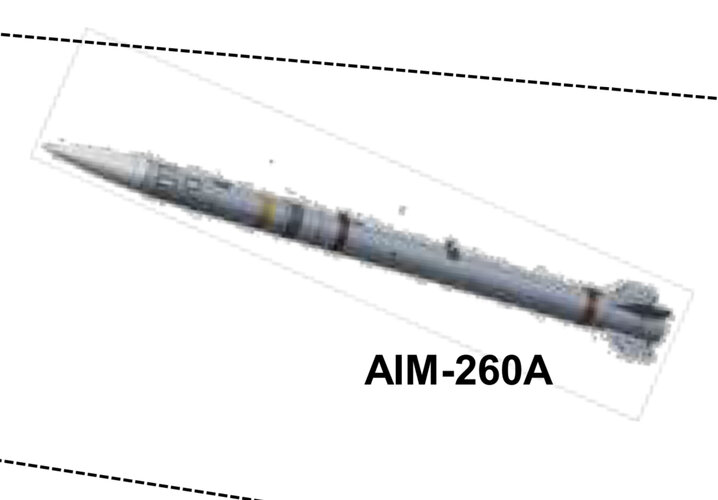

Missiles shot at high alt are generally extremely hard to spot with commercial cameras and the smoke plumes could be mistaken for another vehicle. On the ground I'd imagine there will be lots of security. And @Shusui drew a good-enough illustration of the basic OML.

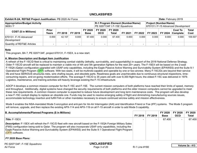

Any idea what OFP stands for in this context?
From chatGPT
In the context of fighter jets, "OFP" stands for Operational Flight Program. It refers to the software that controls the avionics, flight systems, weapons systems, and other critical functions of the aircraft. The OFP is essentially the software configuration that defines how the aircraft operates during its mission. It includes things like:
  1. Flight control systems (e.g., autopilot, stability augmentation).
  2. Weapon systems (e.g., targeting, missile control, and launch sequencing).
  3. Avionics (navigation, radar, sensors).
  4. Communication systems.
The OFP is periodically updated or modified to improve the aircraft’s performance, add new capabilities, fix bugs, or integrate new hardware or software technologies. It's a critical part of ensuring the jet remains mission-ready and capable in various combat or operational scenarios.
An example of the F-16 OFP, https://www.robins.af.mil/News/Arti...software-innovations-makes-f-16-more-capable/

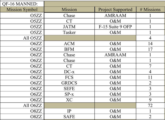

  • 0207134F_180.pdf
So AIM-260 aerodynamic is AIM-120D without front fin?. I feel like high altitude agility would be pretty bad
