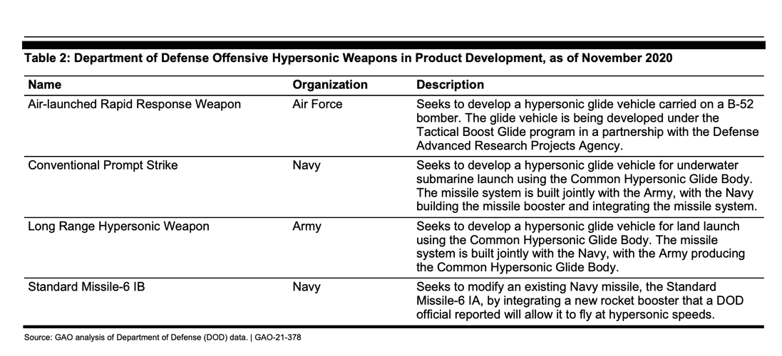

The USNs hypersonic program is CPS using the SWERVE glider. It’s possible they will update the glider some time in the future but I suspect the two stage booster arrangement and diameter are fixed, so I can’t see AGM-183 being adopted. It would suffer a massive performance loss being launched from the surface.
1. S-400 is located in Latakia, The strikes were carried around in Damascus. Are those areas super close or very far apart?S-400 is so effective at stopping Tomahawk that the US Navy had no problem avoiding it entirely through decent route planning and up-to-date EOOB information.
I don't recall the Chinese or Russians having figured out a bulletproof solution to Tomahawk, so they seem to be in the same bucket as they were in the '80's. The only difference is the US stopped deploying nuclear warheads with Tomahawk, but it isn't going to suddenly start putting atomic bombs in AGM-183 either. If it needs to it can easily rearm the Tomahawks with nukes anyway, although that is rather implausible considering it has superior delivery systems nowadays.
2. I could have just ended it on the 1st point but one sides claims all hit their target, the other states 71 out of 103 were intercepted. I would carry this conversation on to another thread but with these kinds of topics moderators and an admin will more than likely close it.
3. If you still believe the air defense is that ineffective Iran would have already had it and I dont think there would be a TAI-TFX thread in this forum either![]()
Not only to piss you off and maybe users on this thread but in terms of having anything similar to AGM-183 I heard they have claimed they had successful interceptions in Kasputin Yar with missiles that are suppose to simulate specifically AGM-183 and Deep Strike with S-400, S-350, Buk-M3s. https://topwar.ru/164483-neozvuchen...to-imitirovali-rakety-misheni-favorit-rm.html Sadly I dont know the maneuverability of how many Gs the Yars, kinzhal or iskander can pull in comparison to the AGM-183. But atleast they didnt say anything so far on intercepting hypersonic air to ground missile like GZUR to simulate HAWC.Really, the same thing they were planning to do in the Norwegian Sea in the early 1980's. Certainly much has changed since then, but nothing fundamental. Slightly faster missiles don't make much a difference in the end, they just mean you need bigger AEW. And the Russians and Chinese don't appear to have anything comparable to AGM-183 outside of the Strategic Rocket Forces/2nd Artillery Corps, with their newest potential non-strategic weapon being a warmed over Onyx (Brahmos).
edit: Okay so C-HGB is only Army and Navy, unless the Air Force just sorta tagged along.
