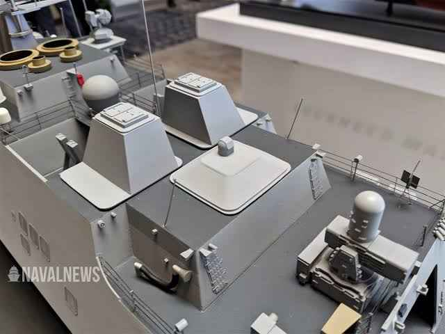

can't see this being a desirable long-term solution. It seems to blank the helicopter capability completely, for starters.
Going to go out on a limb here and suggest the VLS module they proposed a few years back is the only way to add VLS cells while retaining aviation capabilities. Realistically you don't need more than 4-8 cells for quadpacked ESSMs, so I think it's a feasible solution. 1734057463077.png
Going to go out on a limb here and suggest the VLS module they proposed a few years back is the only way to add VLS cells while retaining aviation capabilities. Realistically you don't need more than 4-8 cells for quadpacked ESSMs, so I think it's a feasible solution. View attachment 752173
That particular install is Tactical Length, which is fine for self-defense, but comes up short for the strike missiles they are talking about in the MK 70.
View: https://youtu.be/vPftdH2ZWAw?si=_F9Dp4ZC5yTgD8Uv&t=252
That is a lot of weight up high in the ship, holy crap! Tac or Strike length Mk41s on top of the hangar!
Can't believe there's no space to stick those into the NSM bays...
I can't see this being a desirable long-term solution. It seems to blank the helicopter capability completely, for starters.
Just to cause Chinese planners to always account for the idea of any ship is a ship with long range missiles if conflict break out but I doubt there's any serious plan to keep these containers on there operationally speaking

There’s no new information in here. The LCSs are here to stay, and they’ll stay until the early 2040s. They’re very useful ships.
Yep, it would likely be the containers would be prepositioned and strapped on for specific missions rather than just left there for long periods of time.
