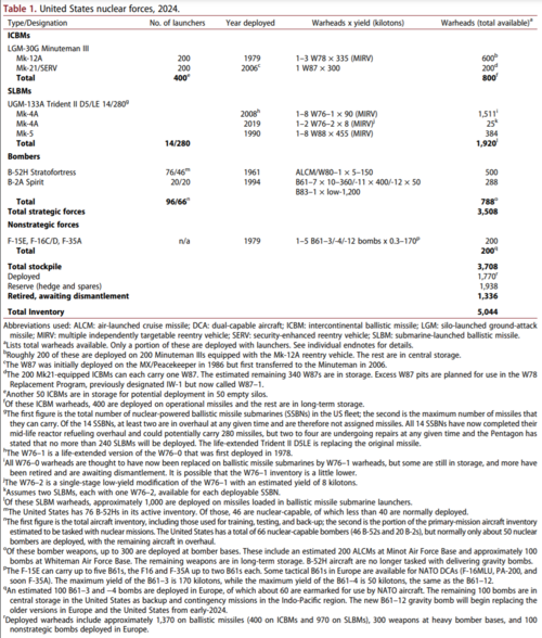

In the case of the MMIII, Mk12s were equipped with W62s (170kt) and Mk12As got the W78s (335kt). So it's customary for the first to have no letter - the RV equivalent of a warhead -0.
Just something small I noticed in the details but W87-1 is described as a W78 replacement (note d), not a W87-0 replacement, so this may well imply something W78-sized physically but with W87-1-like yield, which is good because it suggests MIRVs. Also 5o ICBMs in storage - are they MMIIIs or Peacekeepeers?
The Peacekeepers are in storage, I don't think any MMIIIs are.
:oops: Didn't realise that, I suspected MMIIIs.
-1 and -0 use the same RV body so same size. But yes MIRVed
The original -1 did, but is this the same thing? To replace the W78 for a 3xMIRV load (with the same bus area), like the notes say, it would have to be a Mk12A-sized RV. I guess time will tell.
Same RV, different payload inside.

From Chuck Hansen's nuke book:
"Nominal W-87yield is 300 kilotons; yield can be increased to 475 kilotons by adding a sleeve of enriched uranium-235 around the secondary: the oralloy adds considerably to total yield when it fissions after the secondary is compressed and ignited by its "sparkplug". The 300 kiloton W-87 uses much less fissionable and fusionable materials than the W-78 with its 335 kiloton yield."
Yet the W78 is smaller. Just thinking, the Mk21A must have at least some differences with the Mk21 to have required flight testing.

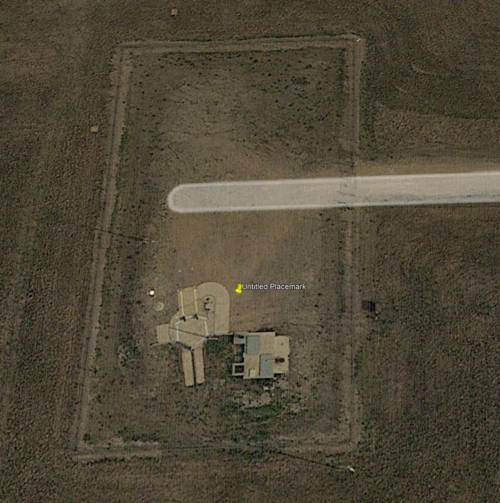

The cost does include an upgrade of the entire infrastructure though. Peacekeeper cost $195m per missile in 2023 dollars without any upgrade to the infrastructure. Although a question must be posed, as with the Nimrod MRA4, is it actually cheaper to upgrade the existing silos, or just start anew?
Without considering land costs I'd bet it would be cheaper to build new silos. That being said I believe most of the land in the area has been sold off and the Federal government would have to buy back a large amount of land to build new silos - and if that's true I bet it is cheaper to upgrade the existing silos by a decent amount.
From what I've seen the space taken up per silo is very little, but I guess there are 450 of them. I just think that a significant amount of the cost is probably stripping out and replacing old crap. New silos would also allow them to build them stronger.

It's all the infrastructure that needs to be redone. When the program was originally bid out, redoing all the comms lines between silos and command centers etc wasn't part of the program of record, and the silos were to be overhauled.
  • Then it turned out that those comms lines are a rat's nest of splices added over 70 years, to the point that it's better (edit) cheaper to lay all-new lines with splice boxes built in to handle the exercise systems than it is to try to fix all the bad splices in the lines.
  • And it turned out that the silos themselves are in much worse material condition than USAF had led the bidders to believe, to the point that it's likely to be cheaper to build new silos from scratch than try to fix everything wrong with the old ones.

Yeah, I think most of the cost is actually due to Nimrod MRA4-type issues of having to deal with old infrastructure. I hope someone has seriously considered whether just starting from scratch might be cheaper. Land-wise, it looks like there's enough room to just start constructing a new silo at the opposite side of the existing plot. Start next to the 50 empty silos first, so that you're always working next to empty silos.

Were new silos actually part of the contract, or just new wiring, refubishment etc.? I think it was just a refurb:
I think it's cheaper to build new silos on the existing plots at this rate.
It was supposed to be a refurbishment, but the silos turned out to be in such bad shape it's cheaper to build new.
Same with the wiring connecting silos and launch control etc.
