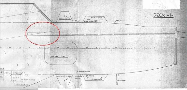

For what they're worth I've made some crude calculations using the plan view drawing of Clemenceau in Jordan's book.
According to them the distance between the bow (not including the bridle catcher) and the forward lift is 229ft 10in and the length of the catapult is 188ft 9in.
Hermes had 1x175ft & 1x151ft BS.4 rated at 50,000lb at 94 knots.
According to Freidman in British Carrier Aviation Hermes was completed with a pair of 151ft stroke BS.4 catapults.
I've assumed that one was lengthened to 175ft as part of her 1964-66 refit. Have I assumed correctly? Or was Friedman wrong? His books aren't immune from typographic errors.
For what it's worth the photographs of Hermes taken before and after the refit along with the line drawings in contemporary editions of Jane's Fighting Ships suggest that I have assumed correctly.

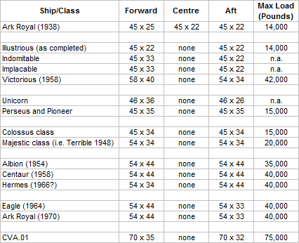

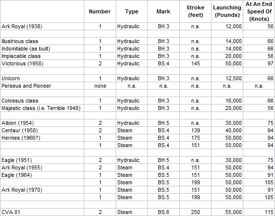

Re the discussions on the capacities of various catapults.
I compiled this from the copy of British Aircraft Carriers: Design, Development and Service Histories by David Hobbs on Scribd.
NB it didn't say what the launching capacities of the two BS.4s that Ark Royal was completed with. So I used the figures for Hermes which seem to be their capacities after her 1964-66 refit.
Hobbs explicitly says that both of her catapults could launch 50,000 at an end speed of 94 knots. Viz:-
2 x BS.4, port 175ft stroke; starboard 151ft stroke; both 50,000lb at 94 knots.

Ark completed with 2x BS4 (151ft stroke). Hobbs "British Carrier Aviation" & Cooper "Farnborough & the Fleet Air Arm"
Her 1967-70 refit saw these upgraded to BS5 with forward one at 151ft long and waist at 199ft long. Hobbs again.
Hermes BS4 1959 2xBS4 151ft stroke as per Friedman. 1964-66 refit BS4 175ft port side and 151ft starboard side. Hobbs & Cooper again plus McCart "HMS Hermes 1959-1989".
Victorious 2xBS4 of 145ft stroke. Hobbs & Cooper
Eagle 1959-64 refit 2xBS5. 151ft stroke forward, 199ft waist. Hobbs
Confusingly Cooper refers to the cats in Ark & Eagle as still being BS4 despite their being noted elsewhere as BS5. But the lengths all agree.

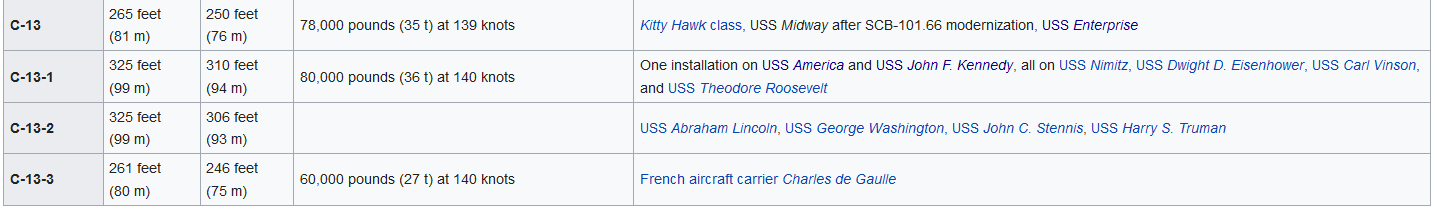

Fun to think a rebuild Hermes ended with slightly longer cats than the brand new Clemenceaus. It also explains why both had some difficulties operating Phantoms safely and essentially never did it.
And indeed Wikipedia has the varied breeds of C-13s, with their respective carriers.

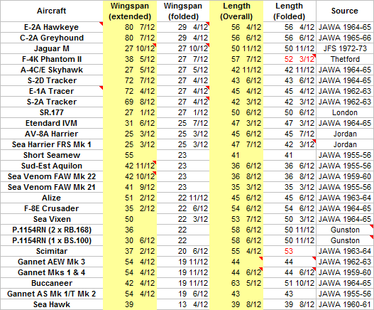

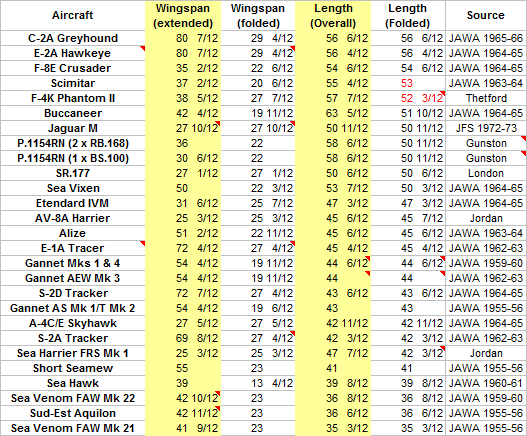

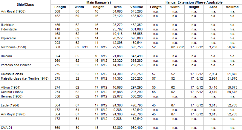

These are the sizes and maximum lifting capacities from the same source which was the copy of British Aircraft Carriers: Design, Development and Service Histories by David Hobbs on Scribd.

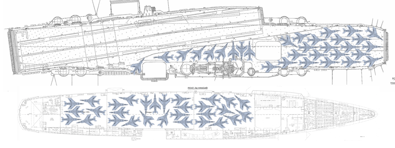

Here's a side-by-side view of both carriers in Shipbucket scale (2px = 1ft), with F-8 Crusaders. Hermes has 33 aircraft spots vs. 47 for Clemenceau.
Practical capacity (per USN standards) would be 75-80% of this number, so roughly 26 F-8s on Hermes vs. 36 on Clemeanceau. Then subtract 4-6 for AEW/ASW... so 20 fast jets on Hermes vs. 30 on Clemenceau.
So Hermes has roughly 2/3rds the air wing capacity as Clemenceau. However in other key respects Hermes is actually much worse (e.g. max alpha strike size and ability to keep a catapult clear for alert launches)... the problem is Hermes' shallow angled deck and lack of a waist catapult, which really eat into free deck parking. Plus the rather small hangar.
So my idea of 4 Centaurs upgraded to Hermes standard may not be so great after all...

Link to Post 90 about catapults.
Link to Post 99 about lift dimensions and their maximum loads.
These are the hangar dimensions according to the copy of British Aircraft Carriers: Design, Development and Service Histories by David Hobbs on Scribd. The dimensions are in feet and inches.
Edit 26.05.22: See the comments of @EwenS in Post 112 about the lower hangar of Indomitable.
Clems clearly were closer in size from Hermes than Audacious.
Clemenceau vs. Hermes makes for an interesting comparison.
Re what you wrote about the hangars.
John Jordan on Page 23 of An Illustrated Guide to Modern Naval Aviation and Aircraft Carriers wrote that Clemenceau's hangar dimensions were:
499ft useable length x 72-79ft width x an overhead clearance of 23ft.​
This compares extremely well to Hermes whose hangar dimensions from the table in post 101 were:
356 length x 62ft width x 17ft 6in overhead clearance.​
499ft x 72ft = a hangar area of 35,928 feet which is 50% greater than Hermes (22,072 square feet) and that multiplied by 23ft produces a volume of 826,344 cubic feet more than double Hermes (386,260 cubic feet).
The extra 10 to 17 feet of hangar width was more useful than the extra 143 feet of length because it made two and three abreast stowage (according to the type) easier.
For what it's worth the lifts are about the same size and Clemenceau's maximum load is 10% greater:
Hermes 54ft x 34ft deck-edge forward and 54ft x 44ft centre-line aft, both maximum load 40,000lbs.​
Clemenceau 56ft x 43ft centre-line forward and 52ft x 36ft deck-edge aft, both maximum load 44,000lbs.​
It looks like Clemenceau could operate Buccaneers, which have smaller folded dimensions than an Etendard.

From the tables that I recently posted:
Buccaneer dimensions
Extended - 63ft 5in x 42ft 4in​
Folded - 51ft 10in x 19ft 11in​
Etendard IVM dimensions
Extended 47ft 3in x 31ft 6in​
Folded 47ft 3in x 25ft 7in​
A folded Buccaneer is 10% longer than an Etendard, but the Buccaneer's folded wingspan is 20% less than an Etendard.
That doesn't make any difference on Hermes because it's hangars are 62ft wide which means both types can only be stowed two abreast.
However, on Clemenceau her 72-79ft wide hangars are just too narrow for three Etendards abreast (unless they can do it by staggering them) but it can easily take three Buccaneers abreast.

The source also says that both ships had two 45ft x 34ft centre-line lifts which are the same dimensions as when they were completed, but had presumably been strengthened to take 30,000lb aircraft, ditto the flight deck and the arrester gear.

The lifts are about 10ft longer and 10ft wider in addition to being able to take heavier aircraft.

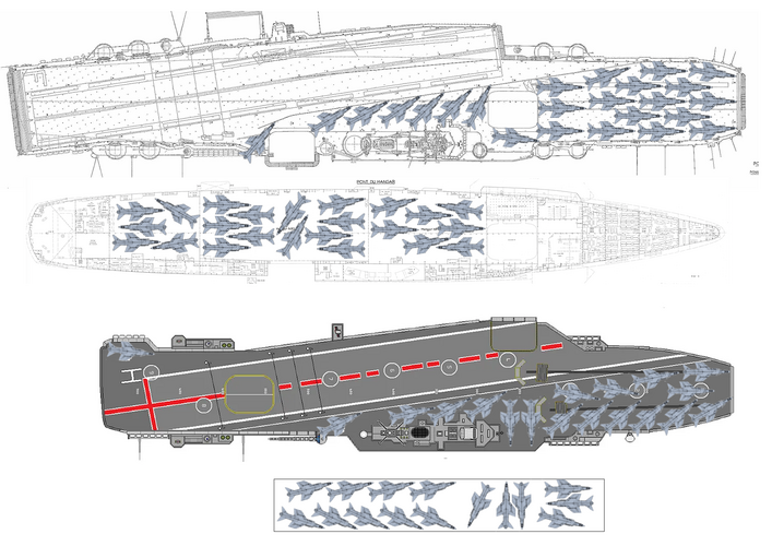

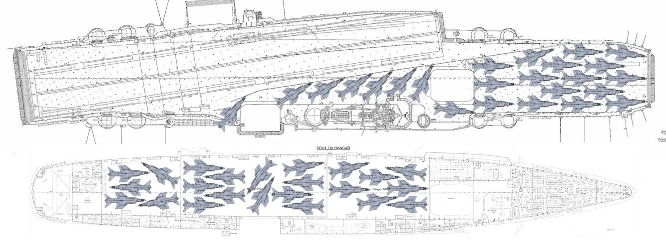

@NOMISYRRUC Aircraft spotting is a funny thing… it’s not all about square footage (folded length x width). It also matters how well you can stagger aircraft, which is more about wing area and geometry.
For example, the Etendard on paper is the same size as an F-8 Crusader and 10% bigger than an A-7 Corsair (due to its wide folded span), but in real life it staggers very compactly. As a result you can park 20% more Etendards than F-8s and 10% more than A-7s within the same space.
Here’s an example - Clemenceau with 61 Etendards vs. 47 F-8 Crusaders. Admittedly this is a paper exercise and operational spotting doesn’t allow for so much staggering so the benefit will be somewhat less.
One correction to the above. Indomitable’s lower hangar was 208ft long as per the drawing in Hobbs not as noted in the table in that book. (You need a magnifying glass!)
This thread on another site has a discussion about it explaining why.

Minas Gerais actually had a longer catapult... made possible by the forward lift having been moved 8 feet to starboard.
Similarly, 25 De Mayo had an even longer catapult, made possible by angling closer to the port edge of the flight deck st the aft the of the track.
Both also bridle-catchers (25 de Mayo's was longer), which allows the catapult track to extend further forward than the standard BS-4 installation on the Colossus/Majestic carriers. Note that HMAS Melbourne received a bridle-catcher in 1971, which lengthened the catapult track & piston forward by 9 feet.
This is the info I have collected from various sources:
Minas Gerais (as modified in the Netherlands):
Manufacturer: MacTaggart-Scott, model C-3; stroke 130', track length (unknown); capacity 30,000lb @ 110 knots
25 de Mayo (after major repair & modernization in the Netherlands for sale to Argentina):
Manufacturer: Mitchell-Brown, model BS-4; stroke 174', track length 199'; capacity 30,000lb @ 114 knots
Notes: BS-4 #9 ie. 9th produced; capacity operationally 20,300lbs @ 121.5kt
(seems low, but apparently this catapult was optimized for fast launch cycles, with a low steam pressure to avoid depleting the carrier’s limited steam supply, and the long track was a way to offset the low steam pressure)

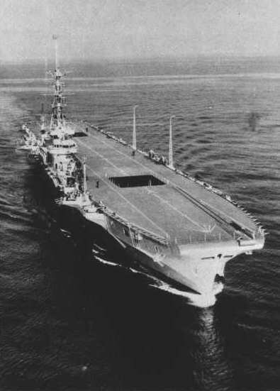

Minas Gerais (as HMS Vengeance) before modernization - note the fore elevator is on the centerline:
Minas Gerais after modernization - note the fore elevator is starboard of the centerline:
The problem with staggering is that movement of the aircraft is very much a rigid sequential order.
There's much less scope to change your mind and access a particular aircraft out of the sequence.
Looking at the drawing on Scribd didn't work with a magnifying glass and when I tried to enlarge using the computer the text became blurred. However, I measured the hangars with a ruler and the lower hangar was half the length of the upper hangar.
And as you wrote in the article that you provided the link to Friedman (in Table 7-9 on Page 154) does indeed say it was 208 x 62 x 16 and for what it's worth so does Indomitable's article on on the Armoured Carriers website.
To be fair to David Hobbs it's a mistake that's been made by others:
  • Conway's 1922-47 (Page 20) also says 168ft x 62 x 16ft.
  • So does Chesneau (Page 103).
  • And D.K. Brown in the Design and Construction of British Warships 1939-39 does too, though I can't give a page reference because it comes from handwritten notes that didn't include the page number.
The table on Page 154 of Friedman also says that the pp length of Implacable and Implacable was 690 feet and not the 673 feet that I quoted from Conway's earlier in the thread.

And have you acquired any information on the catapults on Clemenceau and Foch?
The entry on VdM in Jane's Fighting Ships 1982-83 says that her 1950s modernisation cost 25 million Guilders. Does anyone know what that was in Pounds?
