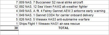

According to Page 50 of Eagle's commissioning book for 1964-66 the Sea Vixen was temporarily increased from 12 to 15 aircraft.
A heavy CWP programme, an increase in aircraft complement from 12 to 15, the annual circus known euphemistically as Air Day, a few days leave, and we braced ourselves for the briny once again.
899 NAS was the first Sea Vixen FAW.2 squadron and the extra aircraft may have been embarked for trials and training.

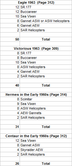

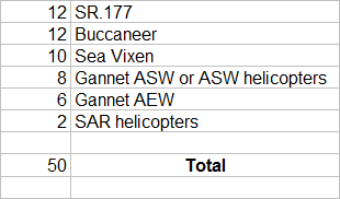

For what its worth Norman Friedman wrote on Page 312 of British Carrier Aviation that in October 1956 the projected air group for Eagle in 1963 was 50 aircraft as follows:
That's 34 fixed-wing combat aircraft 16 AEW, ASW and SAR aircraft. That's 2 more than the 14 in the air groups for Centaur, Hermes and Victorious in 1963 as projected in October 1956, which have 4 AEW aircraft instead of 6.

These are the air groups for Eagle, Victorious, Hermes and Centaur for the early 1960s at projected in October 1956 from Friedman.
He didn't say what the planned air group of Ark Royal was. This could have been because Eagle's refit to Standard A was intended to last from 1959 to 1962 and Ark Royal would follow. Therefore, Ark Royal would have been refitting in 1963.
However, Eagle's refit actually took from 1959 to 1964 at a much higher cost than estimated. Therefore, Ark Royal's Standard A refit was cancelled in favour of building a new ship. Except the new ship was cancelled in February 1966 and Ark Royal's big refit was reinstated except to Standard B instead of Standard A, i.e. no Type 984 radar and ADA. According to Hobbs its cost of £32.5 million was half the cost of building a CVA.01.
Victorious could carry nearly a third more aircraft than Hermes, which in turn carried 5 more aircraft than Centaur. On the other hand placing the forward lift at the deck edge allowed Hermes be fitted with longer steam catapults. In fact they were the same length as Ark Royals in 1955 and the bow catapult of Eagle after her 1959-64 refit.
That's 19 fighters and strike aircraft instead of the 17 projected for the early 1960s in October 1966. It's also 11 AEW, ASW and SAR aircraft instead of the 14 projected for the early 1960s in October 1956. That's a net reduction of one aircraft. But it doesn't include the detachment of 4 Buccaneers from 803 NAS that operated on the ship from August 1968 to April 1969. That increased her air group to a total of 34 aircraft.

From Friedman. That extra 20ft or so in length did not generate significantly more hull volume. The percentages of volume below the upper deck in Victorious and the lower hangar deck in Implacable (both 37ft above the keel) were respectively 23% & 29%. But the more powerful 4 shaft machinery arrangement in Implacable was actually a disadvantage when the Admiralty came to look at her reconstruction. It occupied 40% of the underwater hull volume compared with 30% in Victorious. So there was less volume for the larger crew required to run that extra machinery before we start thinking about all the new additions.
As for her speed I doubt that she would still have been capable of 32 knots after reconstruction. Her original rated speed of 32.5 knots was only possible at the relatively light displacement of 29,000 tons with a clean hull. At deep displacement it was 31.5 knots.
The plan called for the upper hangar to become the new hangar. That involved raising the flight deck 9ft to allow for the extra hangar height (14ft to 17.5ft) plus a gallery deck to provide much of the additional space required by these reconstructions. That meant blistering the hull to regain the lost stability. That would have added 15ft to her hull beam. Her weight would have increased to 36,000 tons ie beyond the original designed deep displacement. All of that would have cost speed. While new boilers were to be fitted, that was more about meeting the endurance requirements through increased efficiency, rather than about speed. By way of contrast Victorious' beam increased by only 8 ft in her reconstruction and her weight to 35,500 tons for her to maintain 31 knots. Neither ship would have had her machinery power increased beyond that originally installed.
Whether or not it would have been possible to fit a waist catapult would depend on whether or not a side lift would have been fitted (discussions about that were ongoing when everything got cancelled). Implacable's greater hull depth compared to Victorious might have allowed it. Ark Royal lost her side lift when she got the waist catapult. But she already had 2 centreline lifts. Hermes by comparison only had a single centreline lift and the side lift.
