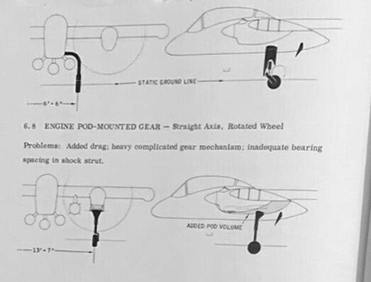

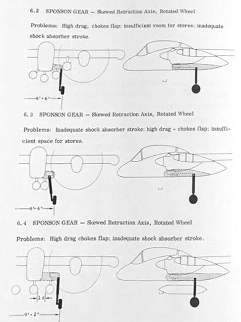

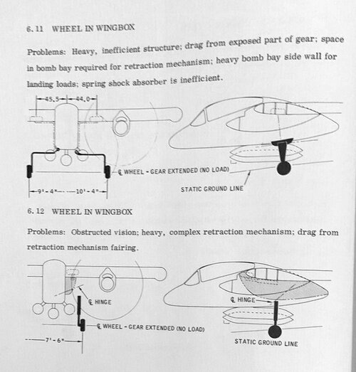

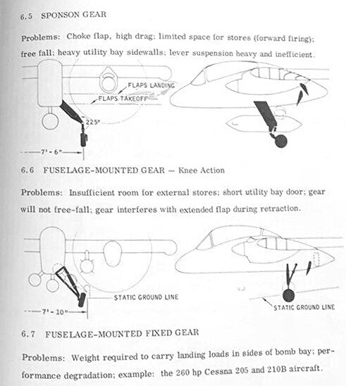

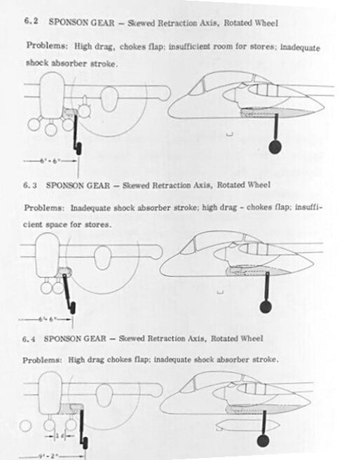

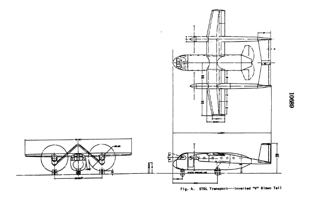

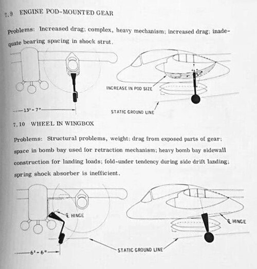

From NASA, Vertical and Short Takeoff and Landing V/STOL Aircraft 1964,
Martin.

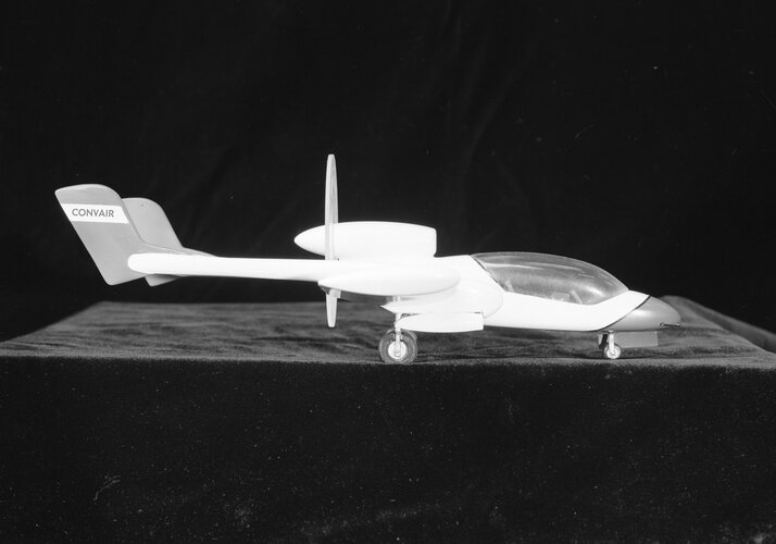

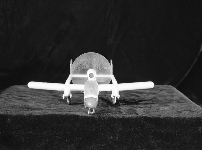

Unbuit Transport/Cargo Broncos.
Some sources mention versions proposed to the US Navy with 2 or 4 turbofans, but I have never seen a drawing of the same ones.
The one I made a model of back in the early 1970s from the drawings had 4 turboprops on a 50 foot span wing for super-STOL operation for the Navy. The side-by-side seating 2 engine variant was designed to carry mail and packages between small airports not served by air at the time. The cockpit featured a 1970-era phone between the seats so pilots could be re-routed in the air. It used the OV-10A wing and engines but had the fuselage shown in some of your drawings. I built a model of it, too, as I recall.

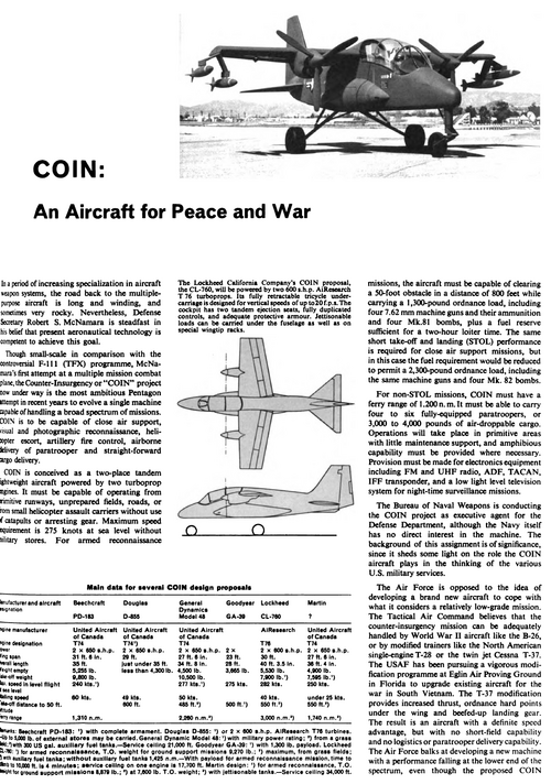

The Bronco began with a specification approved by the U.S. Navy, Air Force and Army, a "tri-service" specification called "LARA" (the Light Armed Reconnaissance Aircraft), issued at the end of 1963. LARA was based on a perceived need for a new type of "jungle fighting" versatile light attack and observation aircraft. Existing aircraft (the O-1 Bird Dog and O-2 Skymaster) were perceived as obsolescent, with too small a cargo capacity for this flexible role.
The specification called for a twin-engined, two-man aircraft that could carry at least 2,400 lb (1,100 kg) of cargo, six paratroops or stretchers, and be stressed for +8 and -3 Gs (basic aerobatic ability). It also had to be launchable from an aircraft carrier, fly at least 350 mph (560 km/h), take off in 800 feet (240 m) and convert to an amphibian.
Various armament had to be carried, including four 7.62 mm machine guns with 2,000 rounds, and external weapons including a 20 mm gun pod and Sidewinder missiles.
Eleven proposals were submitted, and seven made the first cut: the Beech PD 183, Douglas D.855, General Dynamics/Convair Model 48 Charger, the Helio 1320, the Lockheed CL-760, a Martin design and the North American/Rockwell NA300.
In August 1964, the NA300 was selected. A contract for seven prototype aircraft was issued in October 1964.

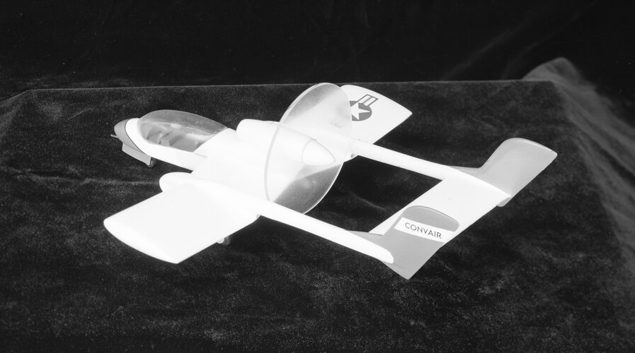

General Dynamics/Convair protested the decision and built a prototype of the Model 48 Charger anyway, which first flew on November 29, 1964. This was also a twin-boom aircraft that had a broadly similar layout to the Bronco. The Charger, while capable of outperforming the OV-10 in some respects, crashed on October 19, 1965 after 196 test flights. Convair dropped out of contention.
From Wikipedia

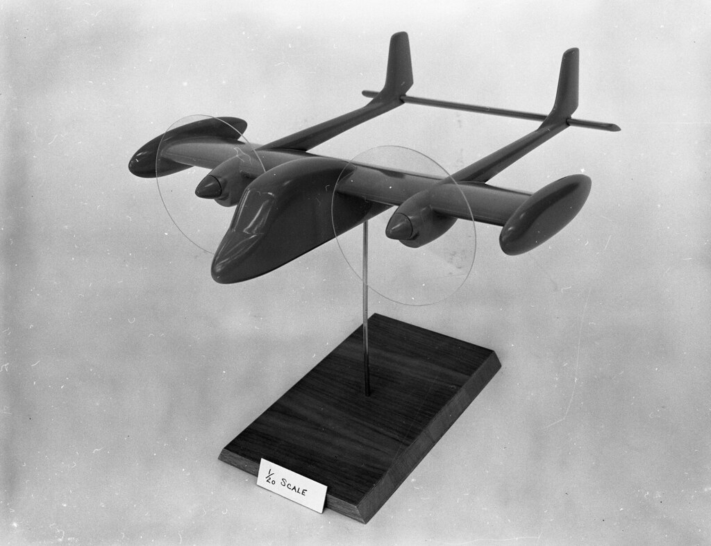

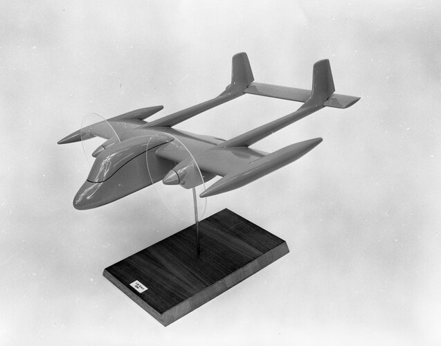

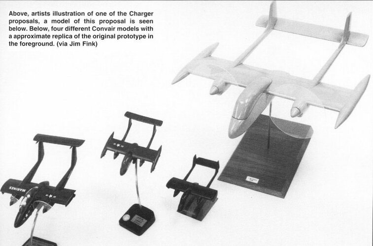

When I started at North American Rockwell in 1971 I inherited a solid display model of a Bronco predecessor. The plaque on the support base identified it as LARA and it was painted in overall Army olive drab with yellow lettering similar to the paint job seen on OV-1s at the time. Cockpit seating was side-by-side with Heinkel-style nose shaping including asymmetric glazing, the larger portion being on the right side for the observer. I've never seen published photos or drawings of it but I did have a marketing brochure that I had to leave there when I left North American Rockwell a few years later. I just tried uploading a screenshot of the cockpit but got a security error. I traced one of the marketing drawings of the cockpit for use in another design for a different mission. Anyway, I've had a feeling for decades that this missing Army LARA configuration was an important step in Bronco design evolution, at least in-house, and may have been associated with the trial-service COIN project.
From Wikipedia
So Grey Ghost, the question that begs to be asked, do you still have this intreging display model??
So Grey Ghost, the question I need to ask, do you still have this intreging display model??
Regards
Pioneer
Or at least a picture!!!!!

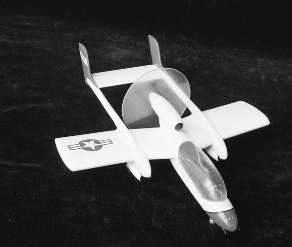

An interesting feature of this Martin proposal with its inverted v tail is the use of exhaust gases for tail plane steering augmentation at low flight speeds. The turboprop's exhaust gases are rooted within the tailbooms and exhausted over the rudders. It was developed and patented by Hans Multhopp, chief designer of the Ta-183, during his time at Martin.
Yes Basil,
Blown flaps were all the rage for heavily-loaded jets back during the 1960s. Bristol Buccaneer and Lockheed F-104 both had blown flaps to improve landing performance.
Blown control surfaces were needed to compensate for the short tail moment arm on LARA.
A disadvantage is that blowing hot air through tail booms vastly increases their heat signature at the same time that heat-seeking missiles were becoming fashionable.
The concept is being revived for the next generation of stealthy fighters to help reduce radar signature of aileron hinges.
These are fair points but spreading the heat out and mixing across the tailplane/v-tail is probably better than the concentrated twin exhausts.
I think the bigger reason for the blowing of the tail was the high downward pitching moment due to large and highly deflected flaps for the so called deflected thrust lift concept that most LARA competitors employed to overcome the small wing area and short field requirements. The biggest concern I suspect was engine out failure on approach. It works well, as long as the engines keep working.

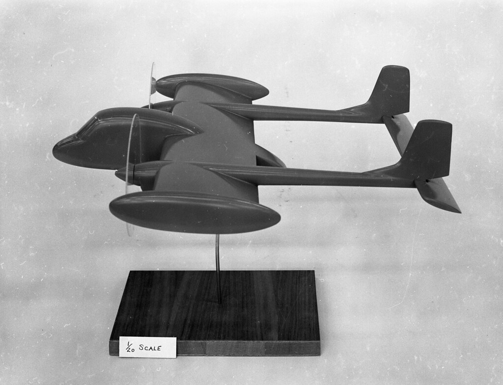

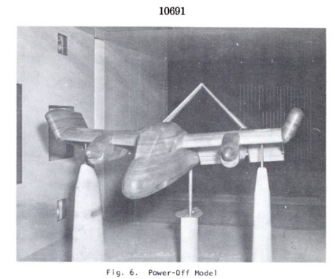

Bill S said:

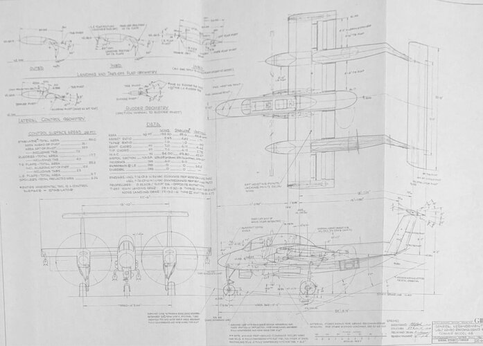

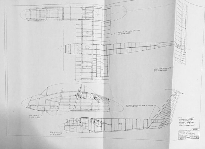

Vought V-458 Low Speed Wind Tunnel Model Drawings
I am pretty sure this design was considered for the LARA,
as the drawing is from 2/63 and in the title block of some
of the detail drawings has "COIN aircraft".
Source: Vought History Collection
bill
Just to add to my previous post. The V-458 got as far as wind tunnel testing, still looking to see if a formal proposal was assembled or submitted. Vought photos
bill
Just to follow up on this, a retired engineer told me that management stopped Vought's participation in the COIN contest. NARA II has records on the Vought COIN, however those files are still classified, least last time I checked. One other interesting side note on the V-458, the later V-473 used the same design for a proposal to the US Army for a Surveillance and Target Acquisition Aircraft almost two years later in 1964 with a tilt wing V/STOL capability.

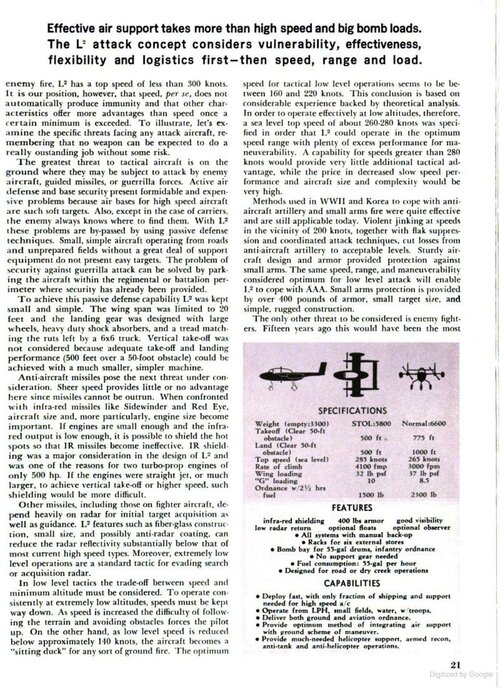

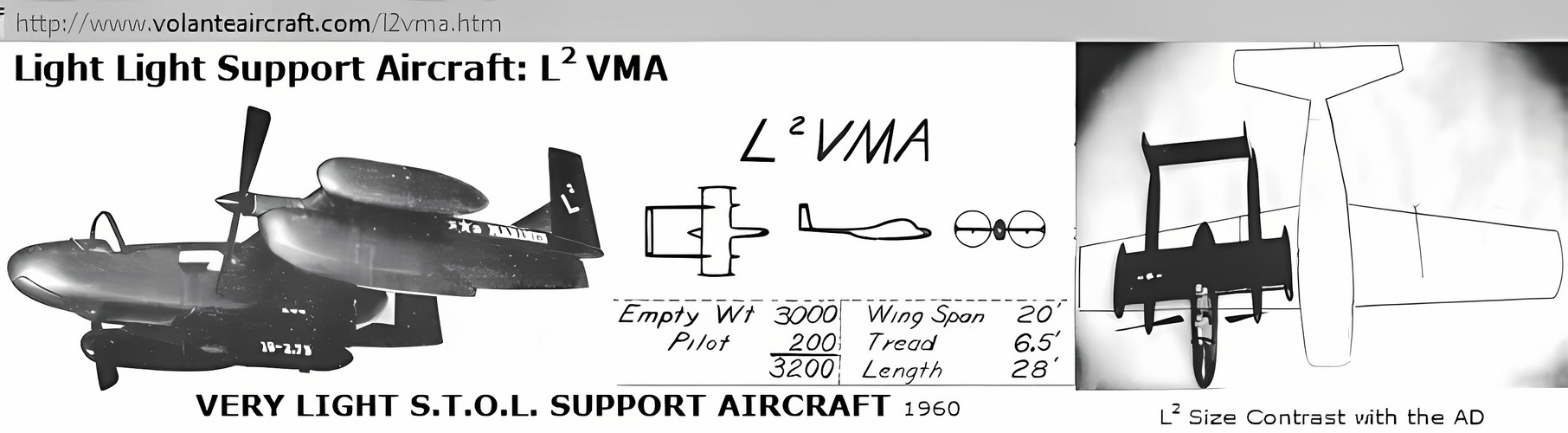

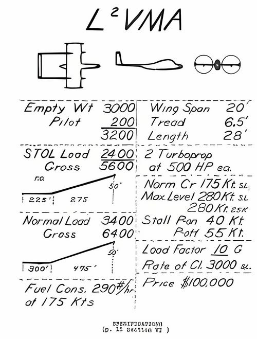

I'm posting the full 1960 article by Majors Rice & Beckett here for posterity.
LIGHT LIGHT SUPPORT AIRCRAFT (L2 VMA)
THE NEED, CONCEPT OF OPERATION AND GENERAL SPECIFICATIONS FOR A VERY LIGHT S.T.O.L. SUPPORT AIRCRAFT
MAJ W.H. BECKETT, MAG-15
MAJ K.P. RICE, AIRFMFPAC
PREFACE

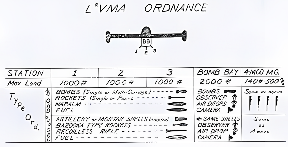

3. Ordnance.
a. General.
It is not considered necessary or desirable to carry an extremely heavy ordnance load. Accuracy, proper tactics and weapons matched to targets will provide effective firepower as distinguished from blind, destructive force. Provision is made for a capability against relatively soft, fleeting targets like troops and unarmored vehicles; for hard point targets like tanks; and for larger targets like bridges and bunkers. The aircraft will be able to carry sufficient ordnance to execute an interdiction type strike effectively and still provide a good armed reconnaissance capability on the same sortie.
b. Guns.
The most effective all around weapon will be the four 7.6mm machine guns (or similar type weapons) which are effective against
troops, unarmored vehicles and helicopters. Strafing is not limited by safe separation requirements and targets can be hit with precision without risking damage to nearby personnel or property. There would be no particular problem in mounting 20 mm guns, if necessary. However, unless developments like the German anti-tank 20 mm prove effective, the heavier guns would probably not be desirable.
c. Hard Point Targets.
The problem with hard, point targets like tanks is to get close enough for a direct hit without getting caught by blast effect. The easiest weapon to use would be the 106 recoilless rifle because of its accuracy, effectiveness and minimum blast problem. However, these weapons are quite heavy, provide only one shot and haven’t as yet been used from aircraft. Aircraft rockets like Zuni or the 2.75 while not as accurate are considerably lighter. The bazookas or the newer LAW could be fired at a close enough range to score hits and still avoid excessive blast effects. Another possibility is dive bombing with small bombs. The Germans had some success with this approach in World War II on the Russian Front. Guided missiles like Bullpup or some of the smaller types could be carried, if necessary.
d. Miscellaneous Targets.
For bunkers, roads and rail cuts and bridges, low level attack with delay fuse bombs seems to be the best approach. Napalm, a number of small bombs or possibly mortar shells or their equivalent could also be carried, if the situation so warranted.
While further evaluation of specific weapons is required, the aircraft will be able to carry a sufficient quantity of aviation or modified infantry type ordnance to provide an extremely flexible capability. The following loads would be feasible and give an indication of the possibilities of the aircraft:
(1) In a dispersed situation, operating with the infantry, where logistics are critical and aviation type ordnance is not available.
(a) Four machine guns for troops, unarmored vehicles and helicopters.
(b) Packages of Bazookas or LAW rackets for use against tanks and hard, point targets. If these aren’t practical, two-106 Recoilless Rifles could possibly be carried.
(c) Up to twelve-4.2 mortar shells or the equivalent in the bomb bay for area type targets. The bomb bay could be used alternately to carry up to 500lbs of supplies for air drop.
(2) From a short forward airfield with aviation ordnance:
(a) Four machine guns for troops, vehicles and helicopters.
(b) A choice of five inch or 2.75 rocket packs or guided missiles for tanks and hard, point targets.
(c) A 500lb GP or napalm bomb.
(d) An observer and a camera in the bomb bay.

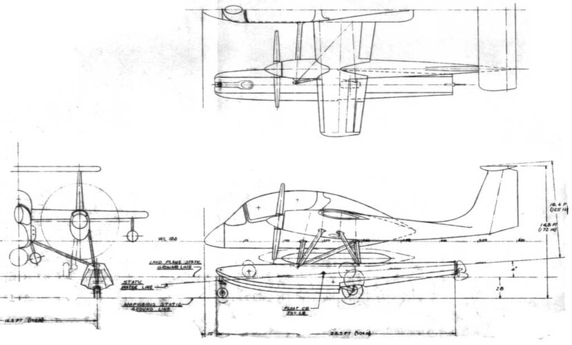

There were several iterations of the V-458 studied and compared.
-108 Single Boom, Air Drop, Amphibious, People Pod, PT6A-6 Engines
-112 Twin Boom, Air Drop, Amphibious, People Pod, PT6A-6 Engines
-115 Single Boom, PT6A-6 Engines
-116 Twin Boom, People Pod, PT6A-6 Engines
-117 Single Boom, People Pod, PT6A-6 Engines
-120 Single Boom, PT6A-6 Engines
-122 Twin Boom, YT74 or YT76 Engines
-124 Twin Boom, YT74 or YT76 Engines
-125 Single Boom, YT74 or YT76 Engines

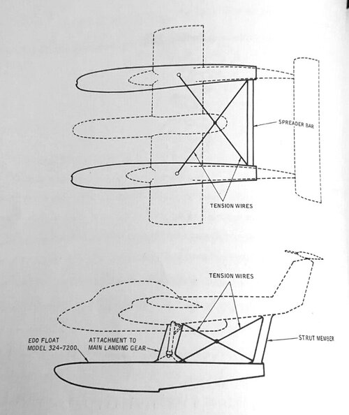

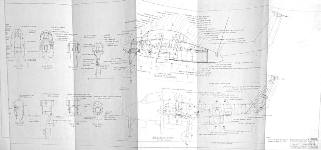

A short while ago there was a Convair binder of drawings of the Charger. I bid on it and unfortuatly lost but had copied some of the images. I've tried to to clean them up a little but can't do much about the folds. Looks like it was a really nice collection of drawings. There were also 6 pages of different main landing gear arrangements (simplified drawings) that were studied, if any interst in these I'll post them later.
Here are the drawings mentioned above for main landing gear studies.

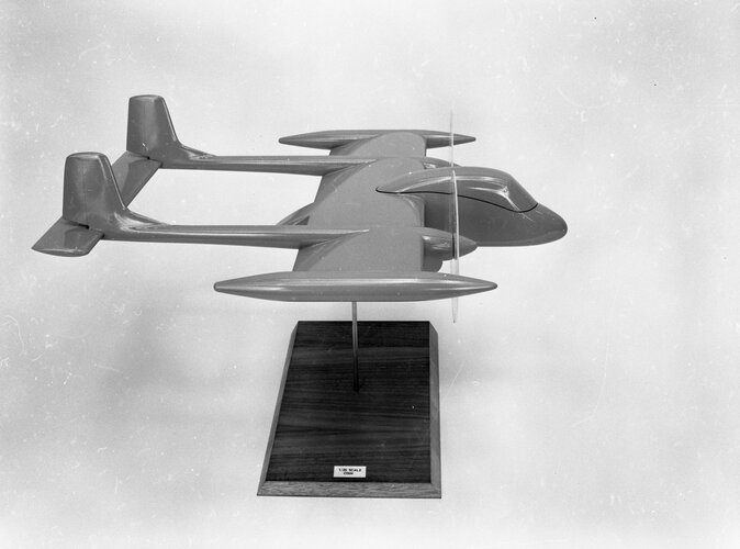

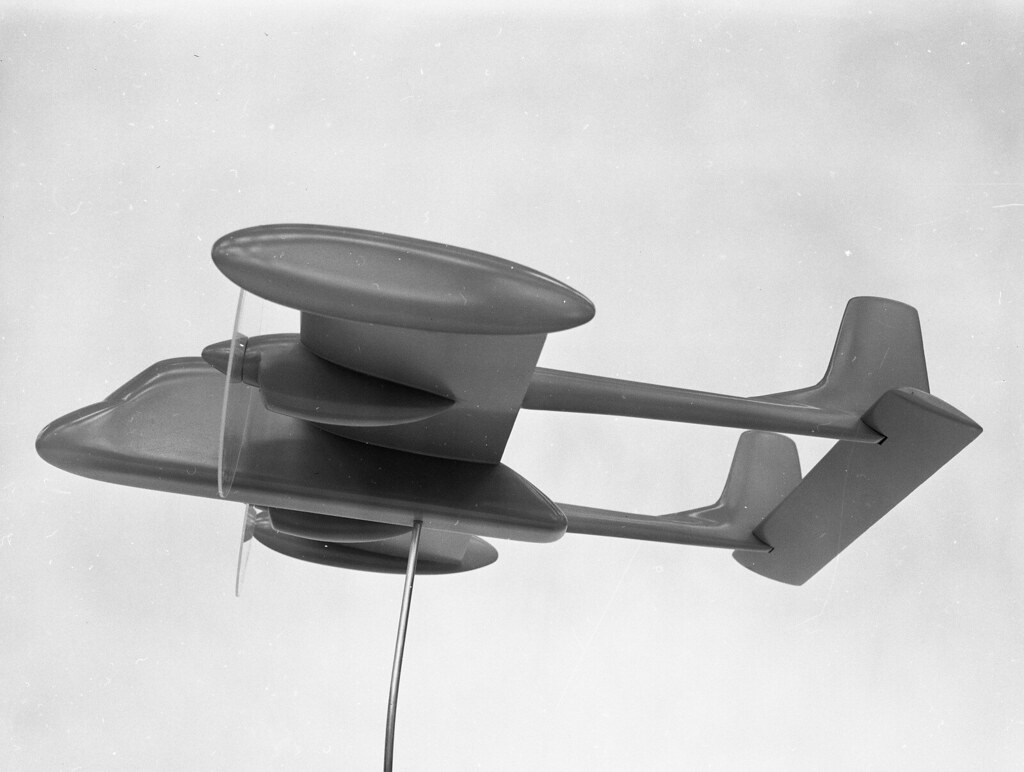

Hello,
has anyone seen this model before and/or knows its designation?
View: https://flic.kr/p/2pkbPkc
View: https://flic.kr/p/2pk6cow
View: https://flic.kr/p/2pkaUR7
View: https://flic.kr/p/2pkcy5G
View: https://flic.kr/p/2pkdaER
SDASM flickr archives said:
Convair Negative Image
Load alleviation function model 07/25/1962
Source: SDASM flickr archives
Thanks in advance for a short response. :)
Dear mods, please feel free to move this post to a more suitable topic.
A model of an aircraft simply marked Convair COIN, photos date 1963.
This model above posted by RAP (1963) is definitely an early Convair Charger - see this photo from the Naval Fighters Charger book.
I'm pretty sure the other model posted from SDASM is an early COIN study leading to the Charger too. From the Naval Fighter book:
I had been assistant to Art Lambert, Chief of Preliminary Design, and we had already done some preliminary layouts of a COIN configuration.

A 1963 article on L² VMA by Major W. H. Becket

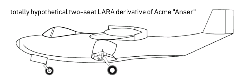

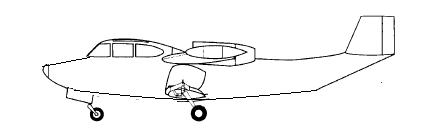

Please can anyone make a drawing to this Project,it was based on ACME
A.1 Anser,with a tandem two-seat looks like OV-10,and a landplane version,
just a sketch if possible ?.
I am not good in paint,but I try to imagine how it was ?.
It's the cockpit area that should be changed, not the hull itself; the project was still an amphibian.
Also, there doesn't seem to be any indication that it was a tandem two-seater, just that it had a fighter-like cockpit.
Something like this, with side-by-side seating? I don't think we should indulge in such hypothetical artwork in this section, though. We do not have enough elements to produce a realistic interpolation of the project.
