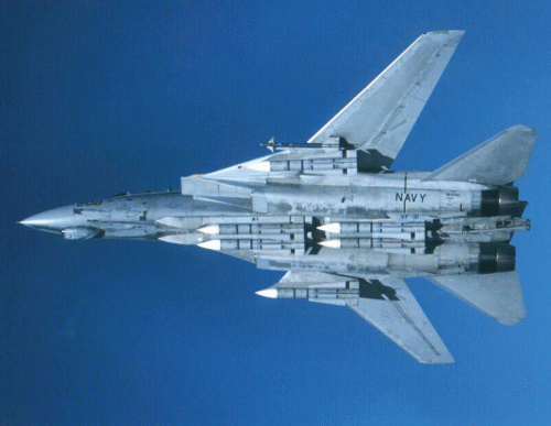

and that avatar pic of F-14D is just so good . Any chance of seeing it bigger ?
Chances are pretty good

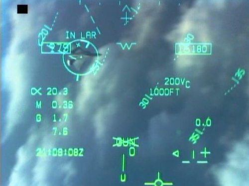

Well I heard that the SH vs F-22 was BFM with the F-22 starting off in a disadvantaged position rather than at the merge but this might be just F-22 boosters trying to talk it out of getting shot down. If you look at the HUD the SH is going pretty slow Mach 0.36 which would imply they've done some ACM to get to that position and speed. The F-22 with an inexperienced pilot does have a problem with over using its sustained 28 degree a second turn rate and using TVC for post stall maneuvering. TVC causes a lot of drag and while they can still control the plane it starts to sink. The arse end drops and the other fighter can go vertical because the TVC plane can't do that.

I think it's understandable for the f-22 to "lose." Remember that practice for the f-22 is always against overwhelming odds, with the f-22 put in positions with tremendously disadvantages and against overwhelming number of enemy aircrafts (like 12 against 40 or something), and the fact that it could mass killed these enemies in these practices said alot.
What you're seeing here, in my opinion, is the problem with getting into a sustained maneuvering fight. The SH is very good at low speed high AoA, which is one of the reasons it may want to be down to M0.36. The F-22, though, is better than the SH in everything related to air combat. However, by getting into this kind of a furball, it has thrown all of its advantages away, and the outcome becomes more problematic. Since it is likely that the F-22, or more relevantly the F-35, will be outnumbered by its adversaries, doing this is a invitation to suicide. The F-35, while certain to be agile (though probably not as much as Raptor or Typhoon) will fight a different way, if employed properly, a way that is more realistic in today's world. Frankly, so will Rafale if it intends to accomplish its mission. Given this, and realizing the missions it will have to perform, F-35 is the better choice for the RN provided

I'm afraid that I must disagree with you particularly on the primary role of the fixed wings on the RN's decks. The primary reason for any carrier's existence is strike And the weapon it uses for that strike is its aircraft. Air defense of the carrier (which can also be handled by supporting ships) exists in order to permit more strikes. If the primary reason for embarked aircraft is air defense, well then just sail out of range of any opponent and you accomplish the same goal, with a lot less hassle. of course, your enemy forces are left intact... Air defense is important, but if the carrier doesn't exist to strike, then why does it exist?
Am I wrong or did you just say air superiority isn't necessary at sea? Well, I don't know what to say to that.
I think his point was that it was meaningless by itself, air superiority exists in order to permit you to do something else, which is almost always striking the opponent.
