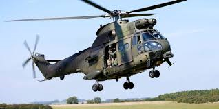

I was informed today that five EU nations (NATO) have signed a MOA to develop a new medium helicopter.
Below is my estimation of the aircraft that will come from this study.
Please no bluster, it is done in jest.
@yasotay That’s the best case scenario. The worst case is the Brits win the design leadership after a drunken round of beer and fish & chips at the local pub and come up with something like this :p
Oh god, is there an H-34 buried under that bloat?
I believe that's the second Westminster prototype, so the dynamics are a hybrid of S-56 (CH-37) and S-64 (CH-54). Honestly it's an upgrade over the H-37.

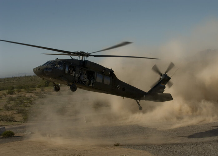

I was informed yesterday that cost is very important in developing a new U.S. medium helicopter.
Well... maybe.
Affordability was IMO more referring to in-services cost (maintenance, parts affordability, etc...). Hence the emphasis on the generic term "cost".
IMOHO the US Army remind everyone that reaching goals at the detriment of long term sustainability won't be rewarded as much as the effort put-in by contractors would let them think.
@TomcatViP - I do agree that this would be a logical method. However the Army has traditionally looked at the price tag on the window first. Finding out after the fact that the cheaper aircraft might be more expensive in the long run due to the considerations you mention. Both of the contenders for the FLRAA are very keenly aware that this time round the Army is looking hard at sustainment cost, and desire more advanced maintenance methods that can be performed away from airfields, in the mud. It will be interesting to see how it turns out. One contender has 16 rotor blades per aircraft and a very tall transmission. The other might not fit in the current hangers the Army has.

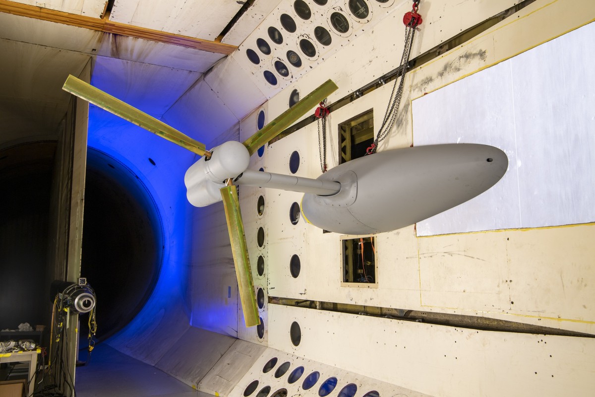

smaller rotors = higher disk loading.
Nothing is free.
Whirl Flutter!?! This is a solution in search of a problem. Likely a means to keep the historic whind tunnels of Langley in business. None of the US tilt rotors have experianced this phenomena. Having the privelage of knowing several of the men who did XV-15, V-22, QTR, and V-280, the question was asked about the issue. Whirl Flutter was know before XV-3 and the aircraft have been designed to take this into account. To the comment about fat heavy wings, I am not convinced that thin wings are what I want for a low altitude combat air vehicle. A-10 comes to mind. I am no aero-engineer, but I would think vibration issues might be more pronounce in a thin wing tilt rotor.
Thin wing for range and speed on smaller (?), higher aspect ratio airframe?
Don't forget that the area swept by the rotor disk has a ~2v airstream component (twice the speed).
You might then get compressibility effects there and a torsional moment with the zone not affected.
Smaller airframe built for range will have to have smaller engines and more efficient cruise parameters, hence increased span with all the related problems above ;)
