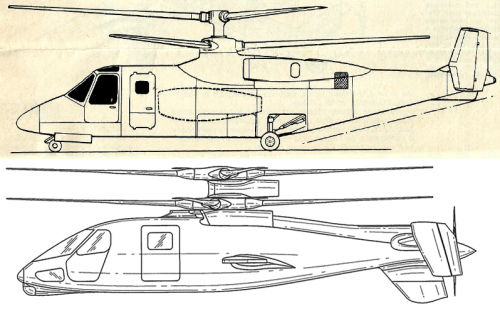

In regards of fuselage-tail taper:
This illustrates the question I'm asking: prior to 2010 or so, X2 depictions showed the engines/mast in the same location as in a conventional helo. Since then, they're showing the mast assembly moved aft. Any particular reason? Pre-2010 concepts below (they're elsewhere on the forum, I just repeated 'em here for convenience).

I suspect that the dynamic component and likely significant vibration dampning apparatus take us more space than they thought it would take.
The side views of the patent design drawings allow a more objective comparison. I cannot identify any significant difference between the 2005 and 2012 design layout...even the XH-59A had a forward fuselage which is unusually long for a helicopter (1975).

I'm not 100% sure, but on S-97 the engine is buried within the fuselage, aft of the cg. The transmission occupies more or less all the volume under the rotor. That means all your payload has to go ahead of the cg, hence (i believe) the longer nose.
As to why the engines are buried as opposed to on top of the cabin, i can only assume that the drag hit of exposed nacelles at 250 kts militates against such an installation, but there may be additional reasons of entirely different nature.
VTOLicious said:
The XH-59 was an experimental craft, so I wasn't concerned with that one.
The patent drawings are notional and generic, but even there the 2005 drawing shows cabin (and possible baggage access?) space available underneath the mast, whereas 2012's shows nothing there. As you can see in those pics I posted, the earlier concepts all showed usable space (indicated by windows, among other things) under the mast. The more recent concepts show that space being all forward. If the cabin/payload bay could be under the mast like conventional helos or earlier concepts, they could have a shorter vehicle and/or more efficient use of space. So I'm still wondering what's changed...
A good idea, maybe they found they needed more drag reduction than they thought would have needed earlier for the S-97's 220 knot cruise. But I also notice that on the Defiant, which is actualy slightly faster, the engine housings aren't buried in the fuselage, in fact part of them extend over the cabin. but the mast is still aft. If this is a necessary feature of the technology, it could be an explanation for why Sikorsky said X2 wouldn't scale well above medium size.
One possible (and totally unsubstantiated) explanation could be that for the scout role cabin "volumetric efficiency" is not a priority. For a utility helicopter, it is, so maybe they traded the increased drag and power requirements for better cabin usability?

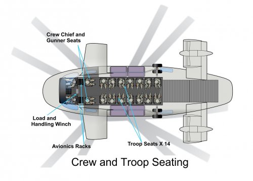

Artist's impressions of AVX Aircraft JMR concepts.
http://www.avxaircraft.com/media-gallery/
NOTE: Larger versions of these images may be found at the AVX Aircraft website

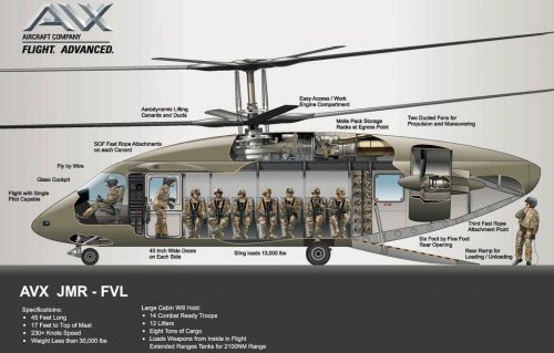

Found this advertisement in the best rotorcraft magazine available (Vertiflight). Thought I would pass it on. Interesting concept from one of the non-traditional vendors.

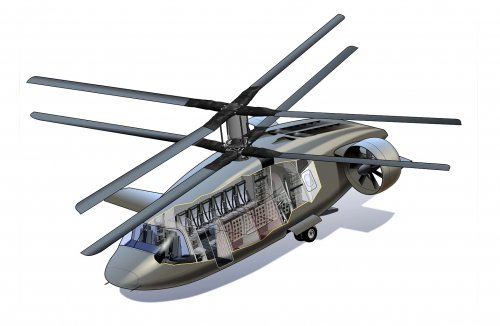

New video and picture by Graham Warwick, the Woracle.
AVX Aircraft video detailing the configuration and benefits of its Coaxial Compound Helicopter concept, proposed for the US Army's Joint Multi Role (JMR) technology demonstration in 2017 and follow-on Future Vertical Lift (FVL) Medium advanced rotorcraft to replace the UH-60 Black Hawk from the mid-2030s.
http://youtu.be/pms7HxH1F-o
Code:
Graham Warwick ‏@TheWoracle 16 Std.
Look inside AVX Aircraft's Coaxial Compound Helicopter concept for @USArmy JMR/FVL Black Hawk replacement pic.twitter.com/lrxkS2XteF
Source: https://twitter.com/TheWoracle/status/463372589617152001/photo/1
Great video and picture,thanks a lot for sharing.
regards
pedro
Evil thought of the day:
Those bottom weapon doors look big enough to drop a Mk54 or AShM through.
2nd evil thought for the day - Metal Storm
I remember those extending weapon pylons from the early Osprey program. Not surprising since AVX is a bunch of former Bell engineers.
Ingesting plume and maybe even debris, that results from firing rockets may not be a good idea,
so positions for weapons pylons are limited, I think.
Two things I think regarding weapon placement. As mentioned limited terrain on the side of the aircraft, with those big fans at the back. Then they mention high commonality so going through the bottom of the aircraft likely reduces the amount of modification needed to turn the core airframe into an attack variant.
Only bad news is that I don't think the attack pilots are going to be keen on having rockets and missiles pointed at the back of their heads.
LOL. Maybe they could replace them with vertical weapons storage (nose down) and have a 90 degrees swinging arm to lower the weapons into the airstream. Would solve the accidental discharge into the back of the aircrew problem and be more space efficient allowing a larger number of weapons launchers to be fitted.
