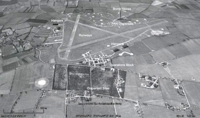

The plan seems to have been that the UK-based TSR.2s would not have participated in the conventional phase of the war and would be dispersed to await the nuclear exchange - SACEUR's R-Hour.
So this would be something akin to the V-Bomber dispersal. The V-bomber dispersal bases had purpose-built pads built etc. and presumably as the Vulcans and Victors retired/phased onto MRR and tankers, these QRA pads would have been available for TSR.2 and no cost and no runway issues. Evidently the Air Staff must have concluded that these dispersed bases were compromised and wouldn't survive a first strike due to location/already on Soviet target maps, clearly TSR.2 was meant to sit out the first strike (unlike the V-Force which would head one-way east as soon as the hooter went).
It only takes less than a dozen H-Bombs to make the UK a wasteland, arguably any airbase along the eastern coast is in some kind of fallout zone at the very least. Some bases in the west, or Wales and Scotland might survived fairly unscathed. The majority of ex-WW2 airfields are in Lincolnshire, East Anglia and in the Home Counties - all prime irradiated wasteland territory.
Given all the emphasis on self-engine starting, ground-running air con, special vehicles etc. it seems odd that there is no specific mention of NBC activities. Talk of open-air servicing or belated tent servicing implies airfields without hangarage or any sort of protection.
Assuming the TSRs arrive at their locations already loaded with WE.177, presumably the ground-running air con would be kept going on the aircraft 24/7 in certain temperature conditions to keep the bay cool and dry?

I have found this though - the modern building regs for airfield construction.
Back to the WW2 bomber bases - there were still lots of these and they are largely concrete slabs laid with gaps between. Maybe of variable quality and not maintained for 20 years?
I remember many years ago, a colleague who had been a building contractor telling me that on one job they had a tough job breaking up the concrete on an old airbase (I can't remember which one, I think it was one of the ex-USAF bases closed in the early 90s). A JCB with an hydraulic drill attachment ended up with a knackered bit and not much hole to show for it!
