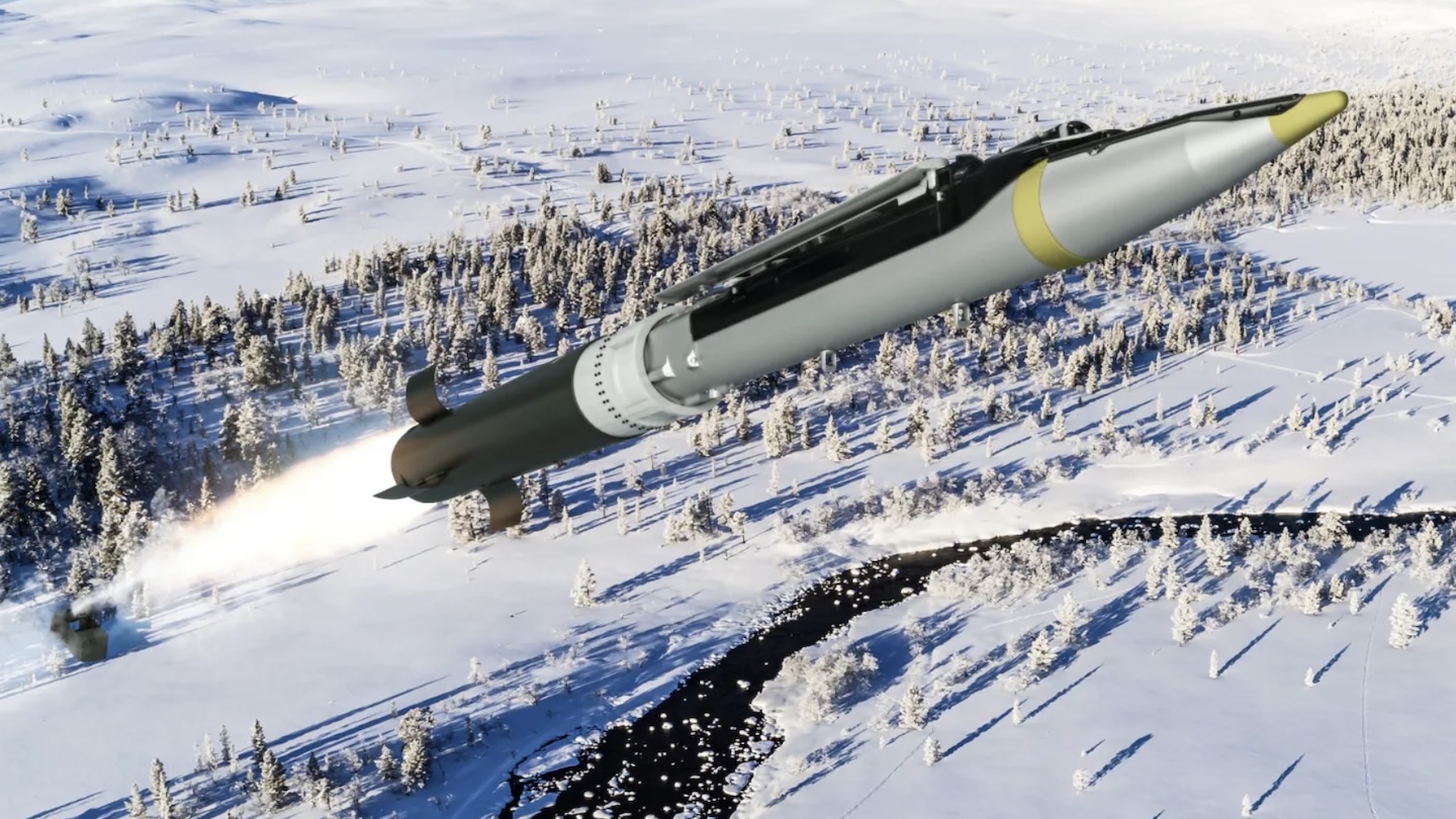

Ground Launched Small Diameter Bomb (GLSDB)

Given that the GLSDB has proven itself there's no reason to restrict it to using just surplus M26 rocket-motors, what about also using, say, the RUM-139 VLA launch-booster/airframe but with the airframe for example modified to fully encapsulate the SDB?

Crud, if you're using that setup, you might as well pack 3x or 4x SDBs into the aeroshell. There's plenty of room for them all!
You could easily do that using a Mk-72 launch-booster but with a Mk-114 booster two SDBIs tops, the SDB-I weighs 285lb while the VLA's normal payload - was a Mk-46 (508lb) or a Mk-54 (608lb). It would have a range of about 15 miles or perhaps 30 miles with a single SDB-I. What might be better would be a two-stage launch-booster using the Mk-114 as the first-stage and a Mk-136 TSRM as the second-stage and that would have a fairly lengthy range with an SDB-I payload.

Well, I considered the idea of using the ESSM's rocket motor to launch quad-packed GLSDB's from Mk-41. At least on paper the idea seems workable.

The ESSM's rocket-motor/tail assembly was one of several others I've thought would be a good SDB launch-booster (Especially if the SDB was fully encapsulated to cut down on drag).

True. Of course, even with aerodynamic collar, the SDB would be heavier (it's weight is essentially the same as ESSM total weight), but since the purpose of the motor is merely to boost SDB to required altitude - it's perfectly acceptable. And if GBU-53/B StromBreaker would be used, then even this problem would be avoided due to its small weight.
The idea of quad-packing a SDB's in Mk-41 actually looks attractive:
* For merely one Mk-41 module filled with SDB, a warship could got a 32 land/ship attack weapons, useful for both coastal bombardment and self-defense against small boats & unmanned drone boats
* Filling half of Arleigh Burke Mk-41 with SDB (for coastal support missions), she would got a 192 weapons - likely enough for a long-range, fast-reaction support, that USMC always wanted
* A specialized coastal bombardment platforms with multiple container launchers filled with SDB - a reincarnation of the old Rocket Support Ship on a new base - could easily be created.
Other rocket-motors that could be used to launched ground-launched SDB-Is are the AIM-7M/P's Mk-58 rocket-motor (Using the Sea sparrow's JVC unit to pitch it over in the right direction if launched from a Mk-41 VLS, the AIM-120's Aerojet rocket-motor (I don't know what its Mk-number is) and associated tail-control assembly or the SM-2/6 booster-stack with the SDB-I encapsulated in a 13.5" clam-shell aerodynamic fairing in place of the missile's GCU/warhead assembly for example.
