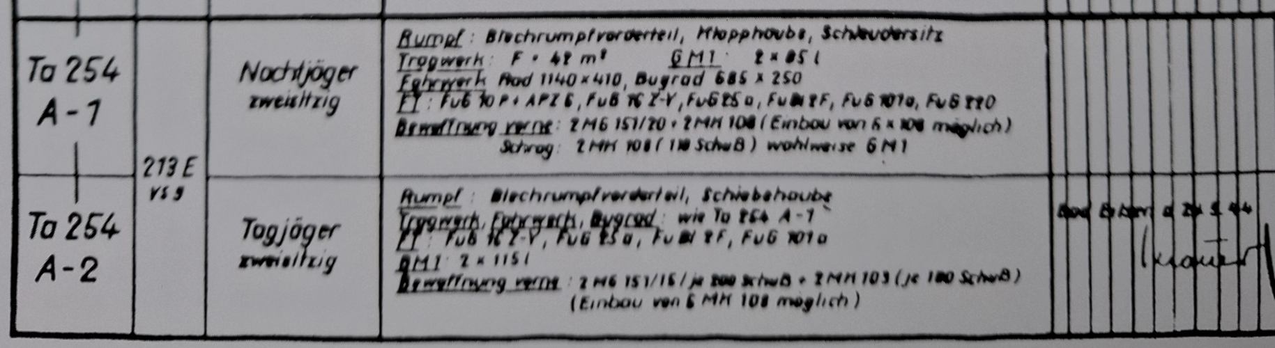

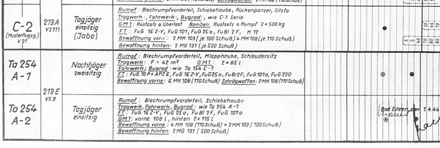

Having done some more research, it seems the evolution of the Ta 254 configuration went like this:
April 1, 1944.
Two types - two-seater A-1 and single-seater A-2:
May 24, 1944.
Two types - two-seater A-1 and two-seater A-2:
May 31, 1944.
Four types - two-seater A-1, two-seater B-1, two-seater A-3 and two-seater B-3:
June 10, 1944.
Two types - two-seater A-3 and two-seater B-3.
It seems like both the A-1 and A-2 were deleted prior to the Ta 254's cancellation. Maybe due to the supposedly imminent availability of the DB 603 L and the non-availability of the MK 108 (all needed for Me 262 production). It's not entirely clear how long the A-2 existed as a single-seater for, but probably slightly longer than it existed as a two-seater.

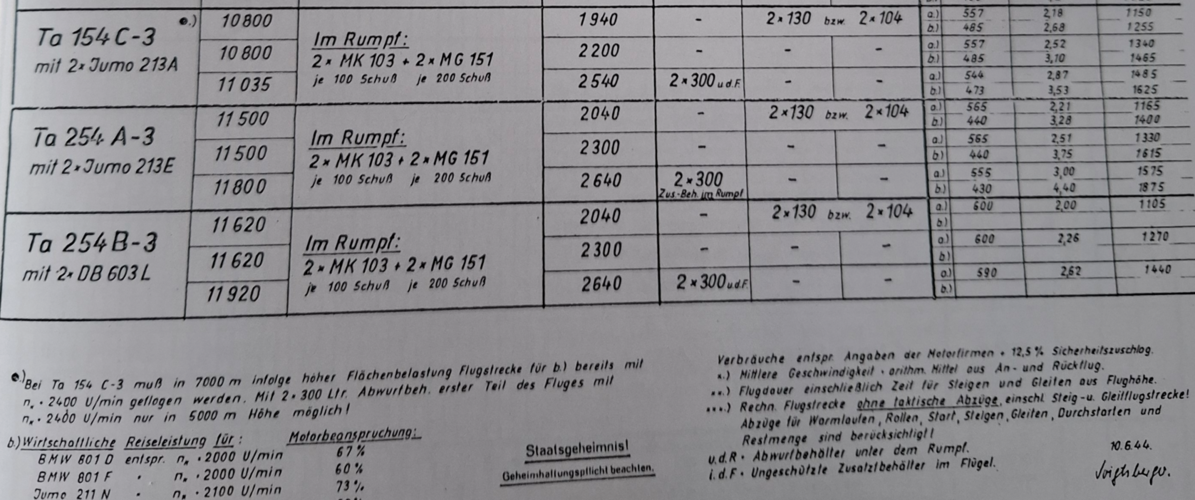

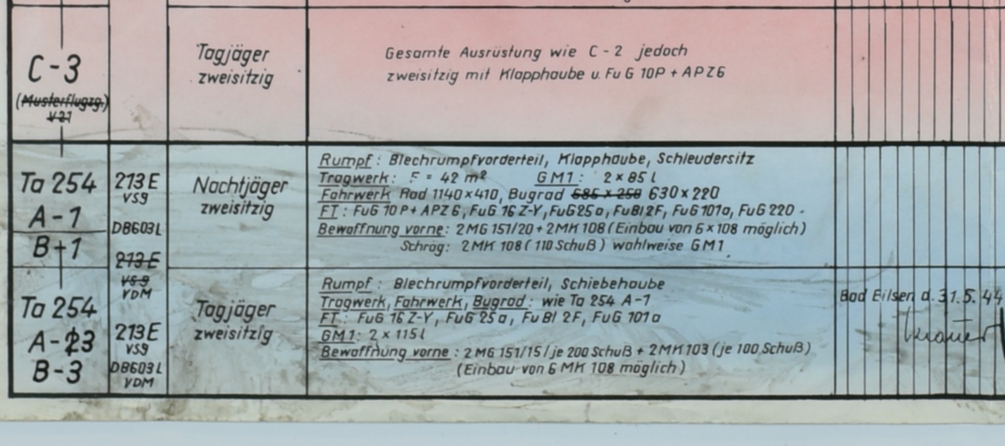

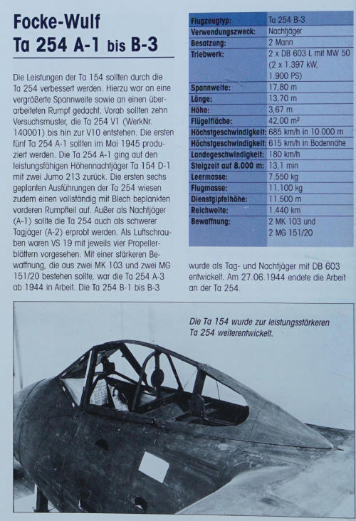

I'm also attaching images from 'Luftfahrt History- Focke Wulf Fw Ta 154 und Ta 254'. The images feature the 254 A-2 canopy and BK 5 installation drawings into a 154 C-?.

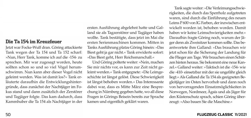

During a meeting on 23 - 25 May at the Obersalzberg Göring already wanted to cancel the Ta 154/254 but Tank managed to convince hime that the glue problem was solved. According to Dietmar Hermann in a 'Flugzeug Classic' article:

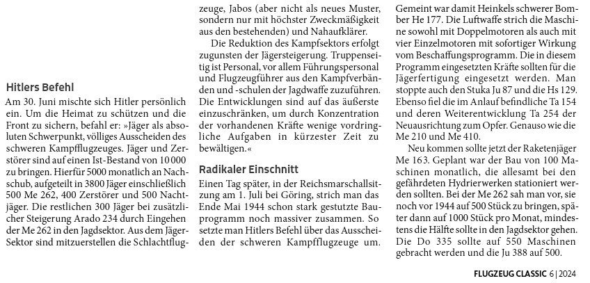

Then on 6 June D-day happened, and soon the decision was made to focus aircraft production on a limited number of fighter types only. The Ta 154/254 and Me 210/410 production were cancelled. Moreover no new heavy attack aircraft or bomber production, again according to Dietmar Hermann in 'Flugzeug Classic' :

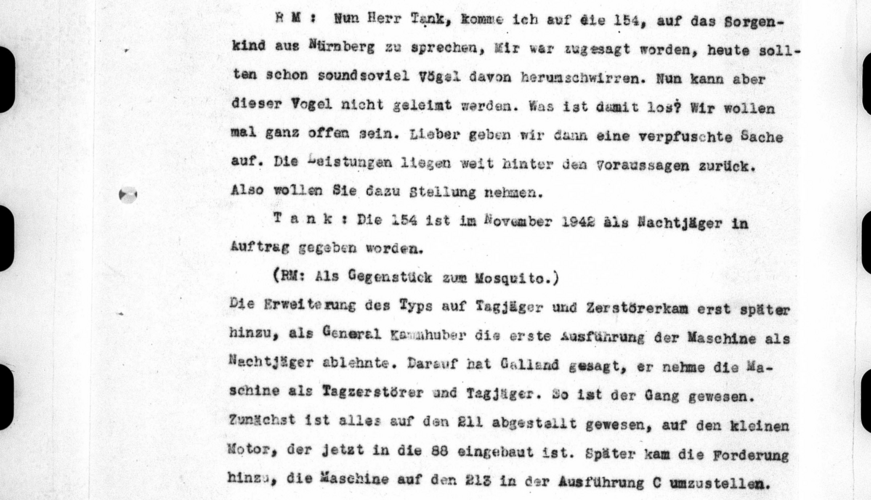

Hermann doesn't include the full stenographic transcript for obvious reasons. The full thing begins in classic Goering style (see below) with a humorous comment - calling the Ta 154 the 'problem child from Nuremberg'.
I don't know if Hermann mentions the timing of this particular extract. It's from almost the very end of the three-day meeting - May 25. Two days earlier, on May 23, the Ta 154 - its problems, its performance and its wider situation had already been discussed at length by Goering with Knemeyer, Milch, Galland and others without Tank present. I think maybe there was no move to actually cancel it at this stage - Goering was just yanking Tank's chain.
The discussion on May 25 actually goes on way, way longer than Hermann seems to indicate and goes quite exensively into the question of performance.

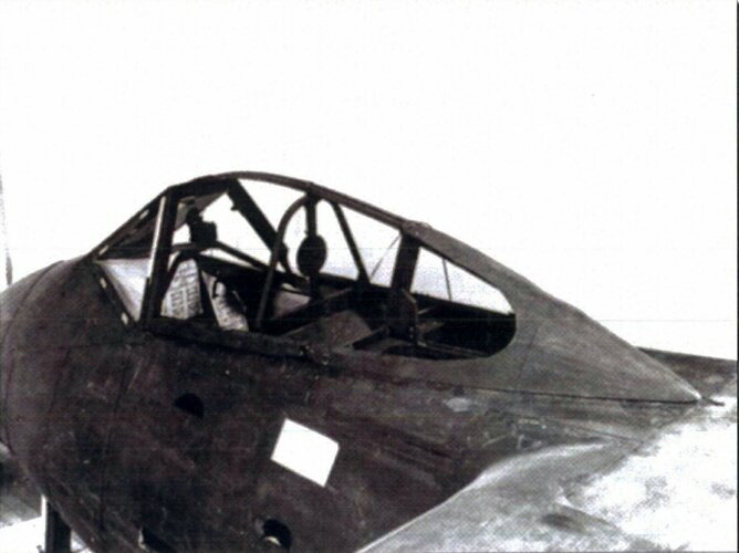

Small nitpick: the raised cockpit improved pilot vision a lot but also caused a bit more drag.
