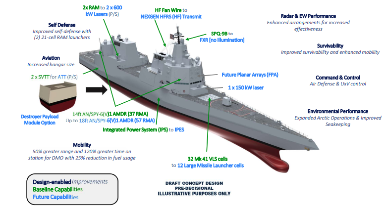

The newer versions of Mk 38 are better -- they are true remote weapon stations and the Mod 4 even upgrades to a 30mm gun with the option for air-bursting munitions (AHEAD-style). But yes, none of them are in the same class as Phalanx. But Phalanx is definitely on the way out, with RAM replacing it. That's why the published concept design for DDG(X) has two RAM launchers and no Phalanx. I'd expect that to hold true until they can maybe replace RAM with lasers (but that seems to be less imminent than it was a few years ago).
Weight for these kinds of secondary weapons probably isn't the critical constraint on a design as big as DDG(X). But arrangeable deck area and centerline length are going to be issues. That's one advantage of peripheral VLS as in DDG-1000, but there is little sign of that making a comeback for DDG(X).
I will still say that I expect to see a powder deck gun on DDG(X). The number of 5-inch rounds used in the current fracas in the Red Sea makes it clear that there is a role for it, especially if HVP is actually happening. (Plus the shotgun round for small boats and swarming drones). I don't see both 5-inch and 57mm, if only because there just isn't the deck area and below-deck volume for both.
