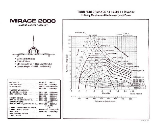

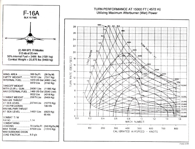

The facts. At excess power of 0 FPS, STR for F-16A at same altitude and loadout is 14.5deg/s vs 12.5m/s for the Mirage 2000. The maximum ITR of the Mirage 2000 is 23.5deg/s under the same conditions vs 20deg/s for the F-16A. The answer for the F-16A is to climb while turning to make the Mirage bleed energy until it can't follow.

Absolutely, the Mirage 2000's advantage is lower wing loading and hence more lift. The F-16's advantage is less drag and more thrust.
