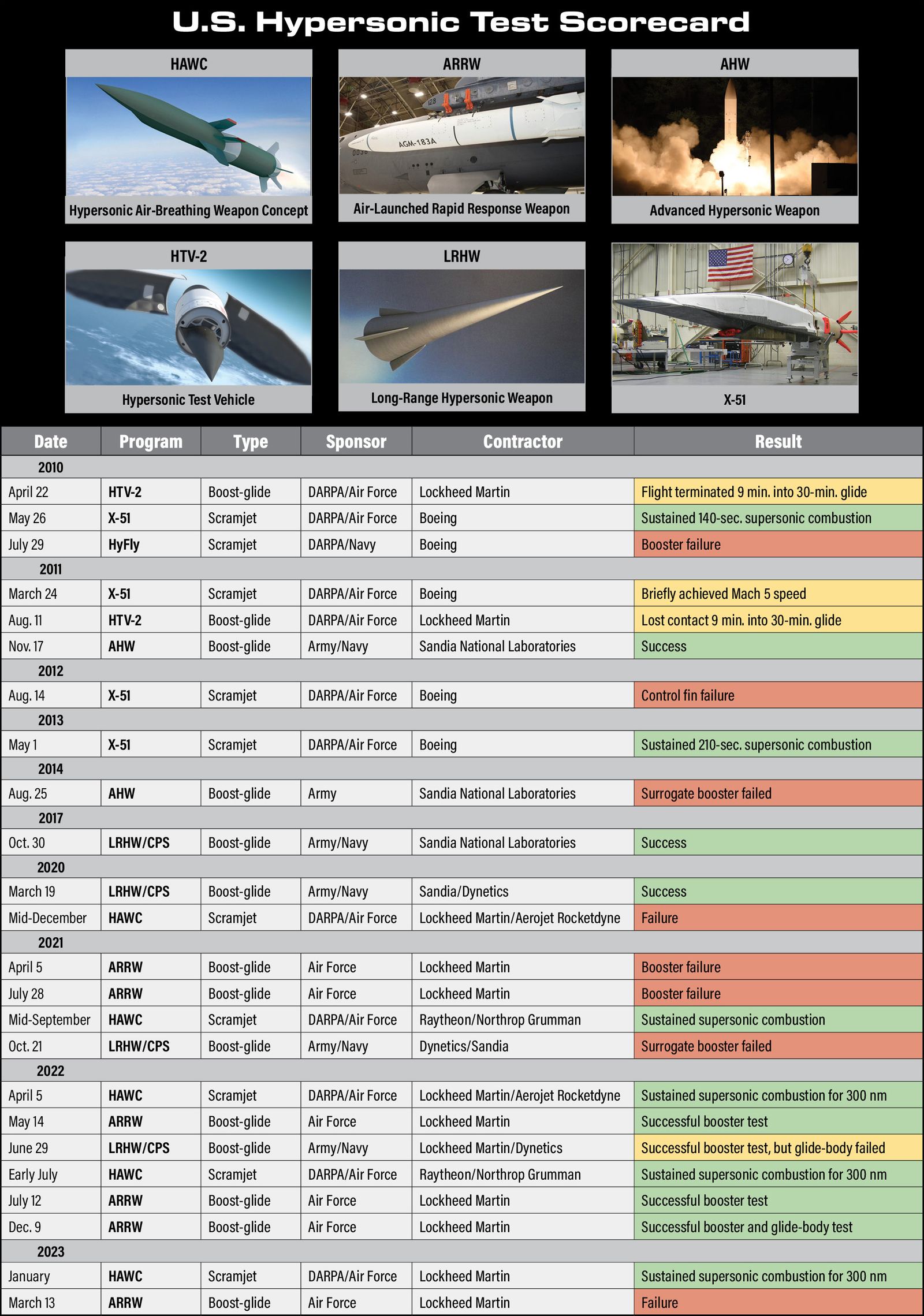

I posted this slightly more than 1 year ago, very good table from Aviation Week.
The list also ends at early 2023. Since then we have had two successful ARRW and 2 successful LRHW/CPS flight tests. There has probably been flight test activity supporting DARPA's MoHAWC that they have not shared details about. Meanwhile, HACM is expected to begin testing this year so there's more to come.
