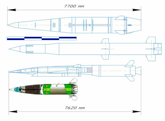

I’m sure someone has posted this but what would be the size difference, but to have roughly the same range, between ground launched and air launched at, let’s say .90 Mach and 40k ft?
Taking SM-6 as an example (since now it has both variants), you can probably strike targets at the same range without the booster when you air-launch vs surface launch with booster.
I don't see how a PrSM designed to fit in a F-35 internal bay would have any different range than SiAW/AARGM-ER which is designed around those same constraints. The USAF's SiAW program is optimized to provide an attack weapon to its stand in force. It has other programs for longer ranged weapons both in mature stage and in the S&T realm.
PrSM is roughly the same length as AARGM-ER but it has 17 inches diameter while AARGM-ER diameter is only 10 inches, it should be capable of carrying alot more propulsion. I don’t even think PrSM need to be able to fit F-35 weapons bay. If PrSM can reach 500 km when launched from ground, then it should reach something like 1000 or 1500 km when launched from 40k ft, perfectly adequate stand off weapon for F-15, F-16,F-18. It could be something to complement SIAW

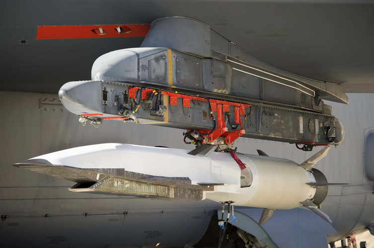

The missile displayed in that image is X-51...
X-51 is referenced as the image. I assumed a much smaller interstage and the fact that the booster is not as large (dia) as ATACMS - 19 inches vs 24 inches. Overall, this should be a less lengthy, roughly 20 feet or thereabouts vs the 25 ft length of the X-51 which is roughly hAWC length as per prior Navy solicitations.

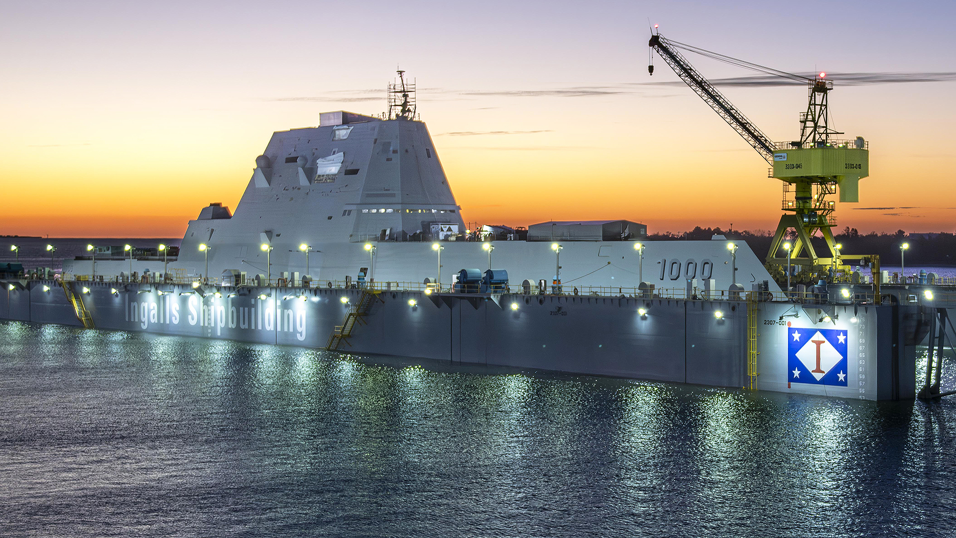

The USS Zumwalt* has just finished its' 14 month refit to carry hypersonic missiles, from Defense Updates:
A big development has taken place when it comes to augmenting the capabilities of the US Navy in the realm of hypersonic weapons.In Aug 2023, the guided-missile destroyer USS Zumwalt (DDG-1000) arrived at Huntington Ingalls Industries (HII) Mississippi shipyard to begin a two-year process to install hypersonic missile tubes.The warship has now been put back in the water after undergoing 14 months of work.The launchers that will eventually fire Intermediate-Range Conventional Prompt Strike (IRCPS) hypersonic missiles.
In this video, Defense Updates analyzes how the Zumwalt class is on its way to getting a major lethality boost with the IRCPS system?

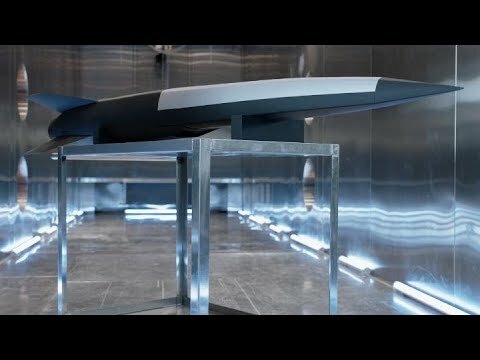

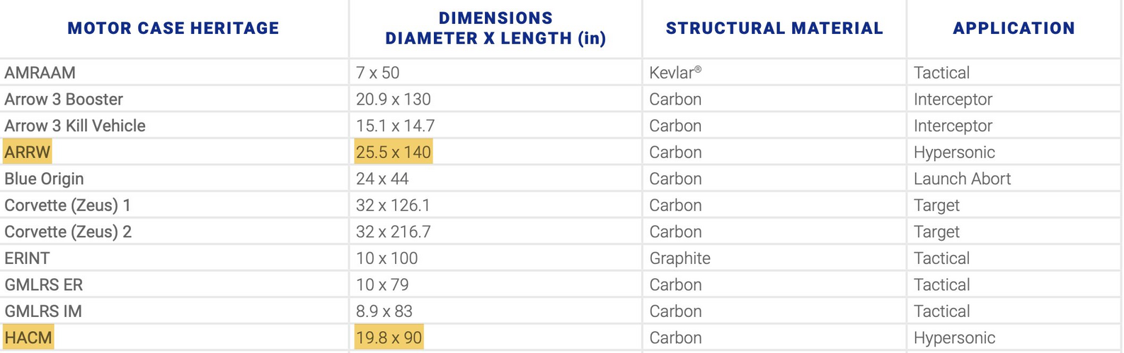

My guess as well; I think it will be roughly AGM-86 size/mass. The 3D printed engine is supposed to be half the weight of X-51s machined version, which should make for a lot of savings everywhere else. Shrinking the interstage and optimizing the booster for the role should also drop weight.
6m (20ft) would be an interesting length because with another 0.55m of booster added it could also become a VLS missile as well as an AL-missile. I note it's the right diameter for such too.
I doubt it. That likely is not nearly enough to get the scramjet cruiser going from sea level. HALO, which will be limited to 15 feet, would be a better candidate. You could tack a mk72 onto that, and I suspect HALO will not be a pure scramjet regardless of who produces it.
Hard to say, a 300km ATACMS reaches around Mach 5 at 1.5+t and that doesn't have the extra booster length plus another 0.55m for ground launching.
That said, with the HACM being AF and the HALO being Navy you are probably correct that the HALO is a more likely candidate.

We have a poster here who says that a B-52 struggled to get the X-51 to altitude.
I don't know if that's true but it's a heavier missile and you'd be able to use a 3m (10ft) long 21" booster to get the vehicle to altitude and speed from a ship. The X-51 engine may also have had a very limiting operating envelope with it being a prototype. I don't know how flexible the HACM engine will be but the minimum speed for a scramjet is around M4.0, which seems achievable.
