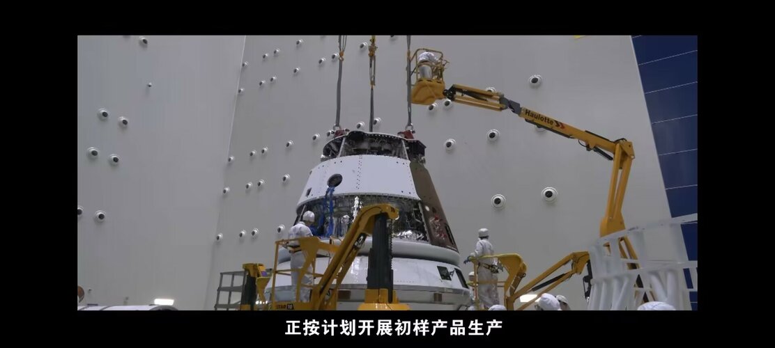

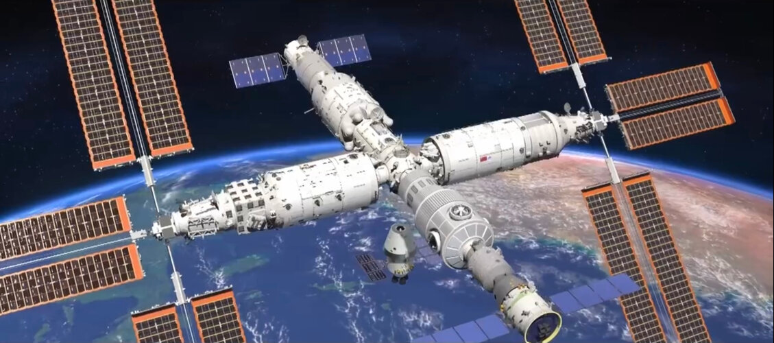

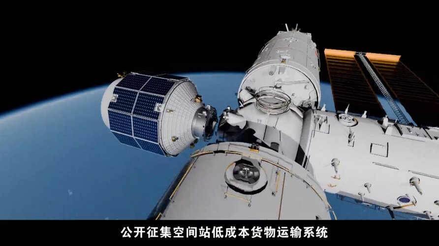

By the way, Qingzhou is directly docked to the space station, which is different from the previous concept
Apparently CMSA wants to add a Node module to Tiangong, probably to accomodate Mengzhou, Qingzhou, Haolong spacecrafts, but also maybe in preparation of new modules?

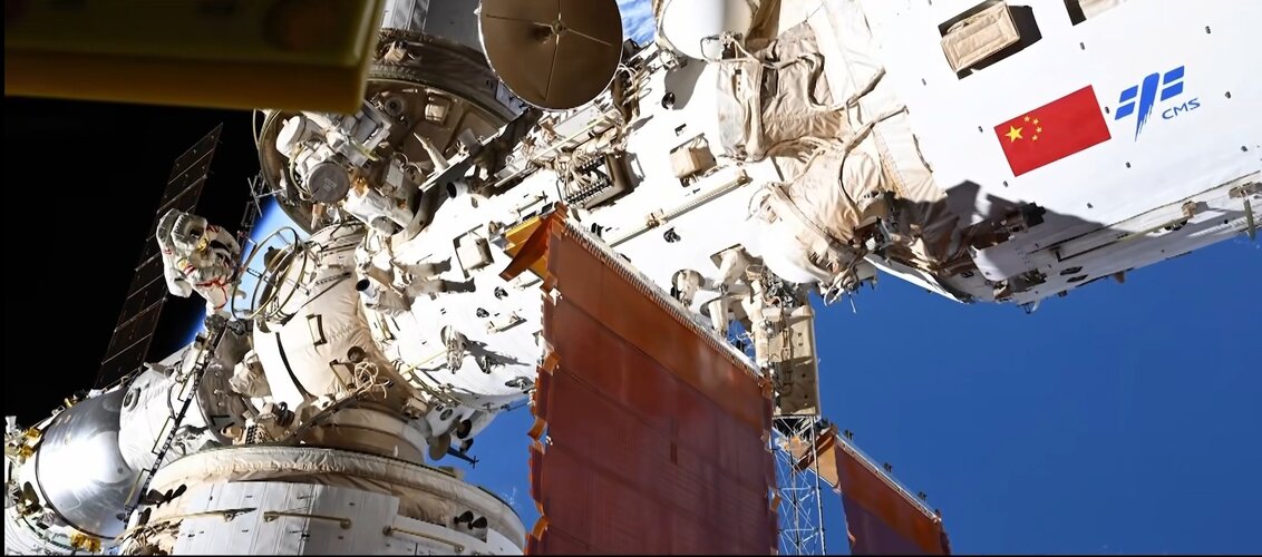

006aWhMSgy1hvtrqiy13dj31pc0r67ks.jpg Also some nice new pictures of the 2nd Shenzhou 17 EVA

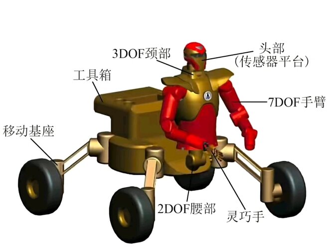

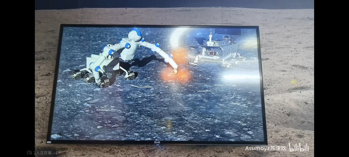

@cattalonX Subject of clip? Summary?

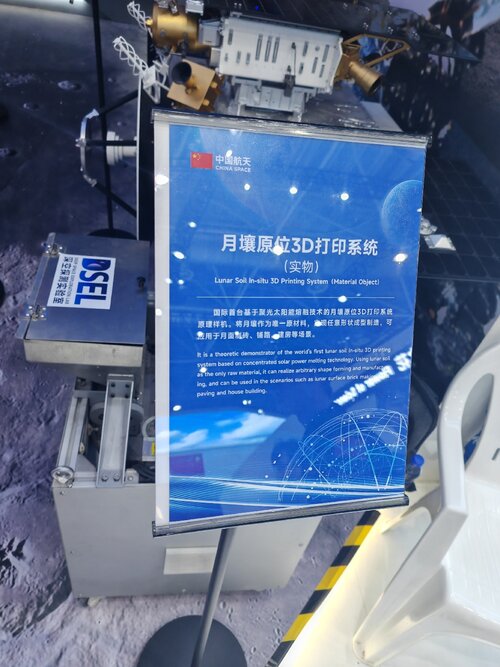

It is an illustration of a component of the upcoming Chang'e 8 mission, the mission will carry a rover (which will apparently have an humanoid robot) that will be able to take lunar regolith samples, process it in the lander's integrated ISRU system that will 3D print bricks (such bricks are currently being tested on Tiangong), and the rover will then be able to lay those bricks.
There was a prototype of the Regolith processing and 3D printing system exhibited at Zhuhai recently, but I can't find the source about it anymore...

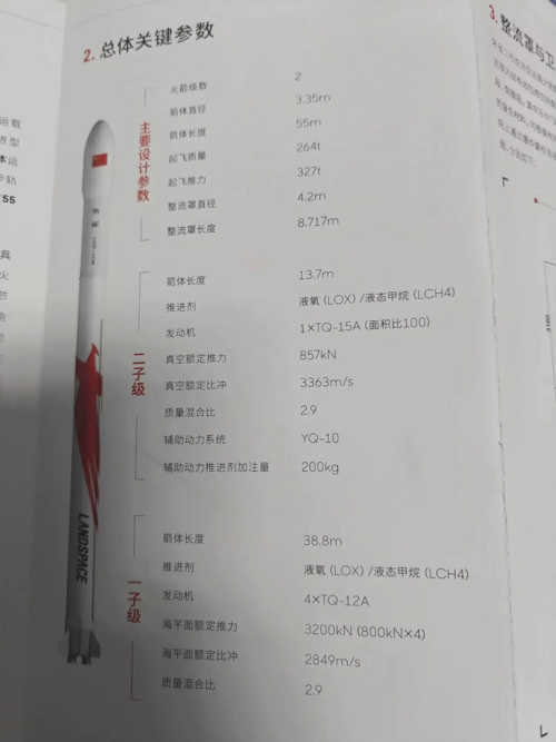

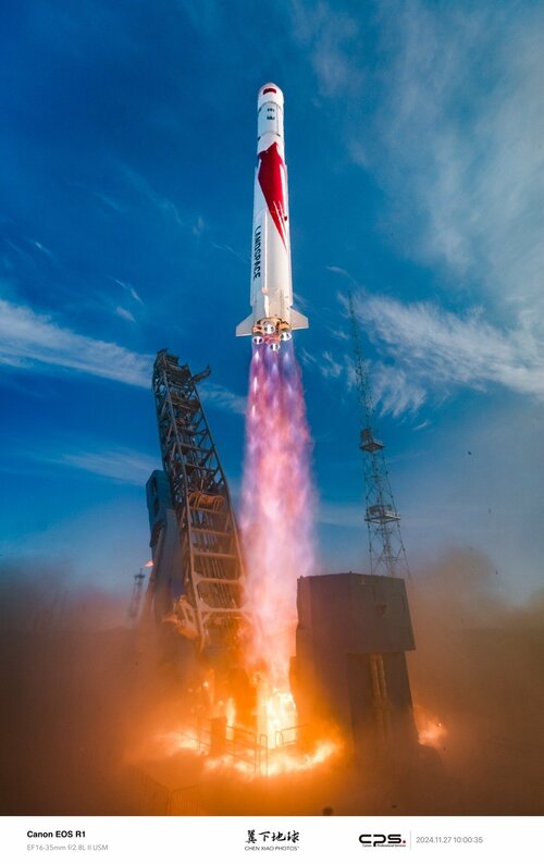

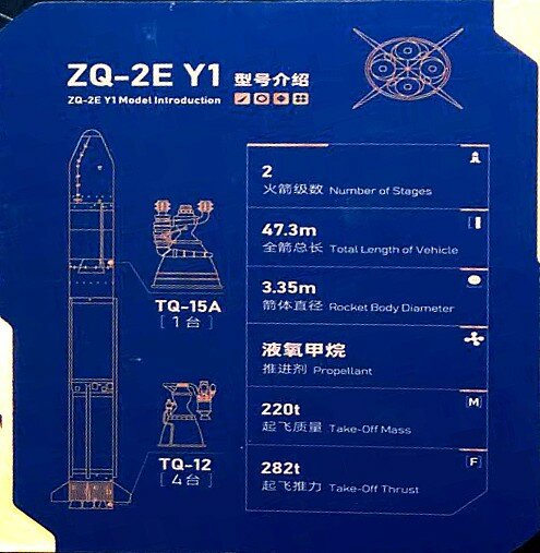

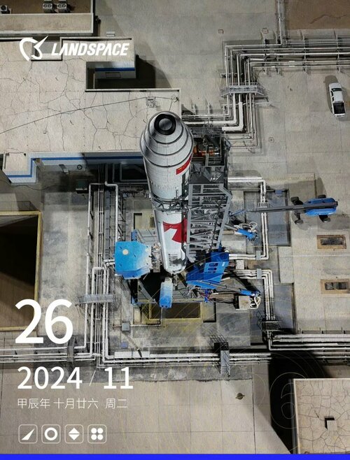

Landspace's Zhuque-2E is the upgraded version of their Zhuque-2 launcher, which was the first methane-fuelled launcher to reach orbit last year. It has an entirely new second stage with a new restartable engine that replaces the previous Engine+vernier arrangement, and future versions will also have uprated first stage engines although this particular model doesn't have them yet. Announced payload to Sun synchronous orbit is 3.5t; and 5.5t to LEO.
1732639947170.jpeg ZQ-2E Y1 and Further upgraded version of ZQ-2E 1732640020195.png
The launch is currently planned for the 27th at 02:00 UTC; if all goes well Landspace hopes to launch the second model next month.

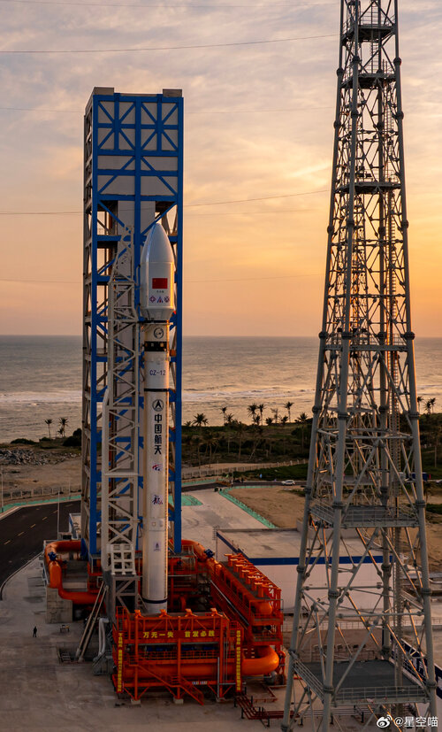

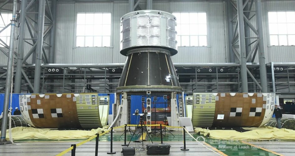

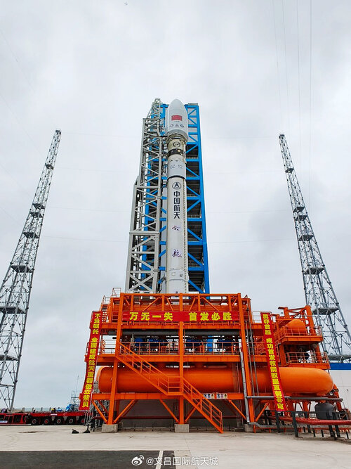

After a couple months of delays caused by the Yagi Typhoon, the CZ-12 is ready for its inaugural launch NET November 30 at 13:30 UTC. It is a new medium launcher (12t to LEO) made by CASC's SAST subsidiary, comparable in size and performances to the Ukrainian Zenit launcher or SpaceX's earlier Falcon 9 v1. It will notably test the YF-100K engines of the CZ-10 lunar launcher.
In the chinese spaceflight community, these expendable launchers are considered as "stopgaps" before reusable launchers, since both their manufacturers are working on Reusable launchers that will share components and infrastructure with them (Zhuque-3 and CZ-12A/B)
摄于广东珠海 第 15 届中国国际航空航天博览会
The 15th China International Aviation and Aerospace Exhibition
it's from the Zhuhai Air Show

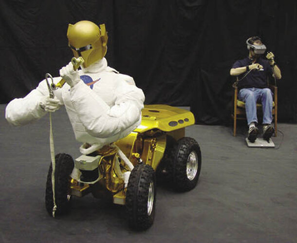

And,this robot is so weird
5f1876e37e199056ce8109d087aba22125804213.jpg 548d75ff1c51e4c2abd1b79bbcb0cb1e25804213.jpg
Tony Stark·······
why leg·········

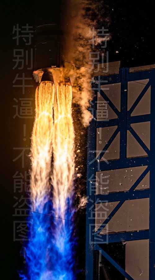

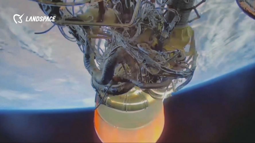

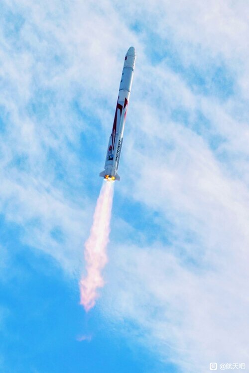

Landspace's Zhuque-2E launch was success
it reach orbit deploy it payload
then second stage reignite it Engine for testing
source NSF

And indeed, both inaugural launches were successes, Both carried technological demonstrators for LEO broadband internet constellations, based on previous announcement and orbital data, Zhuque 2E's payloads (Guangchuang 1&2) are likely related to Landspace's subsidiary Hongqing project of megaconstellation, and the inaugural CZ-12's payloads (Weixing Hulianwang Jishu Shiyan & Jishu Shiyan 03) are likely related to Guowang, which, by the way, is likely to have its true proper batch launch in as little as two weeks onboard the CZ-5B heavy launcher.
