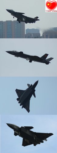

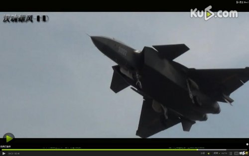

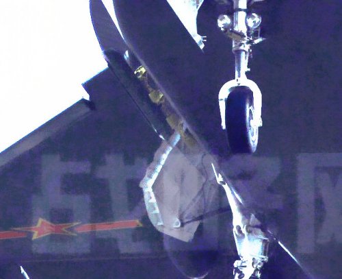

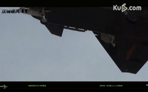

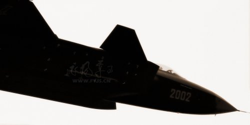

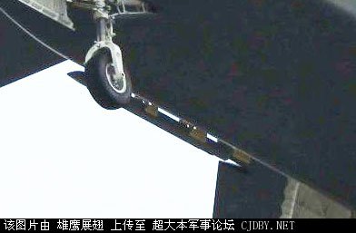

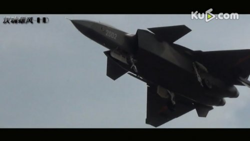

I don't think it is a missile rail because i can't see any separate openned missile bay door, which has to be there for the rail to show. I think more likely it is actually just the lower half of an openned missile door.
I think You are correct ... if You slow down the video image by image it seems as if the door is closing just before landing and what looks like attachments of the rail are a gap between fuselage and closing door.
Then the question howeber would by WHY ?? was there a malfunction and the doors only closing so late or was it again to initiate additional discussions at the forums since flight testing beacme almost boring in recent times ? ;)
Deino
Now I'm no longer sure ... seems indeed like a rail !

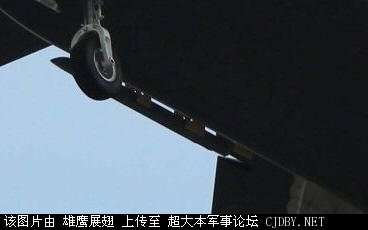

Looks like its bolted on to the fuselage below the side bay, could they be using it to intergrate missiles with the on-board systems possibly for targeting before they test them in weapon bays ?
But where is the door? The rails can not be exposed without the door being open. I think it is just the door seen at an angle that reduced its profile and made it look like a rail.
It's not seen on the jet after it landed. So it can't be bolt on. Must be something that either folds into the plane or retracts into the plane.
Also, it seems a bit early in the development cycle to worry about weapons integration, if you ask me.
It could be a pod attached to the rail for loads/accoustic measurements with regards to the weapons bay, so they know what the "environment" will be for the weapons when tested.

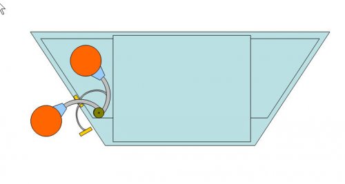

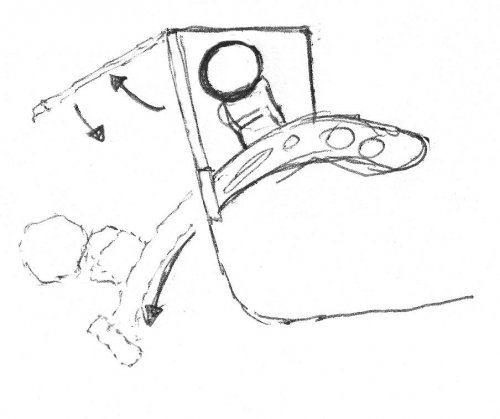

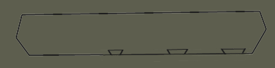

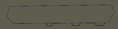

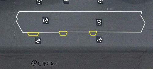

There's currently an interesting theory going on some discussion if the missile could possibly be launched with the doors closed:
http://lt.cjdby.net/thread-1568080-1-1.html
If true indeed an interesting theory ... something like that attached below !
Deino
Deino
That's pretty cool, but might it reflect a limitation of some kind in their missiles/launch-systems?

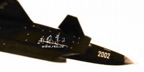

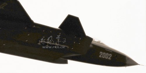

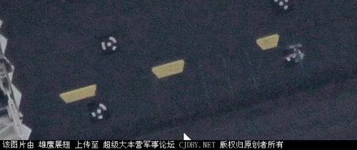

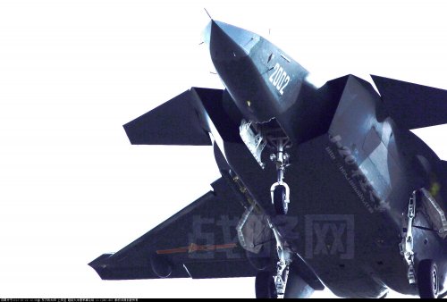

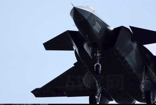

Here's a new image which seems to confirm this theory ... attached are the original (huge one) + two smaller ones I tried a bit to modify ! ???
Deino
2IDSGT said:
Deino
I can't imagine what kind of launch system limitation would such a solution would address...It seems to be meant to maintain RCS during launch...
latenlazy said:
2IDSGT said:
Deino
...Which begs the question: why do their missiles need to hang on the outside prior to launch and for how long? Of course, the old Sidewinders on the F-22 need to hang out; but should things come that point, VLO wouldn't be much of a concern.
2IDSGT said:
latenlazy said:
2IDSGT said:
Deino
*Shrug* Maybe it's not meant to address any problems. Maybe it's just a better solution? For example, in a mission where VLO isn't as important they can probably use those hardpoints to mount weapons that don't fit in the bay. Or perhaps at BVR closing the bay doors minimizes the chance that you'd be detected, thereby maximizing your ability to hit a target without giving it a heads up?
Still seems more likely to me that what we are seeing is the missile bay door itself, not a launch rail.
It might give you a more benign aero environment for launch. Or limit any aero effects from the open door, or aero loads on the door, hinges and actuators, to a transient. Or not expose the open door to blast. In short a lot of potential reasons for doing it that way.
If this is true, then it implies the launch arrangement is designed to hold the missile in the airstream for a certain amount if time. This in turn implies the j-20 wasn't designed with lock-on after launch missile in mind.
chuck4 said:
Not mutually exclusive. It gives the J-20 the option to keep the missile in the airstream. I'm doubtful that the J-20 doesn't have lock on after fire capability, since that's needed for weapons fired from the belly bays.
I am talking about ir missiles from side bays. The ability to close the missile bay doors with missile held in the airstream does not exclude lock-on after launch IR missiles, but is redundant if the missiles can be simply ejected into the airstream and then be commanded by data link to acquire their Lock-on during free flight.
Still not sure we can conclude that. It would imply the J-20 couldn't launch missiles with IR seekers from its belly bays, and I'm somewhat doubtful such a limitation would be acceptable for the main weapons bay.
My hypothesis is that the launch mechanism will keep the bay door open in the airstream a shorter overall time compared to F-22's mechanism. It will be beneficial for drag and leave another extra reflection surface exposed for a shorter amount of time.
This is assuming J-20 and F-22 have similar overall launch times for their side bays of course.
Also, F-22 side bays do not simply eject sidewinders like you described either, I believe. It too "holds" the missile on a rail for a brief moment until the motor ignites. J-20 I imagine works the same, but allows the door to close for the few milliseconds between lowering the rail out and missile launch.
Blitzo said:
Aim-9X is based on missile bodies of older aim-9 version that isn't cleared to be ejected rather than rail launched.
However, that is not the point. The point is is if the missile can lock on after launch, then it won't need to remain attached to the aircraft and exposed to the airstream for any significant amount of time whether it is ejected or rail launched. In this case The missile can go off the rails the moment it is extended into the airstream. it seems hardly worth while to close the missile bay doors first before sending the missile on it's way. In fact, having to open and close the door twice during each launch would only lengthen the launch cycle and extend the period of vulnerability.
However, if the missile must take time to lock on while attached to the aircraft, then it makes more sense to extend the rails, close the door to improve the aerodynamics and stealth characteristics while waiting for the missile to seeks and locks on, and then open the doors and retract the rails after the missile leaves the rail.
chuck4 said:
Blitzo said:
I get that point, but it doesn't square too well with missiles that are stored in the main weapons bay. If the missile needs to seek and lock on its own then how do they fire from the mwb?
I have another hypothesis. What if the side bays can fit a mraam, but it can't clear safely from the fuselage when fired from the bay? Such a solution would make the side bays more versatile.
maybe IR AAMs will not be fired from the belly weapons bay?
I sincerely doubt the side bays will be able to fit an mraam.
chuck4 said:
Blitzo said:
What if the new SRAAM is developed to be rail launched rather than ejected? That would explain everything quite handily.
That really depends on how fast they can make the doors open and close, I think.
Does opening and closing the door twice during the launch cycle lengthen the overall launch time, or was the door speed dependent on a set launch time they were required to achieve?
That is definitely one possible answer, but let's give benefit of the doubt that PL-10 has LOAL ability as rumours of the years have suggested. For the purposes of discussion, what else could justify this unique mechanism?
The only benefits I'd see, would be the reduced drag and door reflections of leaving them open for the entire launch cycle, assuming:
-overall launch time of J-20 is comparable to F-22 (i.e.: door opening and closing is very, very fast, but considering the side bay door seems to only open some 45 degrees relative to the side fuselage this may be possible)
-missile is LOAL
Btw, have there been any existing aircraft with dedicated SRAAM side bays that "eject" the missile out? Two problems with that come to mind, one, ejecting the missile from a side bay may launch it into any aircraft flying level with you (for belly weapon bays it's less of a problem, as flying in formation or with a wingman means your allies won't be beneath you). Two, would the aggressive maneuvering you'd expect in a WVR combat situation necessitate rail launch in any way?
An alternative explanation may be the Chinese wanted the flexibility to lock the missile on either before or after launch, depending on the tactical situation. I imagine in very close quarter combat, it may be advantageous to lock on the missile before it departs the rail.
I think we should reserve judgement until a better photo of the side bay on the j-20 appears.
A new nearly front view !

Here's my rather crude sketch of how I think it works.
Mat Parry said:
Regarding the "China copies everything card" taken at face value this innovation would seem to show otherwise (unless this idea was lifted from elsewhere and we just haven't seen it disclosed before). I'm not optimistic but I'll do a patent search and post if anything pops out.
Assuming this is one of the first examples of China inventing in an aviation context, I would expect other nations would have similar "intel gathering capabilities" ;) as China, so no doubt one of the Western alphabet agencies is well aware of the thinking behind this set up.
There is nothing wrong with copying. If the backward country try to reinvent each wheel, it will either take an inordinately long time to, or never, catch up. We are just alarmed that they are catching up so fast, so we disingenuously belittle their sound strategy to feel better.
Yep fully agree, it's not just China, Even between major corperations in the west "Competitive Intelligence" is a highly valued tool. Of course nowadays the sources of competitor information is only ever openly published material.... :) ;D ;) For example from published patents, the context of the patents and the names of the inventors you can map out discrete groups within an organisation and their main research interests, it's actually quite fun to do this for aerospace companies and you do find some surprising themes.
The problem with copying is that most of the advanced tech is being developed in the U.S., therefore American taxpayers are paying for it. None of those countries develops near as much as the U.S., so the U.S. loses a hell of a lot more than it gains as a result. Then again, we did train many of their Aero-engineers, so this is what we get for doing that.
