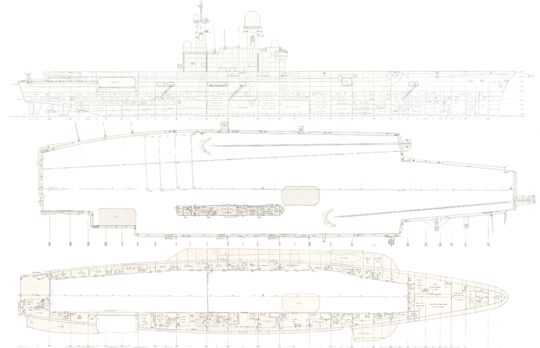

No discussion needed. The answers are in Ian Sturton's excellent article in WARSHIP 2014 as suggested by JFC Fuller above. The drawings of CVA 01 make it a must have.

The icing on the cake for CVA 01 fans are the original ships drawing from the NMM which show a somewhat different design to those published previously, notably in the form of the Island.
