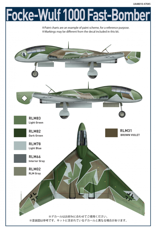

That wing design goes back to Germany in WW2. IIRC, it's the Weissman wing. Not the forward swept part, the tailless gull shape.

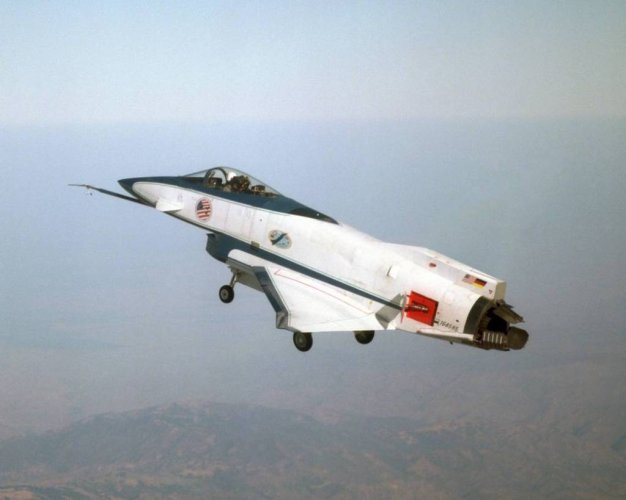

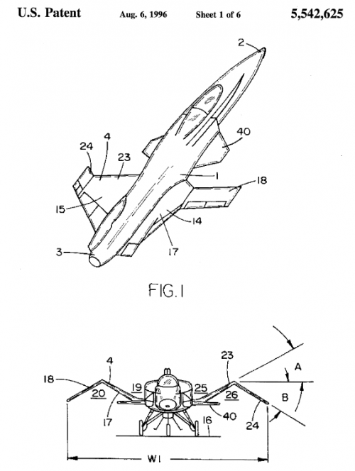

Downward canted wing tips were added to reduce the wing dihedral after earlier flight w/o that section proved unsatisfactory (Dutch roll). This solution prevented from having to make more drastic change to the airframe while it was already in full production.
From wiki:
[...] the stability problems proved to be more serious, and were found to be related to phenomenon known as Dutch roll.[46] While this tendency could be resolved by reducing the dihedral, however, as the He 162 was supposed to enter production within weeks, there was no time to implement major design changes. Instead, a number of small changes were made, such as the addition of lead ballast in the nose to move the centre of gravity towards the front of the aircraft while the tail surfaces were also slightly increased in size.[citation needed] Despite these measures, some figures, such as Alexander Lippisch, declared the flying characteristics of the He 162 to be unsuitable for inexperienced pilots.[47]
The third and fourth prototypes, which used an "M" for "Muster" (model) number instead of "V" for "Versuchs" (experimental) number, as the He 162 M3 and M4, after being fitted with the strengthened wings, flew in mid-January 1945.[48][49] These versions also included – as possibly the pioneering example of their use on a production-line, military jet aircraft – small, anhedraled aluminium "drooped" wingtips, reportedly designed by Alexander Lippisch and known in German as Lippisch-Ohren ("Lippisch Ears"), in an attempt to cure the stability problems via effectively "decreasing" the main wing panels' marked three degree dihedral angle

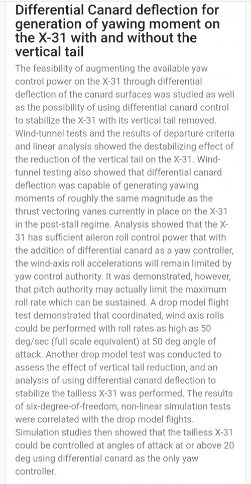

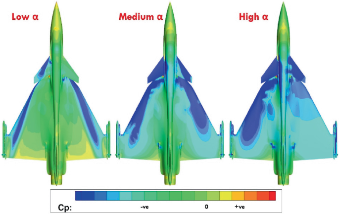

Canards are helpful for STOL:
1. because they can act directly as flaps without creating trim drag, with both the canards and the elevons providing extra lift.
2.because they can act as vortex generators independent of wing AOA, allowing for strong vortex effects over the wing at reasonable approach AOA (compared to eg: LERX) , increasing Cl and lowering approach speeds.
The Rafale actually has lower carrier approach speeds than the hornet, and obviously the Gripen and Viggen use this to great effect for STOL.
Another thing that Canards can do which I think is highly relevant for the F-47, is that they can provide additional means of directional (Yaw) control, even without dihedral or Anhedral.
Differential deflection allows you to use them as a rudder brake, through lift induced drag (or more directly as a rudder if they have dihedral/Anhedral), using ailerons to counter unwanted roll.
You can also differentially alter vortex effects on the wing to create directional control.
For the F-47 this could mean a wider aerodynamic envelope compared to a pure delta design as sufficient directional control could be maintained at higher AOA.
It's worth noting that TVC is not a panacea for controlling otherwise uncontrollable aircraft.
Thrust vectoring is most effective at low effective airspeeds, on aircraft and missiles, because the control forces are fixed; unlike an aerodynamic control surface, a TVC nozzle is providing the same amount of angular force at 500 knots as it is at zero.
This is great for post stall maneuvers where aerodynamic forces are weak, but at corner speed, the 0.3Gs of angular acceleration being provided by a deflected nozzle is chump change compared to the 9Gs being created by the wings.
A pure delta aircraft that relies heavily on thrust vectoring or differential thrust is going to have very restricted sideslip roll and alpha limits at higher dynamic pressure.
