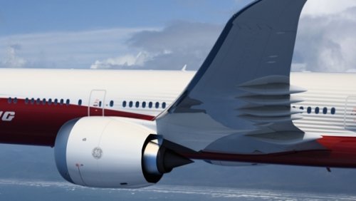

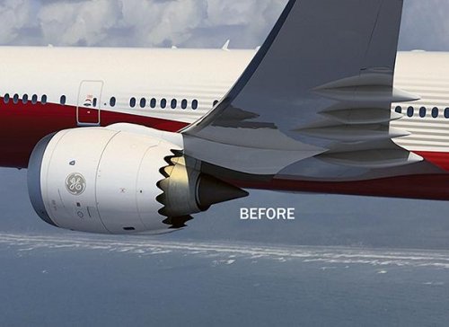

Why did they ditch the chevrons on the nacelle trailing edge? ???
I suspect you didn't read the article in its entirety :)
"We are replacing the chevrons with a new nozzle design technology,” says Beezhold. “It provides equivalent levels of noise for the cabin and community, but is lighter in weight and has lower drag.” The proprietary design disrupts shock cells by mechanically mixing fan stream in the bypass duct with the ambient flow, but does not require the forced mixing provided by the chevrons which, as a result, cause some drag. Beezhold declines to discuss details and says simply: “We have found a way to do it.” The nacelle will therefore look conventional and more like today’s GE90-powered 777."
Mount those turbines any higher and they'll be in front of the wing.
But you can't place the engines any lower, because then you will need to lengthen the landing gear, which will result in higher weight, higher operation costs etc, which therefore will decrease the planes efficiency, which will eventually lead to making the engines fan span increase useless. I guess we are slowly hitting the boundaries of the podded engine under wing configuration. Maybe that Airbus Concept Plane isn't that a bad idea...
