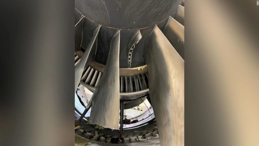

"Initial examination of the Denver 777 engine showed that two fan blades had fractured, accorded to the US National Transportation Safety Board"
Just to deal with the speculation, fan blades will only get into the secondary market if they're from a stripped engine, and they're too complex to fake - investment castings, complex shapes, rare alloys. Has anyone even parted out a 777-200 or 300 with PW4000-112s yet? On top of which both JAL and United are going to be thoroughly embedded with their own supply chains back to Boeing.
PW4000-94s are more likely to have parts available second-hand, and small charter carriers are more likely to access the second hand market. But looking at the debris this seems to be a full blade-off incident, not some minor damage from stator blades or similar working loose.

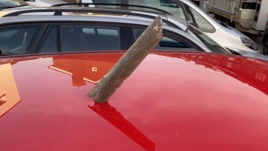

Article in Dutch with film of the debris from the Maastricht incident . I don't have more than the odd word of Dutch, but it definitely seems to say two injured not one The blade sticking out of the car roof is impressively scary - and seems to have a clear fracture surface at the top.
From what I've read elsewhere, the two injuries in the Netherlands were one woman in her 70s hit by a piece of debris and one man burned by a piece of hot metal when they went to pick it up. Neither seem to have been very serious injuries. Very lucky that that bit of blade hit a car instead of the top of someone's head.
Faulty training syllabus in engine's blades non destructive analysis identified as one factor in UA328 777 uncontained engine failure:
