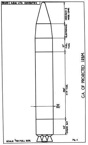

There was an even better design produced, from memory, in 1957.
The original Black Knight was powered by a rocket motor from the RPE, which in turn was later replaced by the small chamber of the Blue Steel missile. David Andrews of Armstrong Siddeley proposed an IRBM using the large chamber of the Blue Steel missile, which had about four times as much thrust. This proposal was completely ignored by the powers that be. This is unfortunate, since it would be quicker and cheaper to build than Blue Streak, and, of course, used storable propellants.
The Gamma 8 engine ? and the Stentor combustion chamber ? (from memory, I've vaguely remember a similar story in "A vertical empire").
David Andrews was a smart engineer. In 1990 he summarized his past experience with HTP in a landmark paper which had a lot of influence in many places (Maxwell Hunter, Mitchell Burnside Clapp, hybrid rockets...)
Ah yes, this very one. Excellent. And dang, that's a Black Arrow / Black Knight - derived, HTP IRBM ? Interesting.

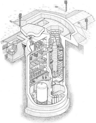

Given the idea behind the silo was it was designed to survive a nearby detonation from a Mt warhead and then launch, what if the silo was a coffin type with the missile stored vertically and raised to the vertical for launching?
The specification was to withstand 1 megaton at half a mile, which works out at a bit more than 100 psi overpressure. The Atlas E coffin launchers were hardened to 100 psi for a larger missile, so it's potentially feasible. Worth noting that this isn't a terribly high level of hardness, though - Titan 2 and Minuteman silos were hardened to 300psi, and later silos may have been even harder.
