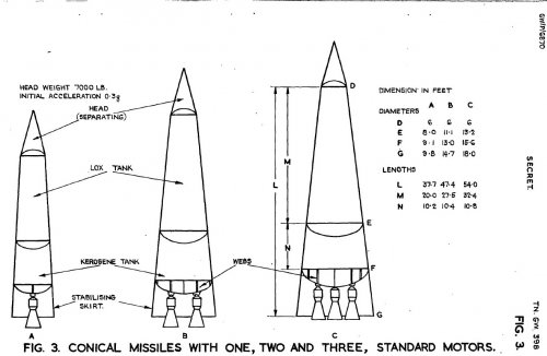

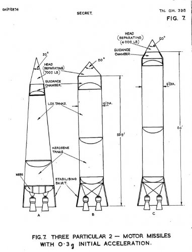

Hi CNH,
The following is copied from a PRO document written about Blue Streak. Sorry it took so long to find, next visit to PRO will match document to the record of documents looked at.
“The replacement of the present warhead by a 600 lb. Head would with some further development of the motor throttling system, allow the range to increase to roughly 3,300 n.m. Alternatevely the load of countermeasures devices to be substantially increased. For example, in addition to the re-entry head itself three dummy re-entry identical but for their nuclear content could be carried”
I'd be interested to see that file if you can find the reference.
After the 58 agreement with the US, we were given designs to two warheads. If Blue Streak had become operational, it would have had the Red Snow warhead. The other warhead was the lighter one - 600lbs sounds right.
There were certainly plans to fit a variety of decoys to Blue Streak, although inevitably nothing came of it.
Hi CNH,
As soon as I visit Kew will let you have details. This might also be of interest.
With the possibility of a 600lb. warhead it was suggested that 65,000lb ~75,000lb LOX/K missile be looked at as a possible alternative to Blue Streak.
This is from the same document as 4 warhead BS.
Would 65,000lb put it in the same ballpark as the 1958 AW IRBM?

Found at DTIC
RAE Technical Note GW 398 “A Study of the Structure Weight of Ballistic Missiles” February 1956
Halfway through it actually mentions Blue Streak…
…until the final layout of Blue Streak is settled together with the shape of the re-entry stage…
the 3 Engine version on first picture
Look like Twin of the Soviet (or was that German?) G-3 / R-12H ::)
