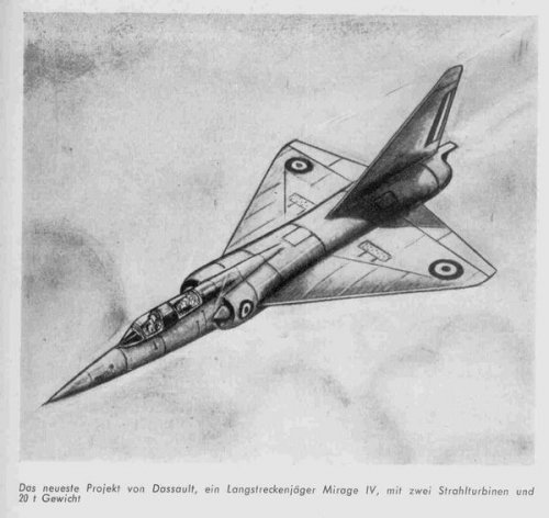

Perhaps he means this Mirage IV, I once found in an Flugwelt issue ?
It really still looks much more like a Mirage IIIB, than the later Mirage IV ...

Yes the twin-engine heavy fighter variant Mirage IV C (project 1956) :
Engines : 2 x 6000 kgp ATAR
Wing area : 43m²
"Take off" weight : 11 T
The Mirage IV of Jemiba's drawing is maybe nearer of the the Mirage VI project of 1958 (17 T and 2 x 9000 kgp SUPER ATAR)
