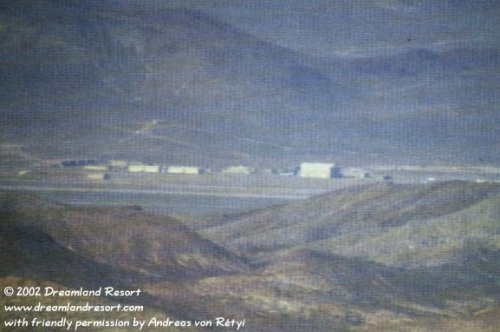

Laugh if you will, but interested to hear thoughts about this photo. Obviously there's no detail (see Trevor Paglen's latest project...) but it does certainly appear to be a very large white aircraft and the photographer, who has also using a large telescope visually, called it an XB-70-a-like.
If X24-C flew in the 60s (high M6!) and there's still nothing but rumour and a disputed squadron patch to show for it the mind boggles about just what the US taxpayer is paying for and when they might get to take a look...
Where the heck can you see a white XB-70 lookalike here, let alone an aircraft, in this blurry picture? Either you've shrunk the pic way too much or you are very, very imaginative...
The aircraft shape that is barely seen in this very blurry photo (I agree with Stargazer) could be anything, ranging from to Boeing 737 (the usual Area 51 shuttle) to any other big aircraft we could (or would) at least imagine.
Anyaway if X-24C indeed existed (and it is still to proof, at least to me) it should have flown not before the very end of '70s or early 80's but absolutely not in the '60s!!!!

You have to zoom in quite a bit. But once you do, and throw in some "image enhancement," you can clearly see the plane. It's not a B-70, though.
Hangar 18 (IIRC) is the big, big one towards the centre right. Out in front of it is a hazy white line - if you have nothing but the photo to go on then yeah, 707 or 737 or whatever would be an obvious guess. But the photographer states it resembled the XB-70, except with an SR-71-style nose. A description we've seen elsewhere, I think.
Obviously his telephoto lens wasn't as good as his telescope but I do like to think of this picture as being perhaps the only black-world aircraft photographed that is not currently declassified - in the public domain, at least. Who knows who is sitting on what out of patriotism or fear or what have you.
If nothing else this photo stands as testimony to the effectiveness of the Federal Government owning 86% of Nevada...
Oh, there are photos of black aircraft out there in the public domain. There are a handful of photos of Flankers and Fulcrums that operate out of Groom Lake that have been published.
Gridlock said:
Then you underestimate the size of the adjacent hangar, or have a more opulent taste in business travel than I.
What is actually more striking about this hangar is not so much its width or length as it HEIGHT.
A stealth blimp, perhaps? ;)
