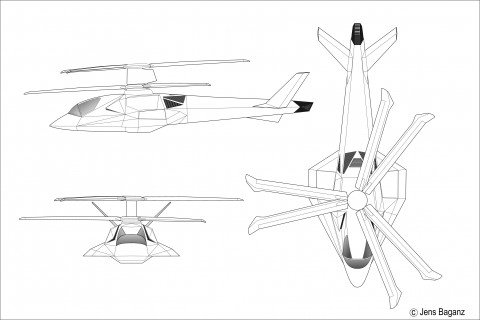

Zero Dark Thirty prop helicopter. Is this an accurate representation of the Stealth Hawk?
http://www.wired.com/dangerroom/2012/08/movie-prop-or-stealth/
http://youtu.be/vcBjOVKKxh0

Oh, and just because I posted pictures of the helicopter prop and the trailer for Zero Dark Thirty, it doesn't mean that I endorse the movie or claim that it is factually accurate. The trailer and photographs were added for purposes of discussion only.
Post script:
The Zero Minus Thirty helicopter prop looks like the love child of a Lockheed F-117A Nighthawk and a Sikorksky UH-60 Black Hawk. Is the implication that the helicopter was designed and built in the 1980s?

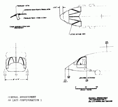

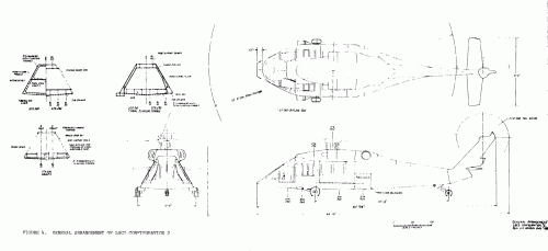

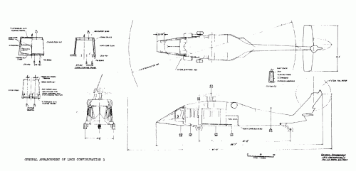

Now for the REAL low RCS (LRCS) studies conducted as early as 1978 to reduce the Black Hawk's signature:
Source: http://www.dtic.mil/dtic/tr/fulltext/u2/a058906.pdf
PaulMM said:
Thanks - Scott posted those on his blog over a year ago - http://up-ship.com/blog/?p=9714 - and a link was posted earlier in the topic, but its nice to have the whole document.
There are a bunch of documents related to this topic now available in DTIC that were not a year ago. There are some studies on low RCS composite tail booms, etc.

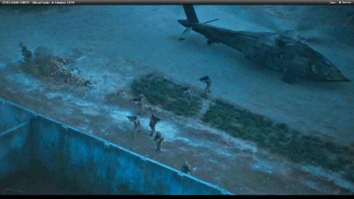

Zero Dark Thirty Trailer 2 has a few more clips of the 'Stealth Hawk'.
It really does has a very specific look: unusually specific for a Film production. Sawtooth edge detail is visible to some panels on both the production still and the video clip. I'm increasingly inclined to think that this is based on eyewitness accounts... very 'Eighties'...
Ok is it just me or is that a worthless clip? It's darn near all white, like trying to see a Polar Bear in a blizzard and what little I could make out, didn't look like any helos.
I don't think there's any reason to believe they got access to or information about the real aircraft. The designs look like a typical semi-plausible design from a movie model maker who had access to the Internet and knows a little about aircraft -- no better than the FA-37s from Stealth.
F/A-37 from Stealth was made with a help from Northrop Grumman guys btw
Yes, but the design clearly has nothing in common with a real aircraft. If anything, NG was steering them away from anything sensitive.
