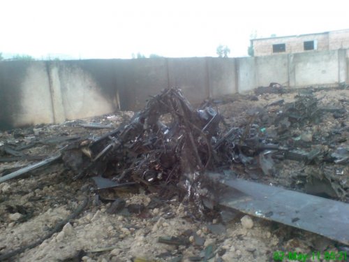

New pics are a confirmation for me that there seem to be two distinct tail units in the debris: one that is smooth and looks more like a mockup than an actual helicopter tail (the one in most pictures) and one that was darkened by the destruction of the damaged helicopter and is crooked. The former is the one that was found outside the precinct; the latter presumably lay on the inside. This to me points towards a possible collision between two choppers... But I'm willing to be proven wrong if some conclusive evidence/convincing explanation is shown.
I think some of that may be from attempts to move the debris.

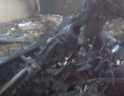

here another Picture of the destroyed chopper
found on Spiegel.de
Source: Reuters

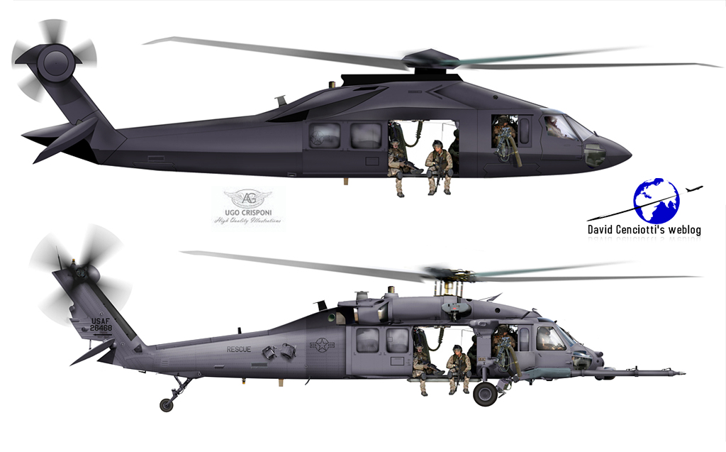

And here's is the latest version of Ugo Crisponi's sketch of what the 'Anasazi' ( ;) ) might look like, from David Cenciotti's weblog:

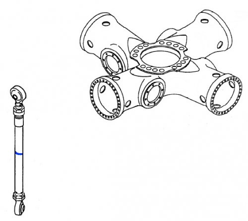

If this is a UH-60 derivative, the changes are more than skin deep.
Compare the rotor head pitch link attachment of the wreakage (top image) with one from the UH-60 (detail from a photo taken here http://www.b-domke.de/AviationImages/Rotorhead.html#Sikorsky.)
This is definitely different. It IS a Sikorsky helicopter, but it is quite different than the UH-60. Maybe it has one or two additional blades and the rotor hub has been entirely redesigned.

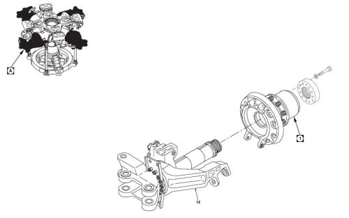

I have to agree with Machdiamond. The rotor and spindles in particular look very similar. At least from what can be seen from the crash site picture. I am attaching an illustration of the spindles and the rotor hub and pitch controls.
