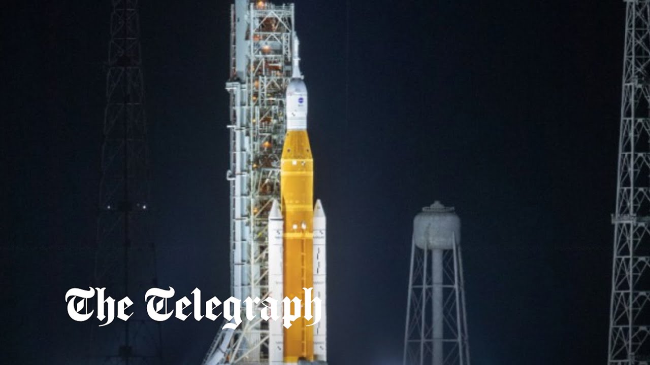

This morning I had my first look at the fully assembled #Artemis1 rocket - I’m speechless! Years of dreams and exceptional hard work at @NASA have paid off - WE ARE GOING! Launch window to the Moon opens at 08:33 ET tomorrow! Follow along:
