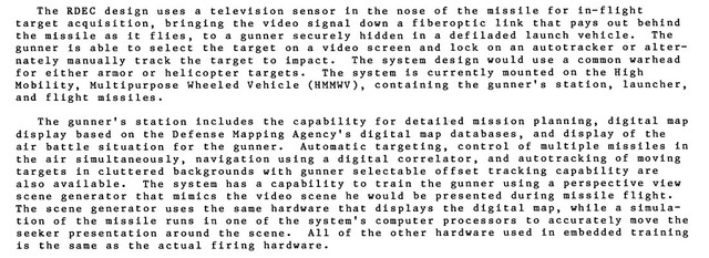

What ever happened to the Fibre-Optic guidance system of FOG-M?
It seems on the surface to be an ideal solution to this problem. Long range, heavy warhead and it strikes it's target from overhead, avoiding the heavy armour a horizontal weapon has to attack. It could be mounted on a light truck as well, which makes it very air portable.
It is quite a popular option outside the US. The Israeli Spike series, except the Spike NLOS which uses a wireless link, are all FOG missiles. The new Spike II is especially impressive looking.
Part of the reason is that the during the AAWS-M competition the FOG missile was rejected in favour of what would become the Javelin and this was the last completely new tactical missile to enter US Army service. Subsequently only modifications of the TOW, Javelin and Hellfire have made it to the battlefield.
It's not clear how many delivered versions of Spike actually use the fiber. The SR and MR versions are fire-and-forget only, like Javelin.

Sure it does; fiber permits much higher bi-directional data rates and much lower latency
which in turn makes things like performing automatic tracking and aimpoint selection on the
launcher-side readily doable.
FMTI was shorter range and fire-and-forget; the 2-way RF datalink had a much lower data rate and, AFIAK,
was mostly for LOAL fratricide avoidance.

Wireless has a lower minimum latency than fibre. EM waves simply travel faster through air than glass. The bandwidth available is higher in fibre true, but the bandwidth available in microwave or MMW links like the Spike-NLOS and FMTI use(d) is far in excess of what is actually needed for the relatively low-resolution video and missile data. The FMTI wasn't especially short range for its size either, it was tested to 8km (not trivial for a TOW-sized missile with a rocket motor) and had the potential for significantly greater range. And of course, the wireless Spike NLOS has a range of ~25km and seems to work quite well.
The attraction of fibre is the same as the attraction of wire in older missiles: The link is more reliable, especially at long distances, and it is largely immune to hostile interference. The principles of TV guidance did not change when it occurred to someone to link the weapon to the launcher by a fibre optic cable; TV guidance was already well established when optical fibre entered the picture as a potential alternative to radio links.
As for the Griffin, it is not alone in that regard. The Javelin has also been mostly rebuilt, there is a nice picture I don't have right now showing all the components that have been replaced since it entered service and it is almost the entire missile. As has the TOW. And the Hellfire. But they are still not completely new missiles. This isn't even my own observation. US tactical missiles which are not derived from existing missiles have been pretty consistently axed.
Propagation delay through the medium is not the major driver for the latency difference.
It's the protocol overhead of making RF datalinks reliable, full-duplex, LPI/LPD/jam-resistant etc.
FOG-M and its derivatives were not low-resolution which was the whole point.
Spike NLOS RF and FMTI are both predominantly F&F missiles with a MITL datalink
for LOAL.
But this is not a fundamental characteristic of a wireless link. The amount of interference it would be expected to encounter, intentional and unintentional, and the degree of covertness required would be application specific. For a given set of requirements, fibre may well prove to offer no meaningful advantage.

Void said:
And the video format of the FOG-M was RS170. Calling it high resolution is a bit of a stretch. The current Spike-NLOS provides CCD, IIR and SAL feeds simultaneously, which was beyond any hardware that existed in the FOG-Ms time.
That video format did not provide sufficient contrast for the autotracker so they bumped it to 875 lines/10 MHz video bandwidth
(roughly RS-343). For the daylight camera alone (+ telemetry) that required a downlink data rate of 80 Mb/sec.
There was provisioning for infrared or lowlight as well which would have added to the downlink data rate
requirements but it was still well within the link budget of single mode fiber even at range and with
micro/macro bending induced signal losses.
FMTI, some two decades later, could do ~ 20 Mb/sec downlink over MMW RF but in full-on LPD/LPI/AJ mode the operator
would see a frame rate of ~ 1 Hz. Of course for a predominantly F&F weapon that's still tactically useful but
it shows the protocol overhead impact on a real RF datalink.
A missile that is restricted to F&F in the presence of hostile ESM/ECM is still quite suitable for the wars that are actually fought against non-state and "hybrid" opponents and the man-in-the-loop capability in a benign electronic environment is quite valuable against those same enemies. Which goes right back to what I said before, wireless is entirely suitable for a TV guided weapon in certain applications.

You keep saying this, yes, but you have provided no indication you are correct, and what I can find contradicts what you are saying. So you aren't very convincing.
Jane's Defense Weekly described it:

And video, both quality and rate, seem entirely sufficient for acquiring a target remotely. I won't pretend Jane's is always right, but then where is the contradiction?
Void said:
Fighting the Warsaw Pact is not the sole possible mission of FOG-like missile. And even if it had been procured that mission would have been irrelevant to the wars it would have actually been used in. Sensitivity to ECM is not a major concern when engaging Taliban fighters planing IEDS or ISIS weapons teams, yet these are the sorts of things TV guided "FOG" missiles are needed for in reality.
And Anti-tank isn't the sole possible mission of Javelin as it has been used against IED and mortar teams.
But like FOG, it's an expensive way to kill personnel.
FOG isn't needed for that case either: cheap SAL/GPS munitions directed by a platform EO/IR sensor
can be used freely in permissive environments; that's much cheaper than FOG since you don't
destroy the expensive EO/IR bit with every use and the EO/IR on the platform will be superior
to anything you can affordably mount on a missile.
And you need the platform EO/IR sensor to spot the targets in the first place
since FOG type missiles are too expensive to use just for scouting.
Or you just carry a mixed load-out of F&F-only weapons and a bunch of your cheap SAL/GPS weapons
as is actually done.

Void said:
We? Are you multiple people posting on the same account?
You posted inaccurate info on FOG-M and then talked about Pere which was retired as obsolete neither of which help your argument:
the Israelis burned through the inventory of the RF guided versions and won't replenish them.
