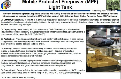

Army Wants 'Air Droppable' Light Tank & Ultra-Light Vehicles

But if the Army goes to design a new air-dropped light tank, they'll follow TomS suggestion: Armored for modern combat and protection against IEDs.
That will be awfully tough to get under 20 tons...
More precisely: an air dropped light tank has serious constraints. There aren't a ton of good options in feasible engineer space for a 'good' tank.

Design a new one?
I don't see how there is much room for improvement over a modernized M8 AGS derivative.
Save the extra belly armor and anti-IED kit for once the thing actually gets to the ground, else I don't see how they'll possibly be able to air-drop it.

I was thinking something more along the lines of the Panhard VBL:
The CVR(T) Striker:
Both small, agile and easily concealable. Strykers are big and carry too many men.

bobbymike said:
From the article posted above : "That means a tracked vehicle with a manned turret, rather than a wheeled vehicle with turret remotely controlled from inside the hull, as on the much-criticized Stryker Mobile Gun System (MGS)."
Leaving aside the wheel vs track debate, what's the main source of dissatisfaction with the Stryker MGS : the Low Profile Turret or the entire vehicle ?
Assuming the main issue to be with the LPT, why not replace it with the Cockerill CT-CV 105HP turret by CMI Defense ?
The CT-CV was successfully tested on a Piranha 3 chassis on September 13, 2005 at the Lulworth Camp firing range and was (at the time) offered with a 12-round autoloader in C130 air-transportable configuration.
The CT-CV seems to offer some interesting features, such as :
* High QE (up tp 42°) allows BLOS firing (up to 10 km range) and might offer a useful advantage in urban or mountainous environments.
* The Cockerill CV gun itself seems to offer adequate firepower (design pressure = 120% of 105mm L7/M68) : with a muzzle velocity of 1,620 m/s, the M1060CV APFSDS developed by MECAR is said to offer a penetration path of 560mm @ 2,000 meters (R50) and GLATGM solutions (LAHAT, Falarick 105) might do the job against the hardest targets.
In theory, NIH shouldn't be an issue since "[the Mobile Protected Firepower vehicle] AOA will see whether a new design is necessary or whether something already in production — in Europe, for example — might fit the bill."
