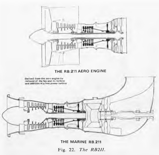

What about a Marine RB.211?
The same document also mentions the possibility of a Marine Rolls-Royce/SNECMA M45H.
