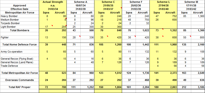

Comparison of RAF Expansion Schemes A, C, F, L and M
Explanatory Notes:
  • There were several changes of designation between 1934 and 1938. For example:
    • At 31st March 1934:
      • Heavy Bombers were Night Bombers.
      • Medium and Light Bombers were Day Bombers.
      • General Reconnaissance aircraft were Coastal Reconnaissance aircraft.
    • According to some of my sources the 4 General Reconnaissance (Land Plane) squadrons in Scheme A were designated General Purpose squadrons. Furthermore, some of the sources include them in the Home Defence Force, which increased the size of the Home Defence Force in Scheme A to 884 aircraft in 75 squadrons.
    • The Torpedo Bomber squadrons were part of the Home Defence Force in Schemes A, C and F. There weren't any in Schemes L and M because they were renamed Torpedo Bomber General Reconnaissance squadrons (T.B.G.R.) and are included in the total of General Reconnaissance (Land Plane) squadrons which also became T.B.G.R. squadrons.
  • Re the Bomber Force at 31st March 1934.
    • The Medium Bomber unit was No. 101 Squadron which had 8 Boulton Paul Sidestrands in 2 flights of 4 aircraft.
    • The Light Bombers at 31st March 1934 don't include 2 squadrons (Nos. 15 and 22) that were incorporated in one of the experimental establishments (the A&AEE).
  • At 31st March 1934 the plan was to create a Home Defence Force of 594 aircraft in 52 squadrons by 31st March 1938 which would consist of:
    • 390 bombers in 35 squadrons consisting of:
      • 150 night bombers in 15 squadrons.
      • 240 day bombers in 20 squadrons.
    • 204 fighters in 17 squadrons.
  • The fighter force in the Metropolitan Air Force included a number of squadrons that were assigned to the Expeditionary Force. That is:
    • 3 squadrons (36 aircraft) Scheme A.
    • 10 squadrons (120 aircraft) Scheme C.
    • 9 squadrons (126 aircraft) Scheme F.
    • 10 squadrons (160 aircraft) Scheme L.
    • 4 squadrons (64 aircraft) Scheme M.
  • Scheme C's completion date of 31st March 1937 only applies to the Metropolitan Air Force. The completion date for the Overseas Commands was 31st March 1939.
  • The number of squadrons and aircraft in the Overseas Commands in Scheme F doesn't match the table in Post 28. That's because they came from different sources.
