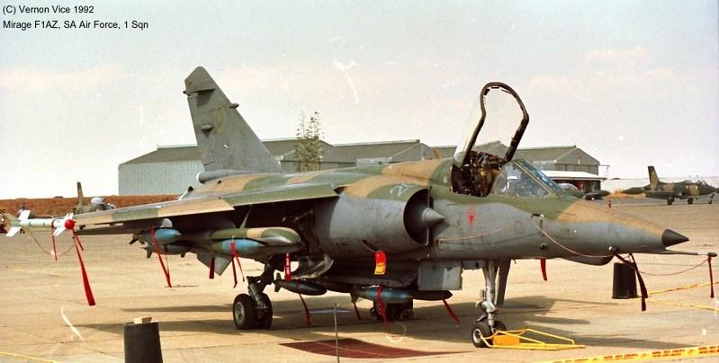

"The SAAF proceeded to procure 16 Mirage F1CZs and 32 Mirage F1AZs, which were quickly delivered by Dassault prior to the embargo being implemented, the first of these deliveries occurring in 1975".
As far i understand, the only F-1 with AAR, was the F-1A
"Mirage F1A
Single-seat ground-attack fighter aircraft, with limited daylight-only air-to-air capability. Fitted with lightweight EMD AIDA 2 ranging radar instead of Cyrano IV of other variants, with laser rangefinder under nose, retractible refuelling probe and more fuel."
  • Mirage F1AD : Mirage F1A for Libya. 16 delivered 1978–1979.
  • Mirage F1AZ : F1A for South Africa. 32 delivered 1975–1976

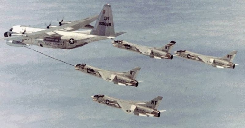

But in that case, we need B707 tanker.
The Kc-130 refuel it

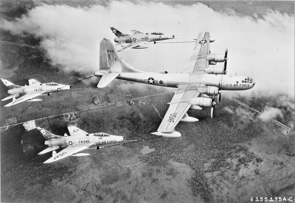

The F-100D refuel from KC-97, so I think the can do from a C-130. The same was from the F-8.

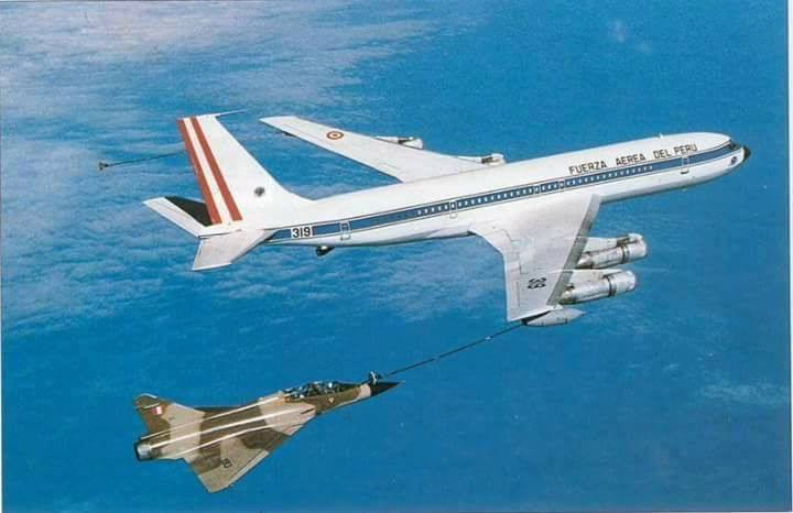

Peru refuels his Mirage 5P and 2000 with a B707

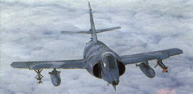

Why didn't the single-seater Jaguars have a refuelling probe similar to the two-seater ?
Edited : Probably because of the instruments in the nose.

French Jaguars had much less avionics than the British ones, and the two-seat variant had even less, that is... almost none. So yes, there was room in the nose for a refueling probe.

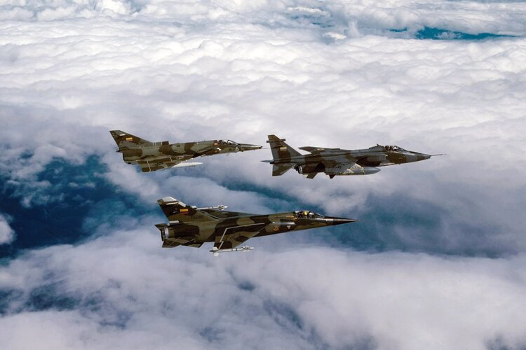

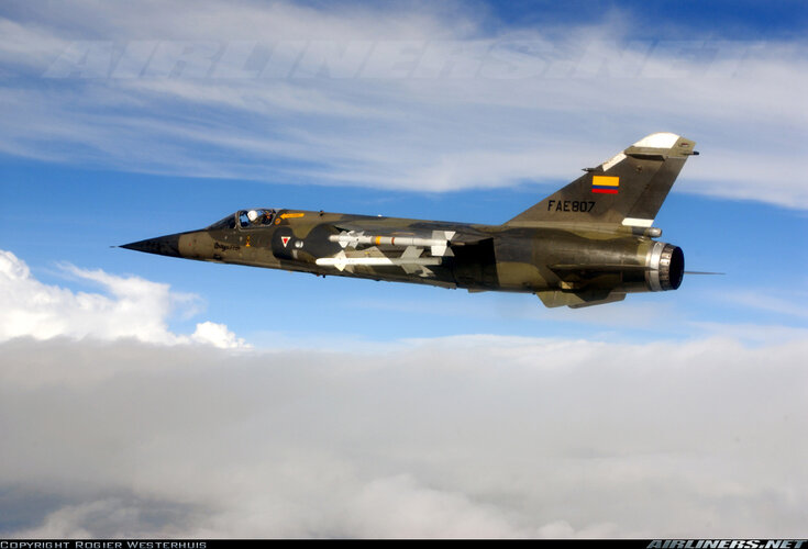

Ecuador got Mirage F1, Jaguar Kfir, Strikemaster, Cheetah, A-37B, modernised Kfir etc, etc...
Ecuadoran Mirage F1JA, Kfir & Jaguar during Exercise BLUE HORIZON (1986).jpg Ecuadoran Mirage F1JA, Kfir CE & Cheetah C at Taura AB (10 February 2015).jpg
Ecuadoran Mirage F1JA (FAE-807) inflight over his land (11 December 2006).jpg

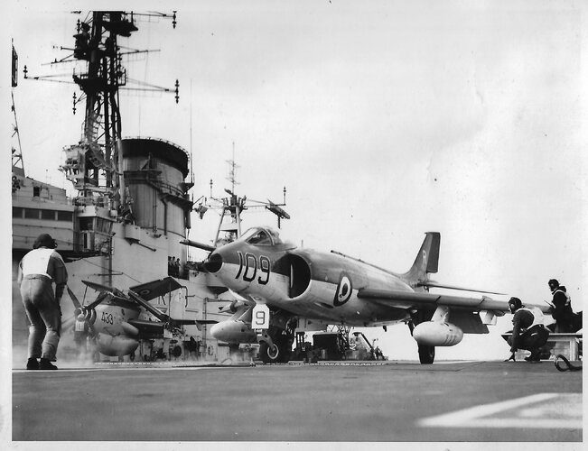

What about Scimitars bought in the 60s/70s ? To operate on the 25 de Mayo ?
In the role of fighter and ground attack ?
I don't think they would have fit in the elevator. It had a size of 13.7 x 10.4 mts, the Super Etendard fit barely. In the late 60s, the Navy wanted to buy A-1s and Etendard IVs from the French to replace the Corsairs and F9F Panthers, but they refused and instead offered T-28s

Scimitar was a bastard to fly, and not sure it fits on Colossus / Majestic carriers... it was big and heavy.
The Scimitars wings could be folded in all angles (nose, wings) to fit into the elevators.
That's interesting, I didn't know that. Well, maybe it could have fit in the elevators, but I don't know if the catapult would have been powerful enough. Either way, I don't think the Navy ever considered any British carrier-based aircraft (save for the SH in the 70s), but I may be mistaken.

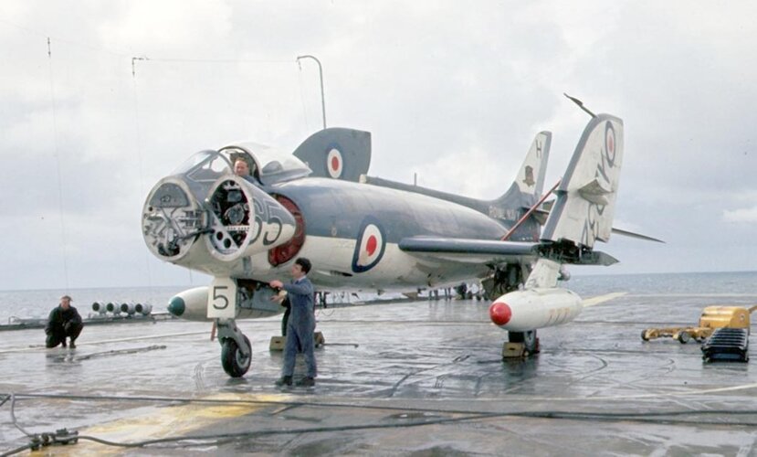

Exactly

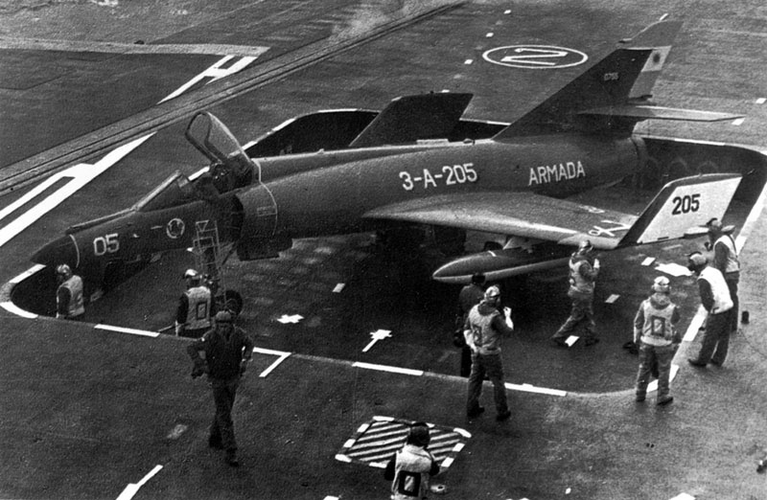

A SUE on the foward lift on the ARa 25 de Mayo

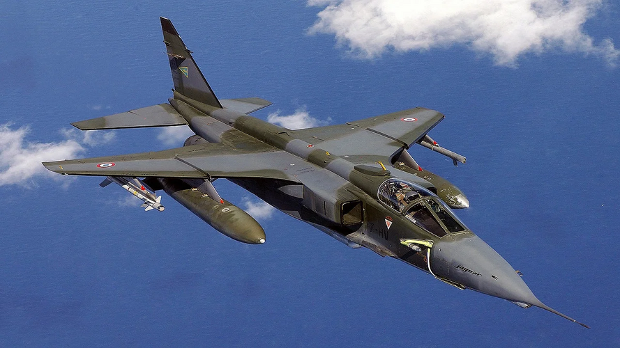

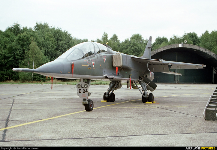

Thiis a Jaguar A from the armee del air
foldin IFR

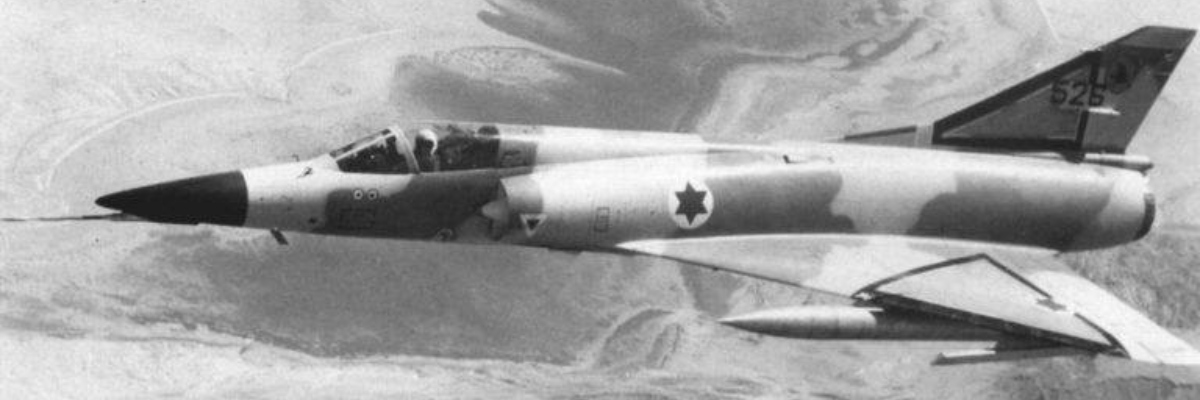

The Dagger was the IAI Nesher.
We never bought Mirage from Israel, I said Mirage, not copy of Miarge V
"Wiki: Israel Aircraft Industries Nesher was the Israeli version of the French Dassault Mirage 5 multirole fighte"
We bought 10 Mirage -5P from Perú
The arrive on the moorning of June 5 of 1982, but we never use in the war.

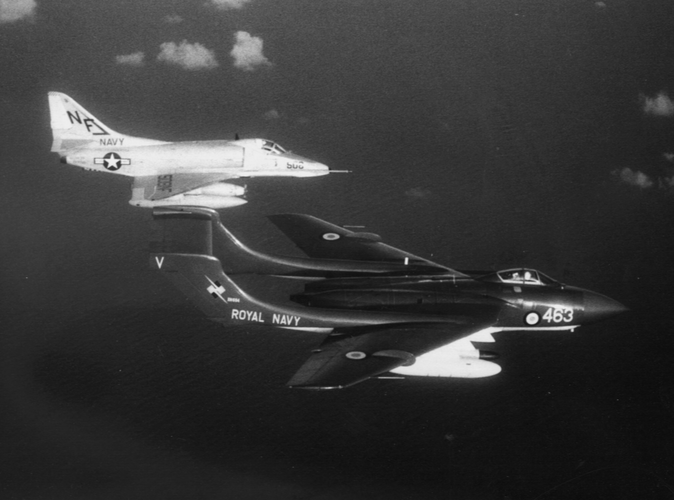

Ita said:In 1968 the naval aviation study the possibility of the Sea Visxen FAW.1 and the Harrier Gr.1. the in May 1970 we recive the ofer of 16 A-4B call "Q" by the Navy.
Looking this photo
I think the info was a political move to exercise presion, because I dont know if that bird can fix on the CV lift

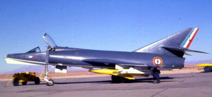

I don think that the Etendart, could reach the Islands with the AS-30
The missile use the inner pylon, so 1 missile an 1 drop tank, max.
for fighter in Puerto Argetino/ Port stanley, yes
This is a IVP, but thay have the same configuration
We never bought Mirage from Israel, I said Mirage, not copy of Mirage V
"Wiki: Israel Aircraft Industries Nesher was the Israeli version of the French Dassault Mirage 5 multirole fighter.
Dagger is effectively the export name for the Nesher. So, in fact, the Argentinians didn't get any "Mirage" from Israel.
But the Nesher is not a copy of the Mirage 5J; they were secretly produced in France and Belgium and delivered to Israel.
Actually…. in January 1968, Rockwell International made a deal with Dassault for another batch of Mirage 5Js to be delivered to Israel. To better cover-up the story, fuselages were made by Aerospatiale, wings by Reims-Cessna, while engines were manufactured by SABCA, a Belgian subsidiary of Dassault.
