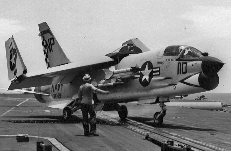

Much rarer, but more potent as an fighter than a Skyhawk, is the Grumman F11 Tiger. It’s weights were broadly comparable to a Skyhawk so it just might have been compatible with operating from a modified Majestic class. With only 200 made (compared to c2500 A4’s) and the USN using them quite hard in both marine and land environments I don’t think any were still flying in 82. Now upgraded to a Super Tiger it would have been even more challenging.
It would be possible that the Argentine Navy bought second-hand Tiger from the US Navy in the mid/late 60s and used them until the 1980s/90s. Modified with more advanced Sidewinder, this could be an interesting alternative to the Skyhawk for fighter duty.

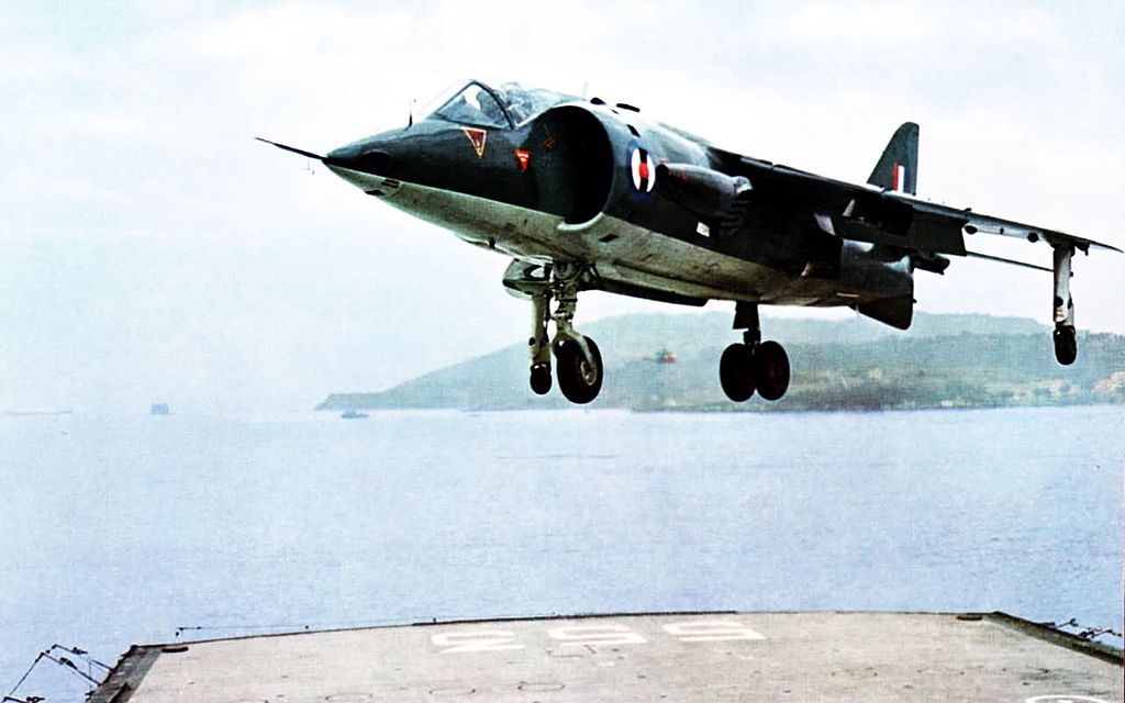

The Argentinians had considered acquiring Harriers after a demonstration on ARA 25 de Mayo, but this did not happen for financial reasons.
Having looked at a list of all the carrier-born jets, the possibilities for the 25 de Mayo in the late 70s are very limited.
Modernised F11F or A-4 may be the best solution.
There are very few fighters capable of guaranteeing effective BARCAPs to protect the 25 de Mayo against British attack.

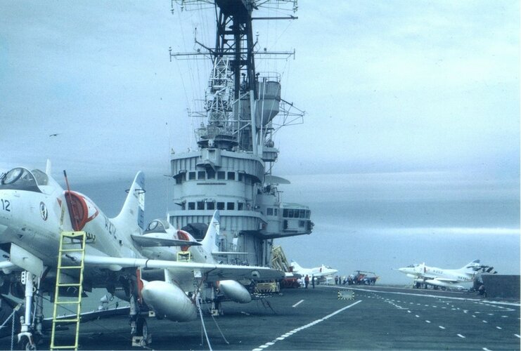

The aair group of the ARA 25 de mayo in the waer consist on 8/6 A-4Q 4/6 S-2E ans 4/3 Sea King and 1/2 Alouette
I dont know if the F-11f fix inthe the lift of the CV, but looking the small air group, the A-4 is the best opition.
Perhaps a better A-4.

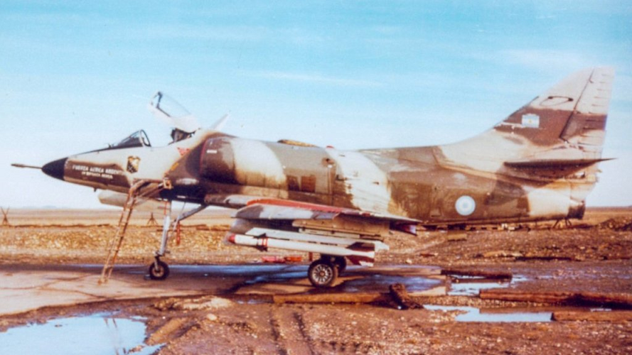

Inted of the A-4Q (ex B)
You can see, int his photo the limitacion of the A-4Q (ex B)
Maybe the A-4C(A-4D-2N)
(Pre war)
(1978/79 local upgrade with Omega VLF / IFF and the possiblity of Shafir
This is a phot forn the war
That configuration was 2x20mm + 2 drops tank and 2 Shafir missiles.

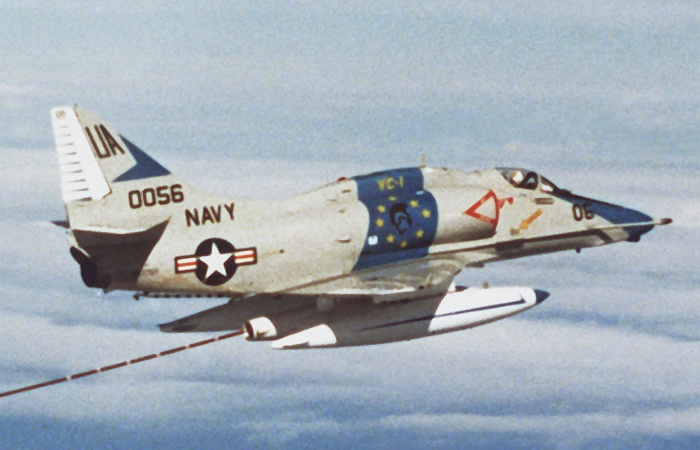

The A-4F with AS-30 seemed to us to be the best choice for ground attack.
And something similar to A-4G for air superiority.
Operating with a good fuel margin would already make the A-4 much more efficient.

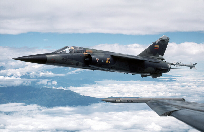

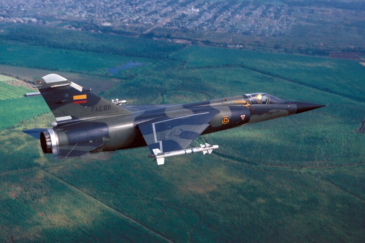

There was no need for a Mirage F1EQ or F1AZ/EZ, as the F1 was sold with an on-demand configuration.
The sole operator of F1 in Latin America was Ecuador, who use 16 F1JA from 1979/80 until 2011.
Ecuadorian Mirage F1JA flies beside another aircraft during exercise Blue Horizon 86 (9 Septem...jpg Ecuadorian Mirage F1JA (FAE-811) inflight (1986).JPEG

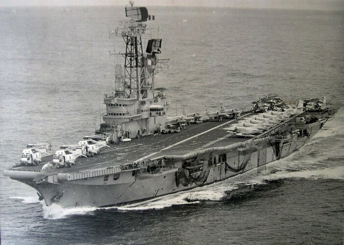

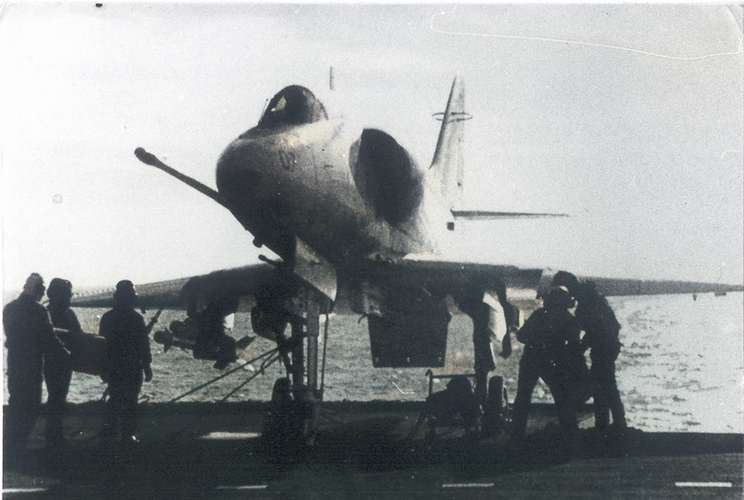

Veinticinco de Mayo could carry a dozen Skyhawks, so in wartime, perhaps it could have taken 16 ?
ARA Veinticinco de Mayo at sea.jpg Argentine Navy A-4Q on ARA Veinticinco de Mayo.jpg
A possible scenario for attack operations might look like this with Skyhawk:
4 for attack against British fleet.
4 for escort duty with air-to-air missiles.
4 in CAP for the ship's defence. (probably only 2)
4 in reserve & maintenance. (probably only 2)
edited : 12 Skyhawk is the maximum the ARA 25 can carry. (so 2 in CAP & 2 in reserve)
The main thing would have been to organise the catapults around the Trackers' anti-submarine operations.

I think the 1st photo is the max loud of the CV (12 A-4 + 3SK + 4 S2E)

He said that the attack was stern to bow (i´m talking from memory) and he saw an asimetric silouette.
No like this
He use his hand to describe

Mote apropos the topic: I love the A-4, but the A-7 is better in many ways.
