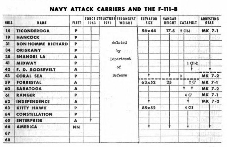

This is from Ships and Aircraft of the US Fleet 12th Edition* (1981) by Norman Polmar.
This is an extract from a document titled TFX Contract Investigation which is the minutes etc of a congressional panel meeting with Secretary of the Navy Frederick Korth (held that office 4 Jan. 1962 - 1 Nov. 1963). This is from the section titled Carrier Characteristics (these 3 pages are all I have):

Bugger, too small to take an F111B unless you got creative and hung most of the plane over the edge. Pretty sure the MLG are more than 25ft from the tip of the tail.
IIRC the Navy hates hanging planes over the side like that.
So is Midway's SCB101 the minimum required refit? Surely they could walk back on some deck space and other cats and dogs to make it somewhat less onerous therefore cheaper and less detrimental to the ship overall.
Elevators are still too small for F111Bs, you need a triangle ~72ft long and ~40ft wide to move them around.

I'm honestly not sure how much smaller the Coral Sea's flight deck was than the Midway's, the differences in overall shape are pretty subtle.
Would it be possible to make a cheaper SCB160, or is the 8 reactor design so inherently expensive that any effort to make it cheaper would be just tickling the edges?
You'd get some economies of scale, since you'd have 16+ A2W reactors plus however many C1W from the Long Beach classes to escort them.
But it's still going to be expensive, due to all the support systems each reactor needs. And all the crew 8 reactors end up needing under Rickover's crewing model.
I can't imagine there would ever be 6 x A2W (35,000hp) powered carriers, reactor technology was advancing too fast. The 4 reactor SCB203 was mooted as early as 1959, when the A3W was only making 45,000hp but by 1960 for the SCB211 it was making 50,000hp and by 1962 it was making ~65,000hp which was enough to propel an Enterprise-sized SCB250 to full speed.
At most I could imagine a 2nd SCB160, the nuclear America. The Enterprise cost $451 million whereas the Indy and America cost ~$200 million, no amount of economy of scale is going to bridge that gap, which would be why the Navy was willing to examine the tiny SCB203. Even if the Navy could build the nuclear America 10% cheaper than the Enterprise it would still cost double the conventional ship.
That's a question for @BlackBat242 , I don't have that level of information.
This site has scale drawings of the SCB 100/100A/101 and 103 deck layouts, although the Midway's SCB101 lacks detail.
The Coral Sea 110A landing on deck area is much longer than the FDRs 110, the former extending level with the bow cats and lacking the deck edge lift at it's forward end. The FDR (and presumably the Midway which had the same 110 rebuild) landing on area only extends level with the island, then has the deck edge lift at it's forward end.
The biggest difference between the Coral Sea and Midway post SCB101 is beam overall at the flight deck, the Coral Sea is ~232' while the Midway is ~260'. By the drawings it looks like the Midway's landing on deck angle was increased of Coral Sea and FDR. I suspect that this increase in deck area over the Coral Sea is the bridge too far that ruined Midway.
