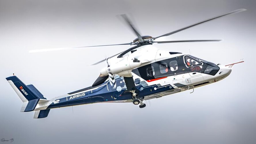

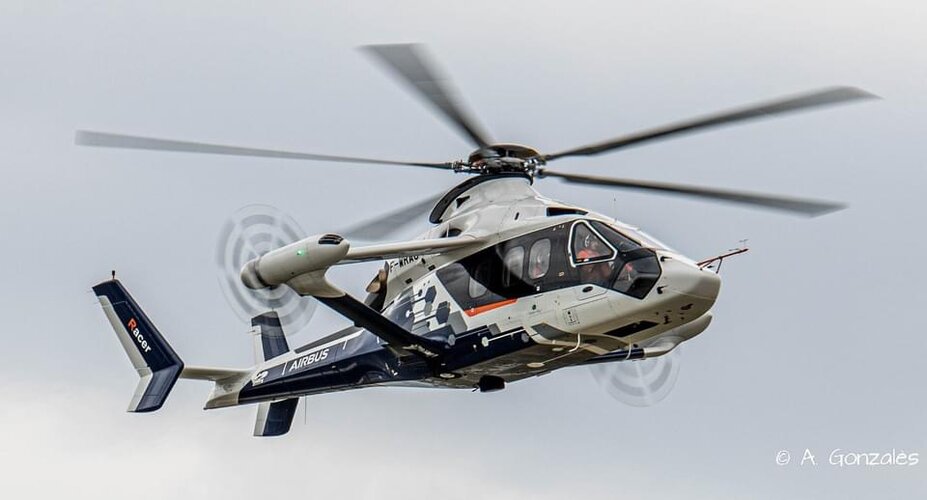

Roll stability is awkwardly low. And it doesn´t seem wind is at play here. The controls in roll seem to be a bit touchy.
Regarding the extra test crew members, they are probably doing so according to their own procedures, with an in-flight check of parameters and monitoring recording installations as well as guiding the pilots through the test scenario.
Here is an example with the A350:
Roll stability is awkwardly low. And it doesn´t seem wind is at pay here. The control in roll seems to be a bit touchy.
That may be flight control laws that need adjustments. Remember the Raider oops, where the roll oscillations got bad enough to make the blades cross? Happened because of how the bird transitioned from "on the ground" to "in the air", something went odd and made the stick have 2.5x greater effect per input during the transition.
I agree that it a control law tweak is the most likely issue. However, I did note it was not an overly calm day for that test flight. Assuming all of the video was from the same flight. Makes me think that the control laws are going to be interesting for gust response.
True that some sequences might have been during a windy day (I hadn´t noticed earlier the rough sea in the background - Mediterranean cost line - in some of the shots).
Control laws are obviously at play with a stability issue. But sometime you can´t fix all this way only without leaving your vehicle standing as a lemon.

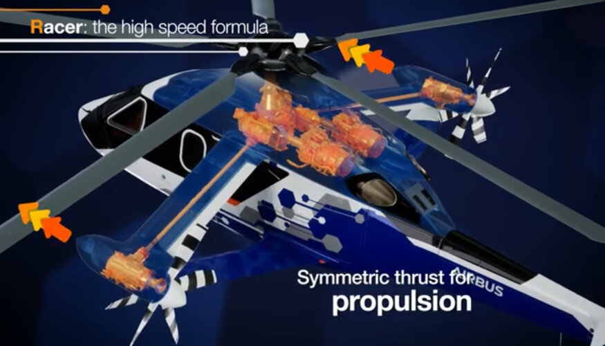

New video of the Racer… I was hoping for more in-flight shots but I guess that will have to wait. There is a nice overview of the mechanical layout though.
There have been 2 flights this week, 1:22 and 1:06 duration, according to FlightRadar. That brings total flight time in the first 3 weeks to ~4hrs in 4 flights… though there may have been more flights not recorded by spotters.
View: http://youtube.com/watch?v=yRJAQ5cCF6c

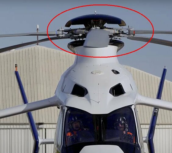

Low drag main rotor hub? Probably not yet.

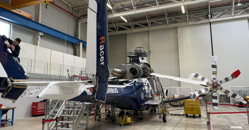

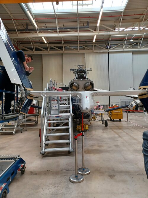

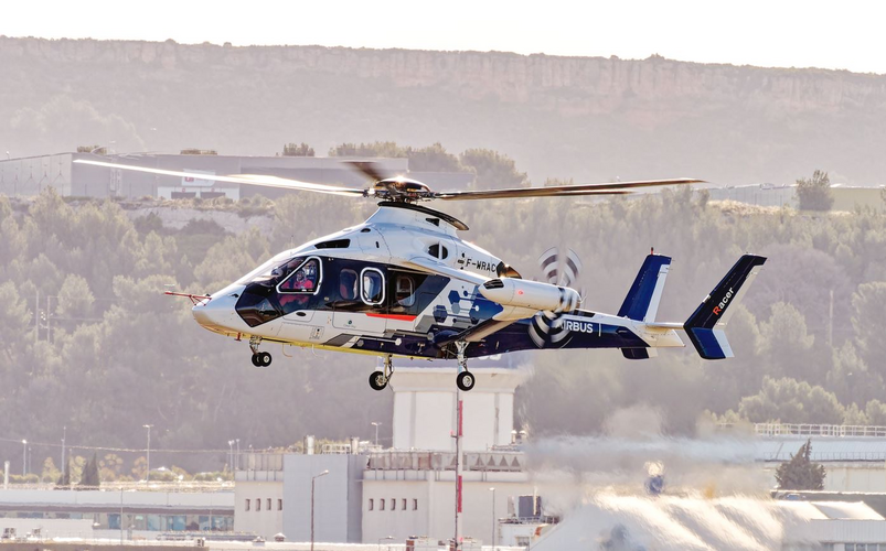

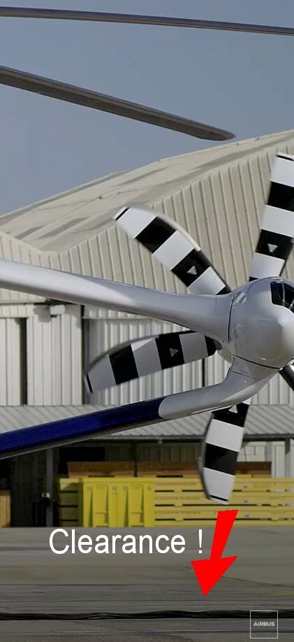

Also notice the drastic decrease in in ground effect flight safety with the anti-torque rotor being the most exposed to ground obstruction (see the risk having a slight banked attitude or landing on uneven terrain).
Apparently they are using a standard H175 rotor hub (and rotors) initially so they can generate a baseline using known components. When they are ready to start high speed flight trials they will install the new low drag hub.
Not sure if the rotors will stay the same or be changed too down the road.

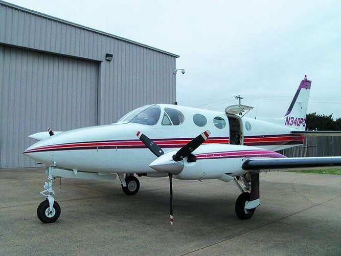

Its more ground clearance than say a Cessna 172 has though isnt it?
The wing blades dont extend below the bottom of the fuselage unlike on pretty much every single and twin engine Cessna.
Are you routinely landing your Cessna in a cluttered space with rocks, uneven slopes etc... ? And what would happen if you lose one prop? Do you think that would be the same with a single rotor helicopter? Are your Cessna props mounted at the tip of the wing?
Pretty much the same relative position as a Cessna 340 or 4xx? Think the Airbus props have a tiny bit greater ground clearance.
Theres some pretty extreme lack of clearance on some models...
If front gear touches down first and shock compresses the clearance must be mm.
...It's a demonstrator. If it's a real problem the final product might not look like this?
Or am I now being too logical here?
Well part of the demonstrator is to illustrate the configuration envisioned for the a/c. Here the props are not wing mounted somewhere along the span but at the tips. So, I think the remark is relevant.
Regarding teh Cessna, you´ll notice that the landing gear struts is more or less coplanar with the prop axis. Hence the problem of having some bank on touchdown, something that is relevant with any crosswind landing, is simply negated by the rigidity of of the strut (any aggravated roll would create impact points outside of the radius of the propeller with the present geometry).

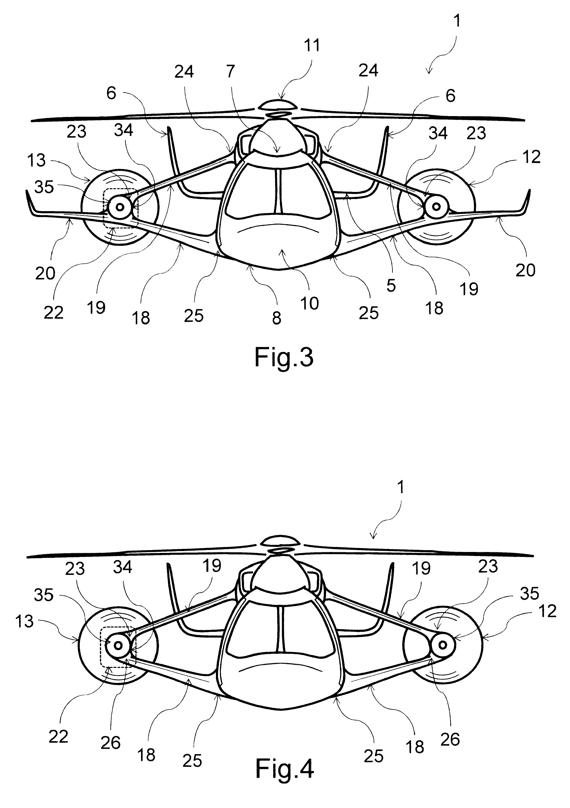

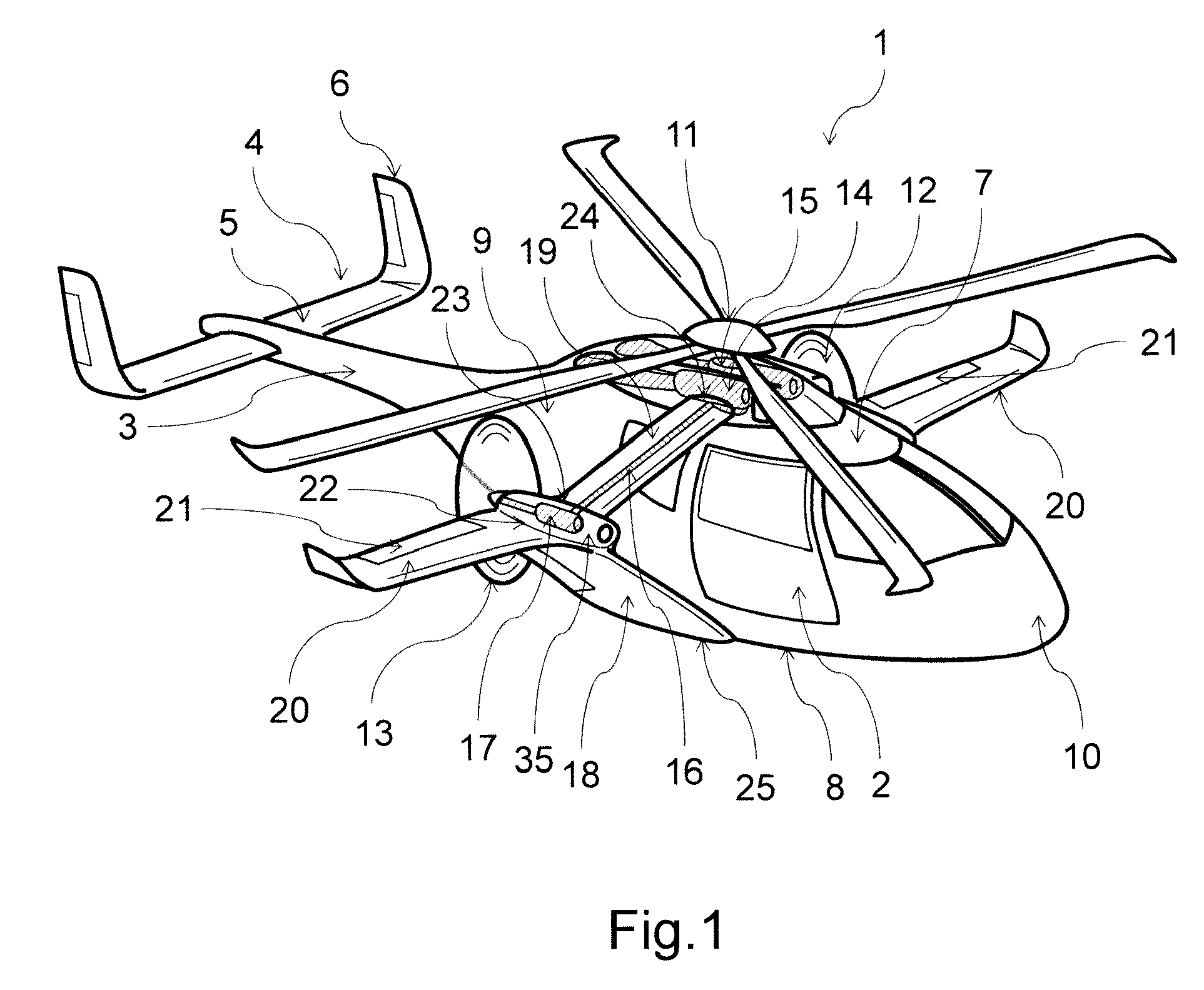

Interestingly Airbus has also patented a mid wing mounted configuration, which might allow for more ground clearance and reduce safety concerns. I guess it has some drawbacks since it wasn’t chosen.

Further improvements are likely to come with the installation of a low-drag cowling for the main rotor head and landing-gear doors.
