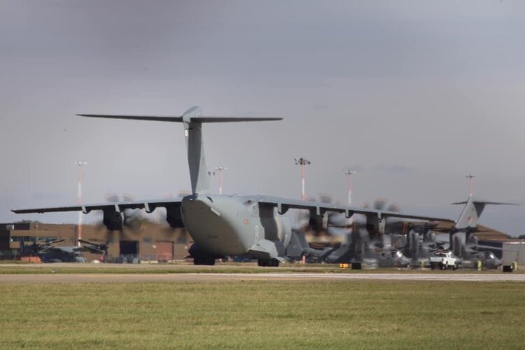

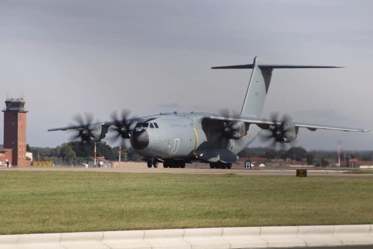

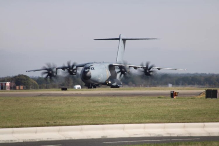

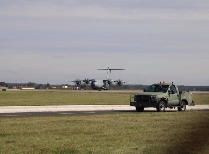

Around time of my birthday in Sept last year I popped to RAF Mildenhall so here are my photos of Ejercitio del Aire A400M laughinfly helping out Aviano based 31st FW by moving their kit from UK deployment at RAF Lakenheath back to Aviano.
cheers
