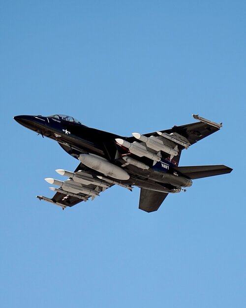

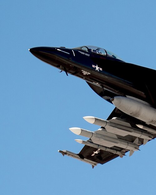

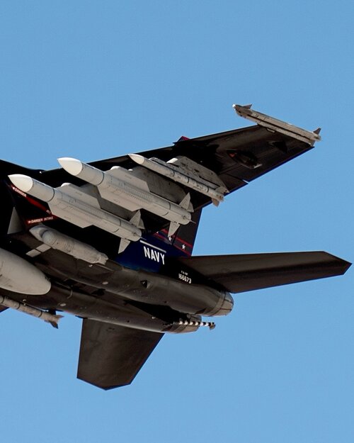

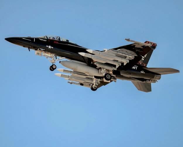

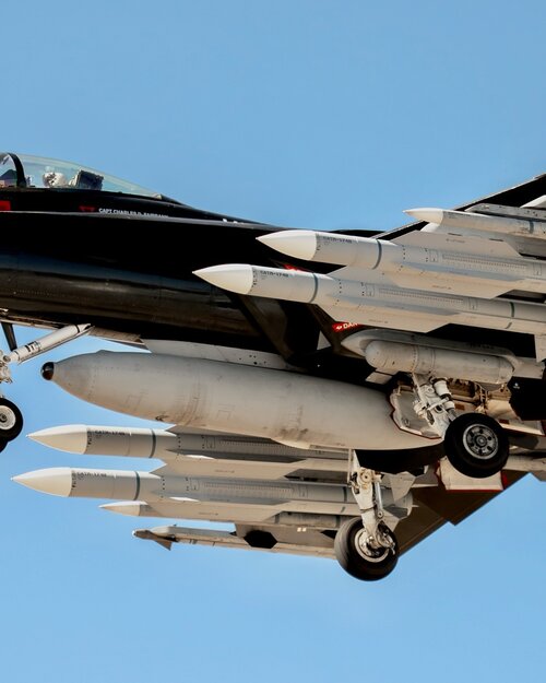

So why the lack of photos showing the launching of AIM-174s? I would love to see at least one launch photo of the AIM-174 from a Super Hornet.
Probably relatively hard to clear the live fire shots for public release. It takes time and really isn't anyone's top priority.

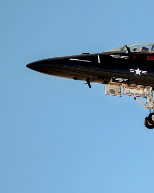

Hilarious that the crew names on the bird are for a VADM and CAPT. How often do they get to go flying, really?
