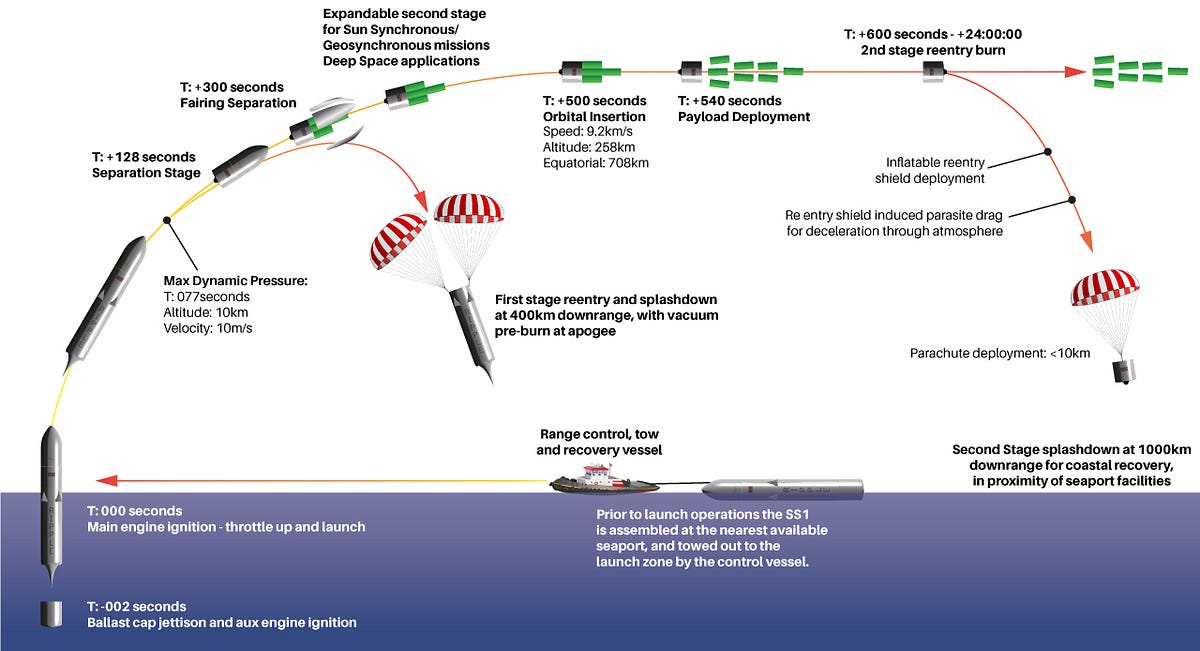

At any rate, this and Interorbital are about all that is left of the Sea Dragon concept.

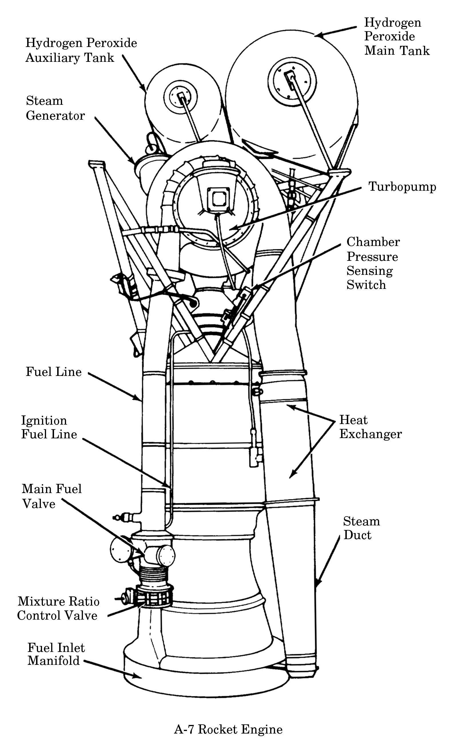

The problem with pressure driven fuel systems for rockets is that you can't easily regulate the pressure and flow on them, particularly as they get larger. What happens is you have to add some complexity to the tanks in the form of bladders to try and keep the pressure on the fuel constant. You also have to increase the wall thickness of tanks to deal with the pressure.
As the fuel depletes and the gas is used up, the pressure pushing the fuel falls and with it the engine thrust as less fuel is pushed into it.
This is why everybody went to turbopumps to pull the fuel at a constant rate into the engine. It also decreases the chances that the pressure on the two tanks won't be equal and the rate of injection varying from the calculated balance. When this happens with pressurized systems you increase the chances of things like the engine not igniting, an explosion from a fuel imbalance, etc.
Turbopumps also added to thrust slightly as their exhaust was directed to a nozzle beside the main one.
While that is an early engine used on Redstone, it clearly shows the steam exhaust for the HTP run turbopumps. This also allows the fuel and pump exhaust to be used for cooling the nozzle, something you really can't do using simple pressurization systems.
Eh, not really. Interorbital has changed so much "planning" and has of yet to actually build and launch anything with any kind of success so they are highly unlikely to get anywhere. (Mind you I liked the initial concepts but they never had a good plan to move forward with that design and then kept switching things looking for more funding.... Helps if you have a design and stick with it)
