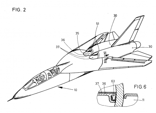

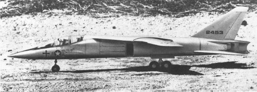

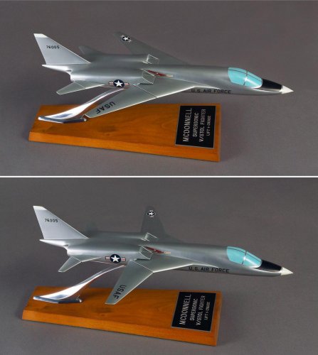

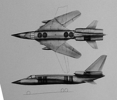

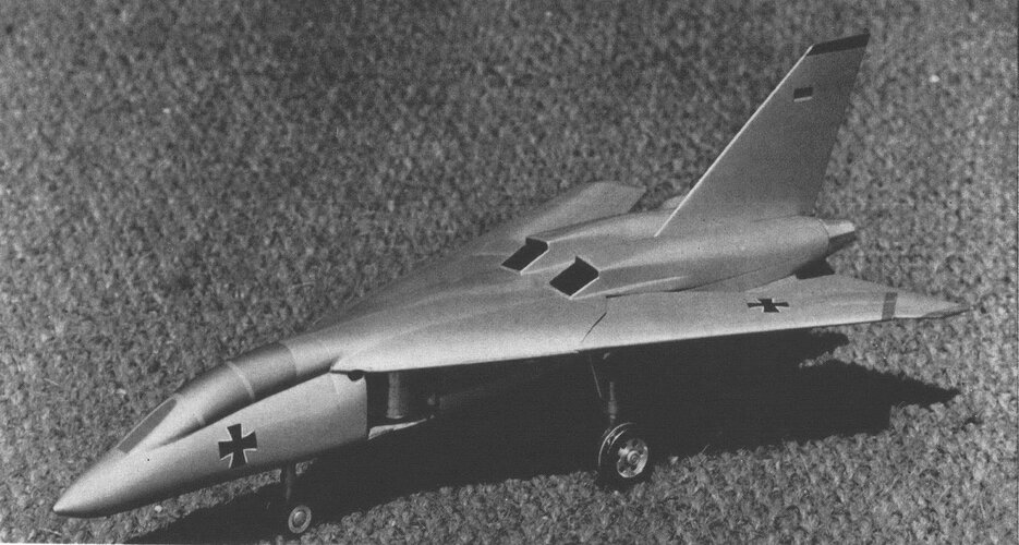

A better view of the "other" McDonnell Model 193 variant, with top air intakes. This would presumably minimize engine FOD stirred-up by the triple lift-fan arrangement. Note: Model 193 is just a guess. McDonnell archive explorers please correct me.
Detail: the VG stabilizer glove is part of the elevator. It pivots together with the horizontal stab and the entire VG pivot mechanism is therefore contained within the glove. Neat-O.

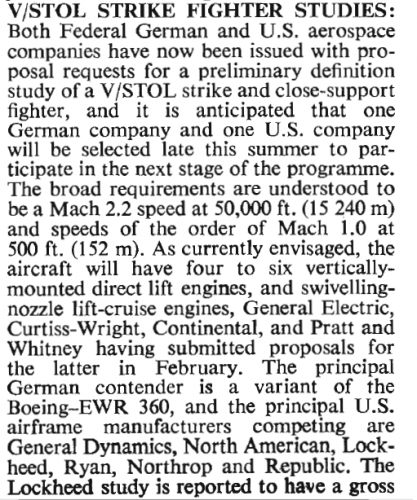

In Flying Review 6/1965,
here is a contest for V/STOL strike and close-support fighter,and a small info about Lockheed and North American proposals,I hope to know all tenders in this competition;
Boeing-EWR Type-360
General Dynamics ?
North American NA-? or D-?
Lockheed CL-?
Northrop N-?
Ryan M-?
Repulic A-400

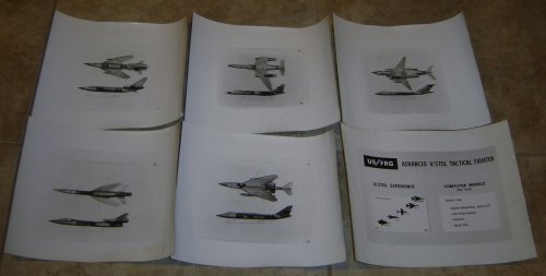

This was initially listed in error at $9.99 but my bid came slightly too late as the auction was ended.
Today is my lucky,
great find my dear Paul.
$9.99 was a bargain. $99.99 is unfortunately not.
Actually, it would seem that $99.99 would be a bargain if you are in the UK. Because once you bought it for $99.99, you'd also have to pay $16.81 shipping to the UK plus an additional $25.52 in "import charges."
Worse, you'd have to pay it using that phoney-baloney Monopoly money "pound notes" since you'd be, y'know, in Britain and all.

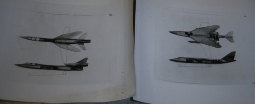

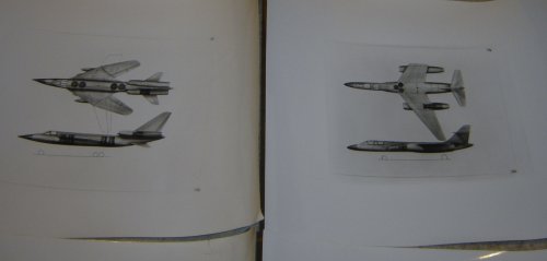

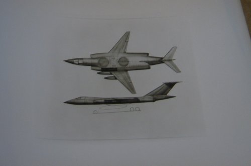

For what they're worth, here are some results of efforts to geometrically "correct" the photos. I make no promises to have gotten them entirely right. Safe bet that there is some horizontal compression or expansion.

Orionblamblam said:
For what they're worth, here are some results of efforts to geometrically "correct" the photos. ...
Thanks for your efforts indeed ! Had started my own attempts, but you beat me and quite probably
your results are better, than mine would have been. Did you try to check the wheels and/or annular
(hopefully so !) intakes of the lift engines against a precise circle ?
No. I used the barely-visible edges of the individual sheets, corrected for perspective and then tried to warp the image until the top and bottom edges were kinda-sorta straight. Not a chance that it really nailed the true shapes, but it's better than the curled-up photos.
Boeing-EWR Type-360
General Dynamics ?
Lockheed CL-?
Northrop N-?
Ryan M-?
Repulic A-400
for Ryan,I think it was M-182.

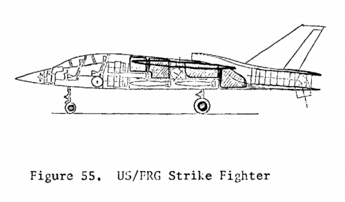

This remains my favourite 60s drawing board strike aircraft project
early-avs-jpg.112855
I first saw this drawing in a magazine I found in 1971 and have been hooked on this plane ever since. The idea of a strike fighter for the US and German Air Forces able to leap up from its airbase as in the drawing was so of its time. Of course it was completely mad and reality intervened. But whenever I see picture of the Republic F105 Thunderchief in 60s metal or Vietnam colours I imagine this AVS as the F15 Thunderstrike. Happy days!

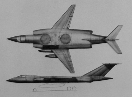

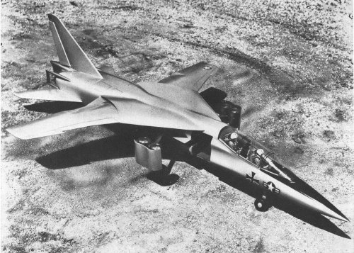

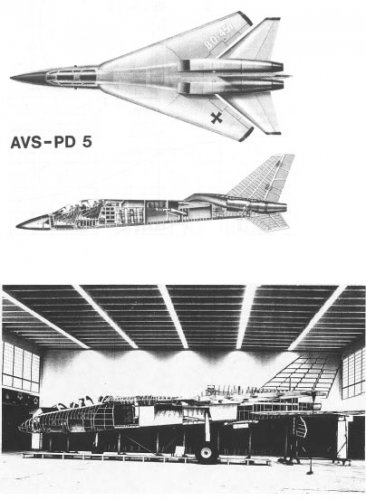

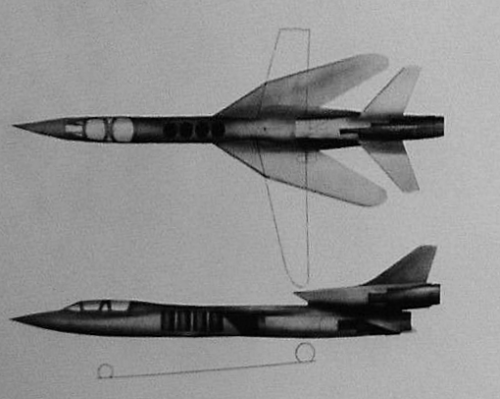

Two view with mockup of AVS.

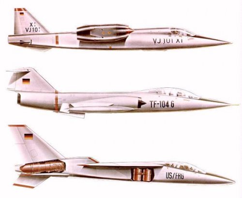

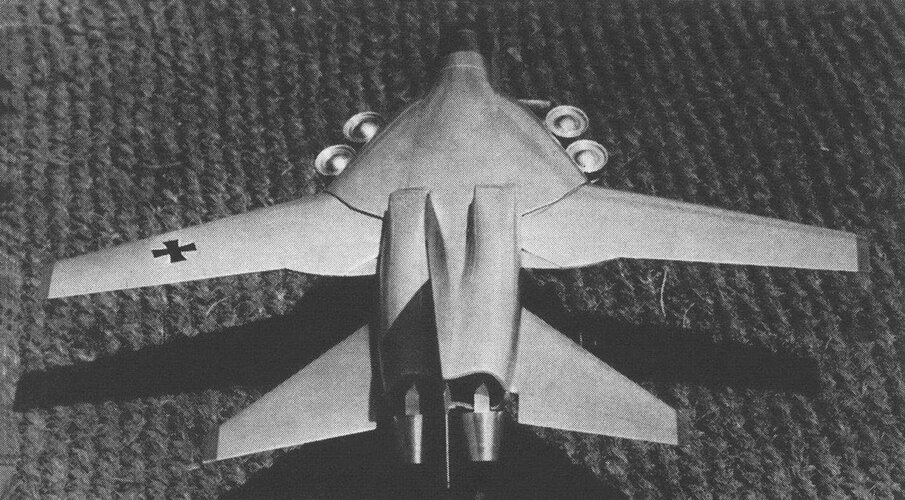

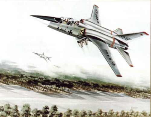

Artist drawings.

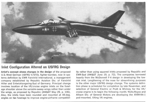

Aviation Week 19 June 1967

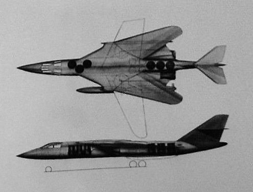

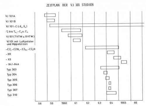

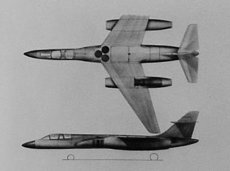

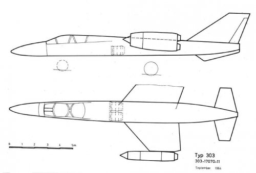

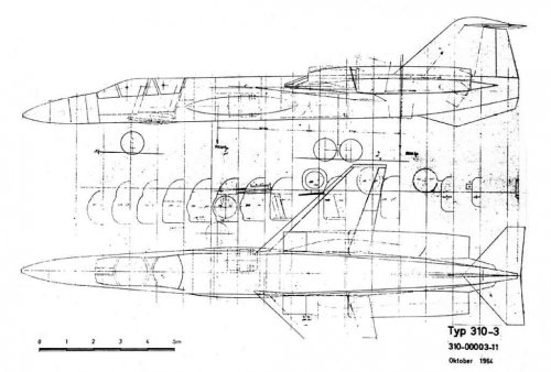

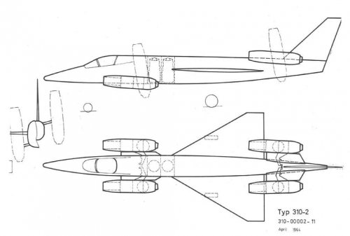

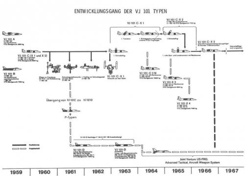

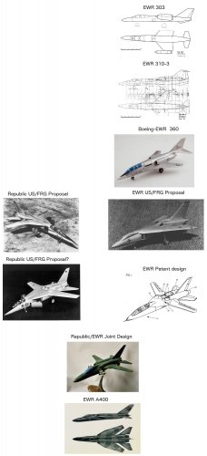

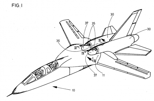

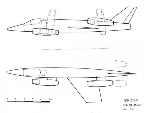

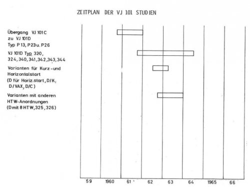

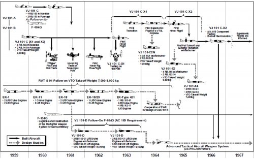

So, no Boeing-EWR 360 drawing still. However, there are some nice drawings of various EWR VJ-101 studies more-or-less forming the pre-history of this design and the relation of the US/FRG to VJ-101.
Source: http://www.klassiker-der-luftfahrt.de/geschichte/flugzeuge/ewr-vj-101-alle-varianten-teil-1/523608
The not-seen 'VJ-101E' seems likely to be the same design as the Boeing-EWR 360. '360' is clearly the EWR type number. Its possible the A400 falls into this sequence too.
Proceeding to the Republic/EWR design, the information presented in Aviation Week says that 4 US companies presented studies for US_FRG along with EWR, and Republic's design was selected partly for its similarity to the EWR proposal, differing mainly in engine intake location with the EWR design using dorsal intakes and the Republic design using intakes on the fuselage sides. It also shows photos of the side intake version captioned specifically as "Republic" not Republic/EWR while the separate dorsal intakes version is captioned specifically as EWR.
I believe based on AWST information that the dorsal intake design with separate intakes is the EWR proposal and the side intake design the Republic proposal, leading to the later joint A400 design. The single dorsal intake design has been stated as an earlier revision to the separate intakes one, so perhaps thats an earlier EWR design?
Thoughts?
So - 4 US contenders were selected from 9 bids for US/FRG in August 1965 as follows:
  • Boeing
  • McDonnell
  • Lockheed & Bell (team)
  • Republic
2 German bids were selected from
  • VFW
  • EWR
By September 1966, EWR had won the German competition.
By December 1966, Republic had won the US competition.
Source: Aviation Week & Space Technology August 23 1965, September 6 1965, September 12 1966, December 5 1966
Initial Boeing/EWR 360 (VJ-101E) studies date back to 1964, before the US/German Summit where the US/FRG idea was hatched (by politicians).
What were EK-1,EK-11,EK-18,EK-18/29 and EK-type421?

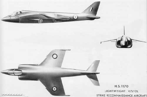

Thanks a lot. Very very complicated program. ???
Is it a VAK191A?
