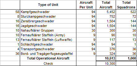

On 26 October 1938, the RLM presented it's first ideas for the Luftwaffe version of the Kreigsmarine's "Z-Plan":
45,700 aircraft were to be built by 1 April 1942 at a total cost of 60 billion reichsmarks...which not coincidentally was the entire military budget of Germany from 1933 to 1939!
The Luftwaffe by Spring 1942 was to have 10,300 operational aircraft and 8,200 in reserve.
By 7 November 1938, there were further details on the 1942 Luftwaffe OBAT:
16 x Fighter Geschwaders (Bf-109)
16 x Zerstorer Geschwaders (50% Bf-110 and 50% Me-210)
8 x Stuka Geschwaders (converting from Ju-87 to Me 210 as it became available)
4 x Heavy Bomber Geschwaders (He-177s)
54 x Medium Bomber Geschwaders (Ju-88s)
By 15 November, the RLM had done it's computations on the number of aircraft needed:
4,331 x Bf 109
3,320 x Bf 110 and Me 210
2,002 x Ju 87
2,000 x He 111
900 x Do 17
7,327 x Ju 88
703 x He 177
The older planes (He-111 and Do-17) were intended to act as "bridges" between existing production and the long delayed Ju-88 and He-177 programs.

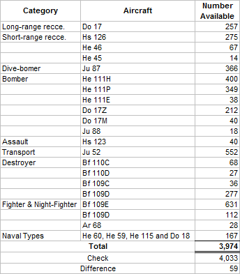

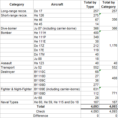

On 1 September 1939, the Luftwaffe's bomber force first line inventory was:
400 x He-111H
349 x He-111P
38 x He-111E
257 x Do-17E
212 x Do-17Z
40 x Do-17M
18 x Ju-88
Out of this, only the 749 x He-111s are capable of reaching England; and even then you might not be able to fit all of them into the Bremen-Cuxhaven area in Northern Germany due to airfield limitations. Plus, due to the increasing obsolescence of the Dornier 17 force (about half are older E models, versus the newer Z); you'll need to use your He-111s to backstop them.

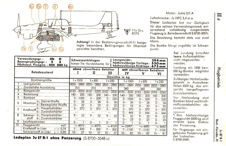

STUKA Technical Specifications and Notes:
Ju-87A Series
: 372 mile (600 km) radius with 250 kg bomb
Note: A 500 kg bomb could be carried if the rear gunner was left behind.
Ju-87B-1: 186.4 mile (300 km) radius with 500 kg bomb
Note: The huge drop in range was due to the B-1 having a 1,000+ hp engine (versus the A's 600 hp), but the fuel capacity remained the same -- 440L in two 220L wing tanks. Both crew could now be carried along with a 500 kg bomb.
Ju-87B-2: 130~ mile (209 km) radius, 370 mile (590 km) range with 500 kg bomb.
Note: Yet another engine change, to 1200+ hp. This enabled carriage of a 1,000 kg bomb if the back seater was left behind. Range dropped again since fuel capacity was still 440L.
Ju-87R-1: 300 mile (482 km) radius, 875 mile (1400 km) range with 250 kg bomb.
Ju-87R-2: 272 mile (437 km) radius, 779 mile (1250 km) range with 250 kg bomb.
Note: The R-1 Reichweiteriausführung (Long Range Version) finally got around to fixing the range issue. Two 150L fuel tanks were added to each of the outer wing panels, and the wing was plumbed for two 300L drop tanks. The R-2 version was a B-2 with only the drop tanks added, so range was less than the R-1.
Ju-87D: 217 mile (350 km) radius, 620 mile (1,000 km) range @ 12,600 lb weight. (assuming 250 kg bomb)
This drawing shows the fuel tank arrangement for the Ju-87D series
Note
: The D was a significantly revised design which began in the spring of 1940 and continued as lessons learned in operations against fortifications and warships showed that a much heavier bomb would be needed to realistically damage them; along with more defensive armament. A more powerful engine (1,400 hp) was fitted; along with slightly enlarged internal fuel tanks (780L total) and now-standard drop tanks (2 x 300L)

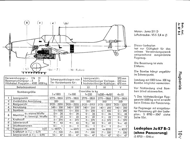

Ju-87A Series: 372 mile (600 km) radius with 250 kg bomb
Thank you for the very detailed posts.
Some remarks:
Note that range of the 87B-1 is with a 500 kg bomb, while that of the 87A is with 250 kg bomb - doubling the bomb load will have very detrimental effect on range, while the more powerful engine can be in many cases throttled back in order to use less fuel.
Is there any German-language source that stipulates the reduction of flight crew in order for bigger bomb load to be carried?
See here for Ju 87B-2: 1000 kg bomb + full ammo and crew + full internal fuel:
400 x He-111H​
349 x He-111P​
38 x He-111E​
257 x Do-17E​
212 x Do-17Z​
40 x Do-17M​
18 x Ju-88​
According to "The Birth of the Luftwaffe" by Hanfried Schliephake the Luftwaffe had 1,176 bombers at the end of August 1939 as follows:
400 He 111H - as above​
349 He 111P - as above​
38 He 111E - as above​
119 Do 17E - not 257 as above.​
212 Do 17Z - as above​
40 Do 17M - as above​
18 Ju 88 - as above​
However, it also lists 257 Do 17 long-range reconnaissance aircraft. Could that be where your figure of 257 Do 17E bombers comes from?
Edit: Were you using this?
Table 3-G Luftwaffe First Line Inventory on 31 August 1939 (4,033 including 3,646 ready)
Page 49 of "German Aircraft Industry and Production 1933-1945
by Ferenc A. Vajda & Peter Dancey
According to "The Birth of the Luftwaffe" by Hanfried Schliephake the total at 31.03.39 was 4,093 front-line aircraft available at the start of the war of which 3,646 were ready for immediate action, representing an effectiveness rate of 90%. The table on Page 54 says.
Therefore, I think there are some printing errors in Vajda & Dancey's book. That is 4,093 first-line aircraft instead of 4,033 and the 119 Do 17E bombers have been omitted entirely.
Another part of Post 136 about the Luftwaffe's "Z-Plan".
I did a reconciliation of my information from Hanfried Schliephake's book and the above which comes from Vajda & Dancey's book. This was the result.
I'm assuming:
  • 4 operational aircraft per Geschwader staff flight.
  • 3 operational aircraft per Gruppe staff flight.
  • 9 operational aircraft per Staffel.
  • All Geschwader have 3 Gruppen.
  • All Gruppen have 3 Staffeln.

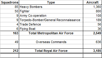

For comparison the RAF's Expansion Scheme M, which was approved by the Cabinet on 17.11.38 was to provide the RAF with a Metropolitan Air Force of 2,549 first-line aircraft in 163 squadrons plus 636 first-line aircraft in 49 squadrons overseas for a total of 3,185 first-line aircraft in 212 squadrons on 31st March 1942. See below.
The heavy bombers were to have been a mix of Halifaxes, Manchesters and Stirlings with a grand total of 3,500 to be delivered by 31.03.42. As far as I know the 800 fighters were to have been Tornados and Typhoons. The 108 army co-operation aircraft were to have been Lysanders. The 245 T.B./G.R. and T.D. aircraft were to have been a mix of Bothas and Beauforts. The flying boats were to have been a mix of Lerwicks and Sunderlands.
Furthermore, what was still the Fleet Air Arm of the Royal Air Force was to have 504 first-line aircraft in the equivalent of 42 squadrons on 31.03.42 under Expansion Scheme F of February 1936, but the Admiralty was now asking for 650 first-line aircraft in the equivalent of 54 squadrons by 31.03.42 which would have increased the first-line strength of the British air services on that date to 3,835 aircraft in the equivalent of 266 squadrons.
So the strength of the Luftwaffe in 1942 (as planned in late 1938) was about 2½ times larger than the strength for the British air services in 1942 (as planned in late 1938). Although the British planned to have reserves on a much larger scale and they also planned to have 1,360 heavy bombers in 1942 when the Germans planned to have 376.
