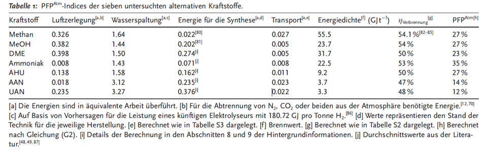

For the efficiency of the chemical process, you need to divide the last collum with the second last one (of course 55% means 0.55).
So for Ammonia you get an efficiency of 66 % and for DME only 46 %. The complets process with ammonia as fuel beeing used in a combustion engine is as effective as liquified hydrogene beeing used in a fuel cell. Ammonia is much easier to transport and store and the investment cost are way lower than in an hydrogene infrastructure.

I don’t understand the figures in your table and where the table itself comes from.

I have to agree, that my tables are not self explaining, tha last collum is giving the total efficiency from electricity to fuel to electricity by a fuel cell. The colum before is the efficiency of the fuel cell working with that specific fuel. To calculate the efficiency from electricity to fuel you have to divede the total efficiency by the fuel cell efficiency. The tables are taken from a puplication of the DLR (I'm quite shure about it) but I don't remember the original source.
Youre example of the Fisher Tropsch process ist the conversion of biomass to liquid fuel, this is not simillar to convert CO2 + H2O to Methanol or Methan or any other syn. fuel.
