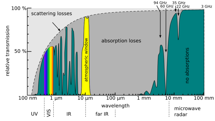

Perhaps not all but 95+% as per the graphic. 3 minutes is a significant portion of the boost phase though, which is often less than 3min for solid propellant rockets.
