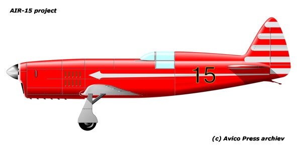

AIR-15 - (Project) 1938 low-wing monoplane racing a/c
- AIR-15: Few details; poss. heavy mod. AIR-14 variant
- AIR-15: 1 x 230 hp Bessonov MM-1 6-cyl.; span (??) m
- AIR-15: Later redesig. UT-15; F.G. Glass (Moscow) airfoil

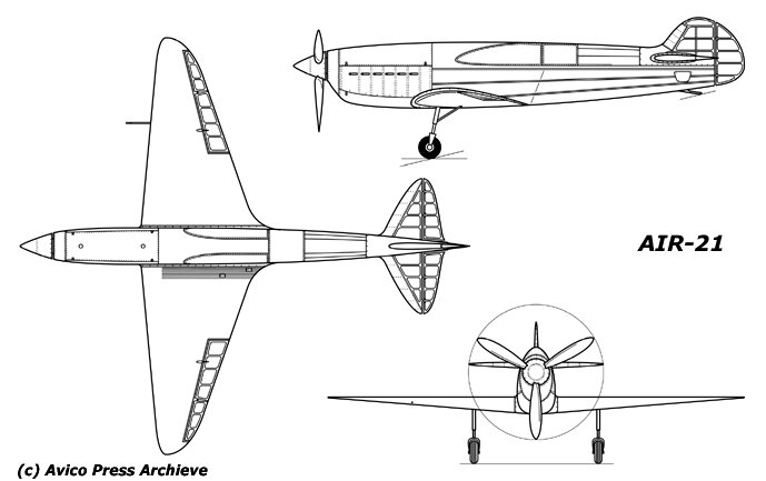

AIR-21 (I) - (Project) 'Buried' cockpit racing aircraft
- AIR-21 (I) : Single-seater; low-winged monoplane
- AIR-21G: Probable designation of this first AIR-21
-- https://www.secretprojects.co.uk/attachments/air-21-project-jpg.61078/
AIR-21 (II) - 1938 single-seat trainer; AIR-14 deriv; x 1
- AIR-21 (II): Inline-engine development of UT-1 series
- AIR-21 (II): 1 x 220 hp Renault Bengali 6 engine
- AIR-21 (II): Fixed main u/c; aka Ya-21; aka UT-21

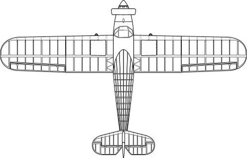

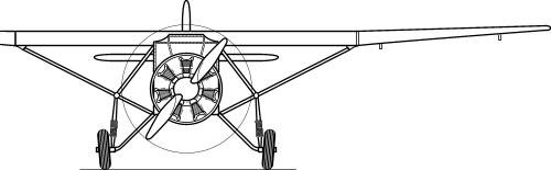

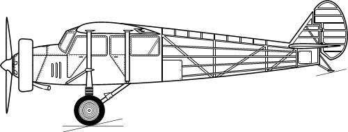

  • I also have AIR-6L / AIR-6P, the latter being close to the final VVA-5 (P-5) configuration (see pics).

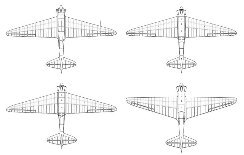

  • I have a second version of the AIR-12 with redesigned wing and variants with both cockpits completely flush with fuselage, but I don't know if these were only projected or if the prototype was actually modified (see pics).

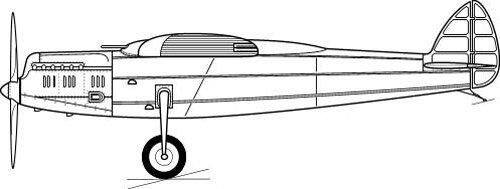

  • You describe AIR-15 as being built, but Avico Press gives it as a project (see pic).

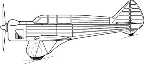

  • The racer AIR-21 was apparently designated AIR-21G.

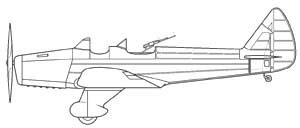

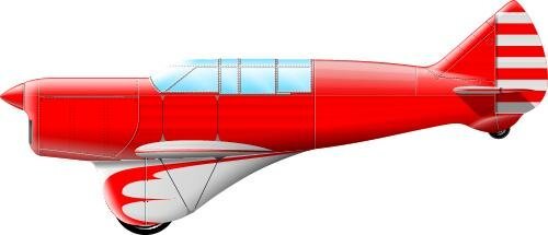

  • I have a UT-23 tandem cockpit fighter with machine gun at the rear (see pic).

AIR-6L & AIR-6P: These two sub-types were obviously from that unbuild first AIR-6 series. I'm wondering if 'P' was first applied to a proposed passenger version of what I'm calling 'AIR-6 (I)' whereas, as you say, 'P-5' actually applies to the built VVA-5/'AIR-6 (II)'? And, following from that ... then what does the 'L' suffix in AIR-6L refer to?

UT-23: Thanks, I was confused by this armed Ya-20 derivative. I was going to list it as 'Ya-23 (I)' but have decided to omit my rather dodgy 'Ya' listings for now.
