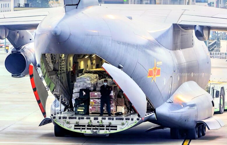

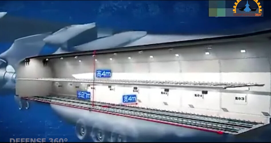

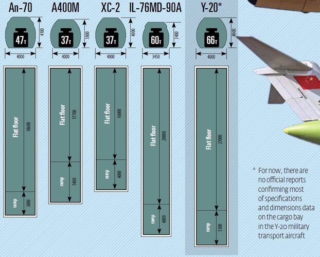

Any information about the cargo size Y-20 can fit in?
There are various images around which help sizing the cargo bay. length is fairly easy to estimate, but cargo floor width is harder. Though this image T7.jpg
suggests it could/should be around 4.2 meters wide, judging by the width of the ramp. Ramp edges themselves are 4.5 m.
When I use ramp to landing gear position ratio, and then size up the landing gear position to a measurable value like wingspan (as measured via google earth) then I get even more, closer to 4.7 m. But as one can imagine, doing measurements that way is bound to involve some inaccuracies.
I googled average pallet width in china and got 1200mm. Measuring to that i got 4.5 meters.
For the 4.5 meters to be possible, the guy in the picture would have to be 1.78 tall, which is also fairly believable. (2021 report said that 19 year old male average height was 176 cm) Once again, that's ramp edges.
All that taking into consideration, the part of the ramp that actually seems to be useable width is some 93.5% of the total ramp width, getting me from 4.5 meters to 4.21 meters.

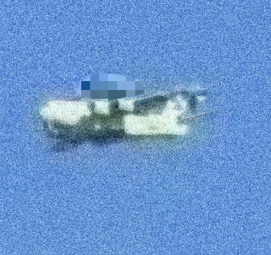

Judging by that last image, the radome diameter might be 11.9 meters. For comparison, E-3's is 9.1 meters in diameter.
Isn't it 11.5m on the A-50EI (the radar system on which may have formed the template for Chinese efforts, after all)? Seems plausible.
The fact that the rotodome was not blurred, but the body of the plane was, might imply that the body houses some additional conformal arrays.
exactly my theory too ... it looks like a bulge and not just like fins:
